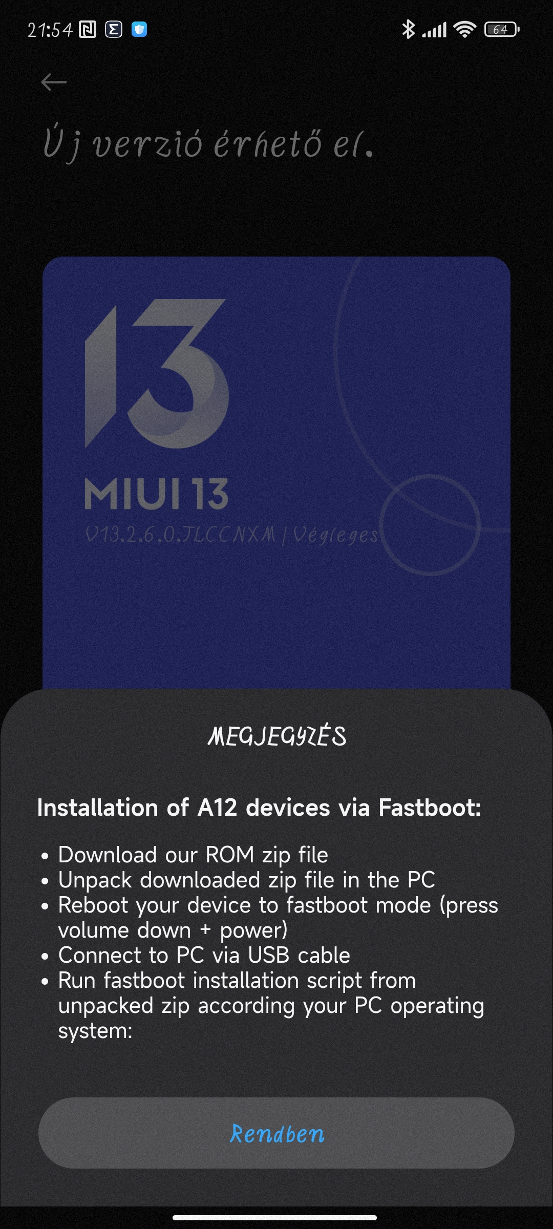

Hello, why does it throw this up when I want to update the phone? The phone has TWRP.

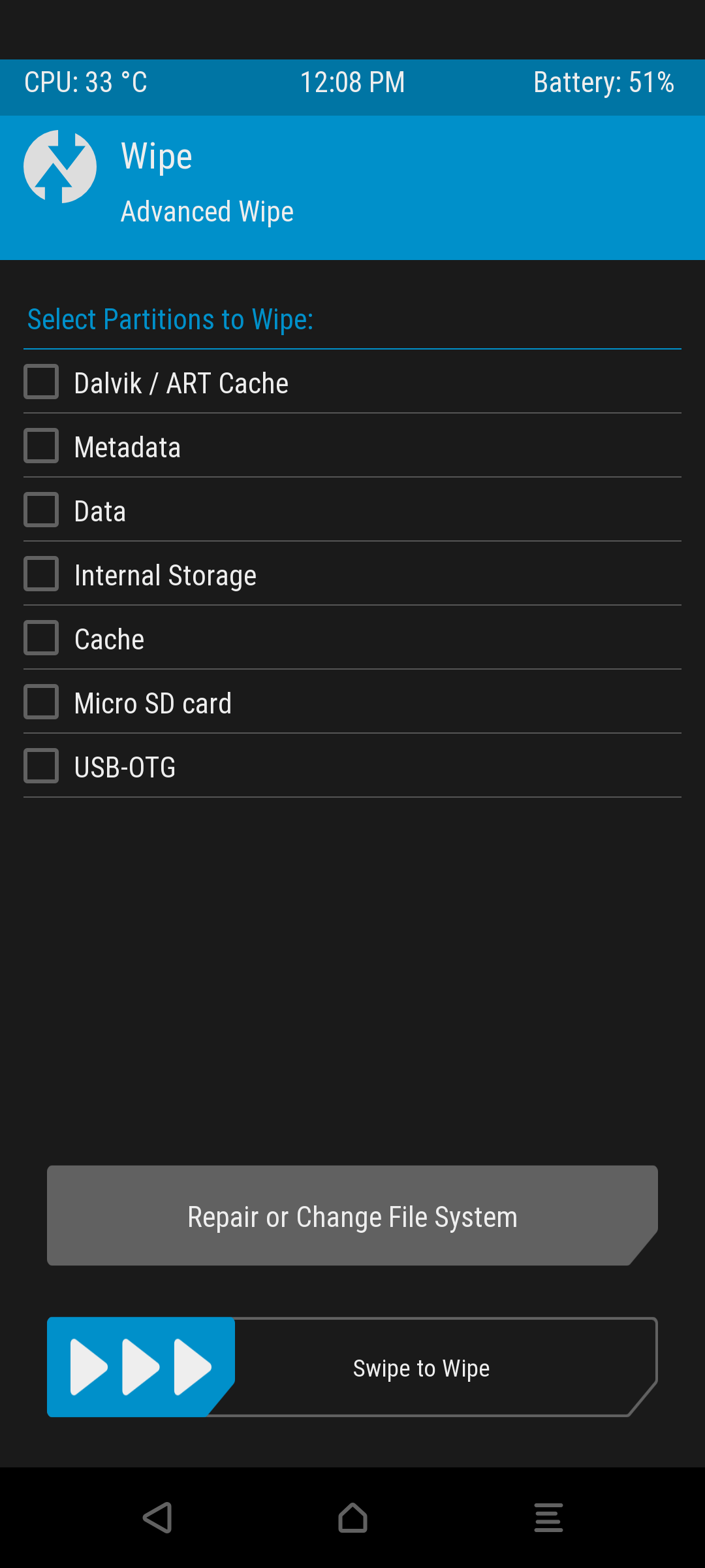

Ok guys i want to ask a really noob question. I'm doing this first time and i don't want to end with bricked device. I'm currently using a CrDroid 9.0 A13, and i want to switch this to this rom V13.0.10.0.SKQMIXM and model is Courbet 4G.
What do i need to select there so i can do clean flash and install this ROM via zip?

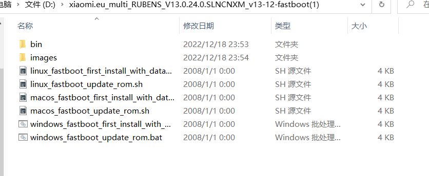

I have a RedMi K50 (rubens) and I want to flash MIUI 13 EU stable version. When I was flashing with miflash, "can not find file flash_all.bat" was displayed on the screen. I am at https://sourceforge.net/projects/xi...lti_RUBENS_V13.0.24.0.SLNCNXM_v13-12-fastboot .zip/download
The downloaded flash package, although the website marked the fastboot version, did not find flash_all.bat in the file after I downloaded it. I don't know what's going on, and I hope someone can help me. Thanks!
View attachment 45050View attachment 45051View attachment 45052
Well, you did not read the instructions. You're not supposed to use Mi Flash at all. You're supposed to run one of the scripts directly according to your operating system and whether it's a first install (with data format) or update from previous Xiaomi.eu ROM (data not removed).
