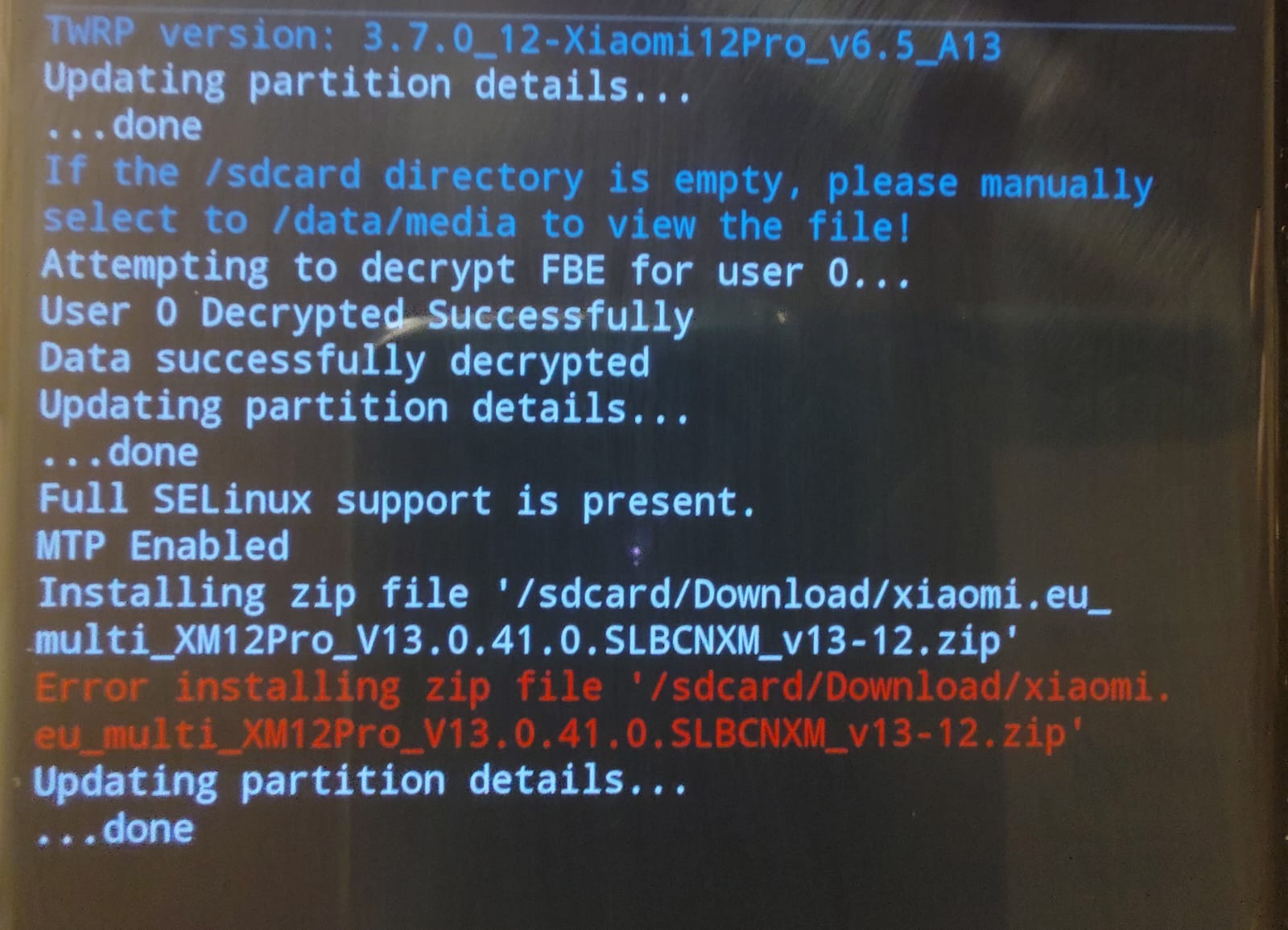

Hello currently I am using the 12pro and I got trwp on it. Sadly I cant install the rom.
For the installation I used the rom with this name: xiaomi.eu_multi_XM12Pro_V13.0.41.0.SLBCNXM_v13-12.zip , should be ne newest none fastboot version.
Sadly if I try to intall it in the trwp it instantly says there is an error. It just says error during installation of file name. Thats it mabey someone can help me. Thanks in advance for your help.

Dude send a picture of the error. let me help you
sry forgott top attach it.
Does the zip file open correctly (in file manager like MiXPlorer)
Btw, instead of taking photos by other device, you can easily make screenshots in TWRP by pressing together Power + Volume Down (Pow and Vol-)
Didnt know I can do Screenshots in there. I can open the file with WinRAR and 7zip have to test it tomorrow with your file manager. It is weird that it doesnt work since it is from the website. Will post a update after I wake up tomorrow.
There is newer fastboot rom for 12 pro. Why don't you download it?
