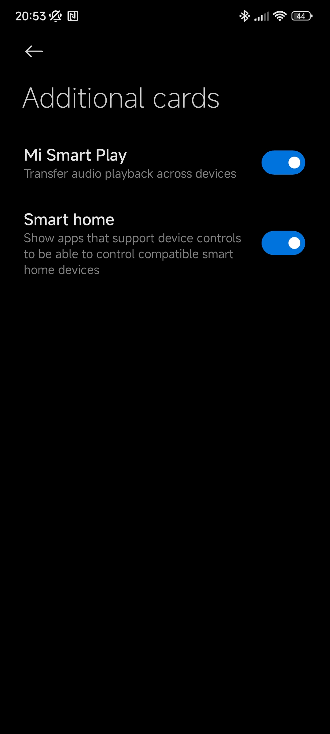

Okay so I've installed MIUI 14 on the Redmi Note 11 Pro 5G and there are couple of things missing. The Mi Smart Hub is missing from the Control Center and also the Control Center has some sort of white tint on it and it's not completely transparent. Other thing that is missing is the lock animation. Other than that it's running very smoothly.
Update: Apps: Twitter and Gmail refuse to operate normally

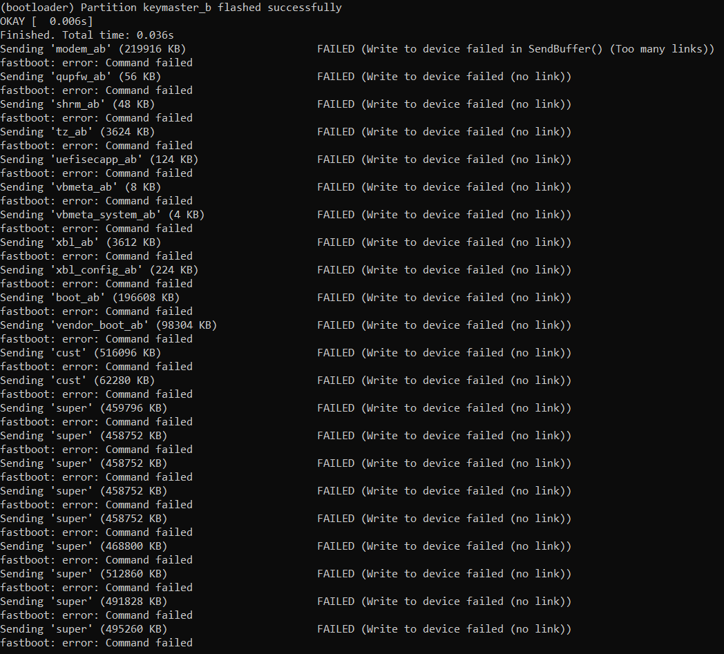

Did anything changed with how the update should be flashed on TAOYAO with 14.0.5? Did it same way as last time but today i had sooo many errors.
