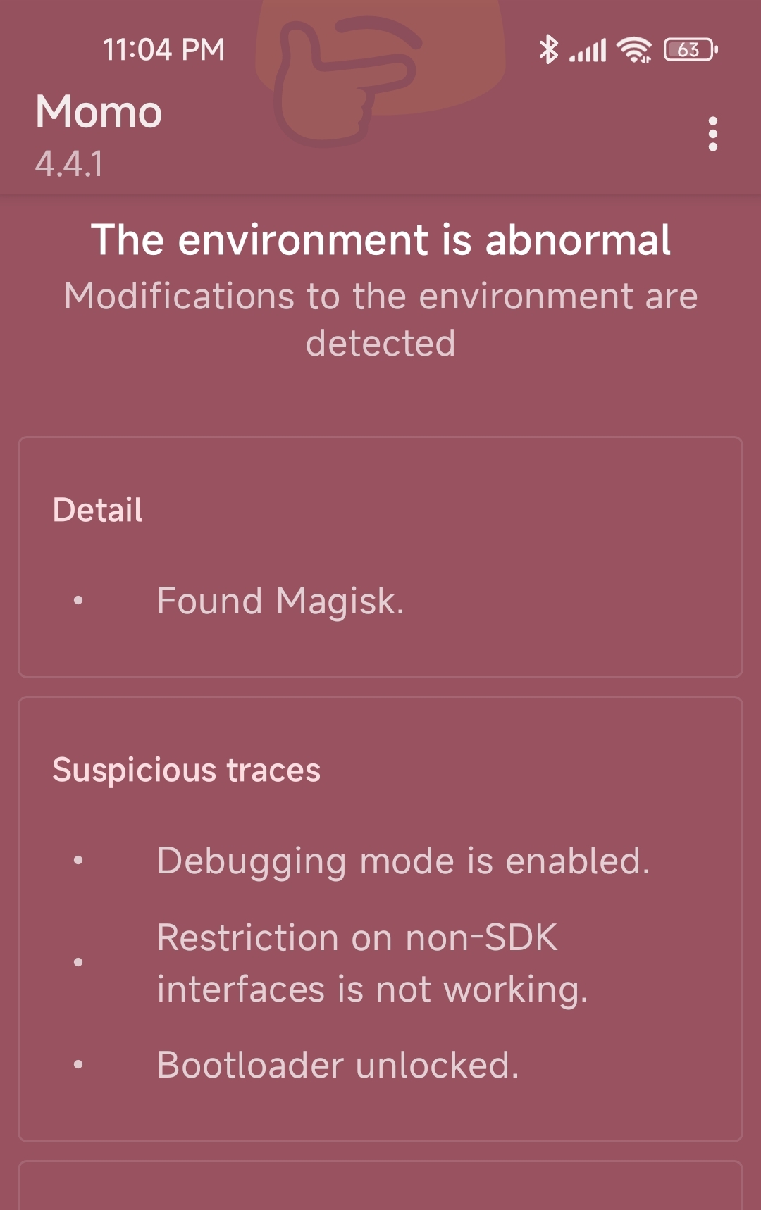

* Restrictions on Non SDK interfaces not working - that's probably from the Xiaomi ROM base (unfortunately I have long ago switched to Xiaomi.eu on my Xiaomi phones, hence couldn't retest on the stock/official MIUI).
Nah, we just needed to update our tools to keep the restrictions on non-SDK interfaces.

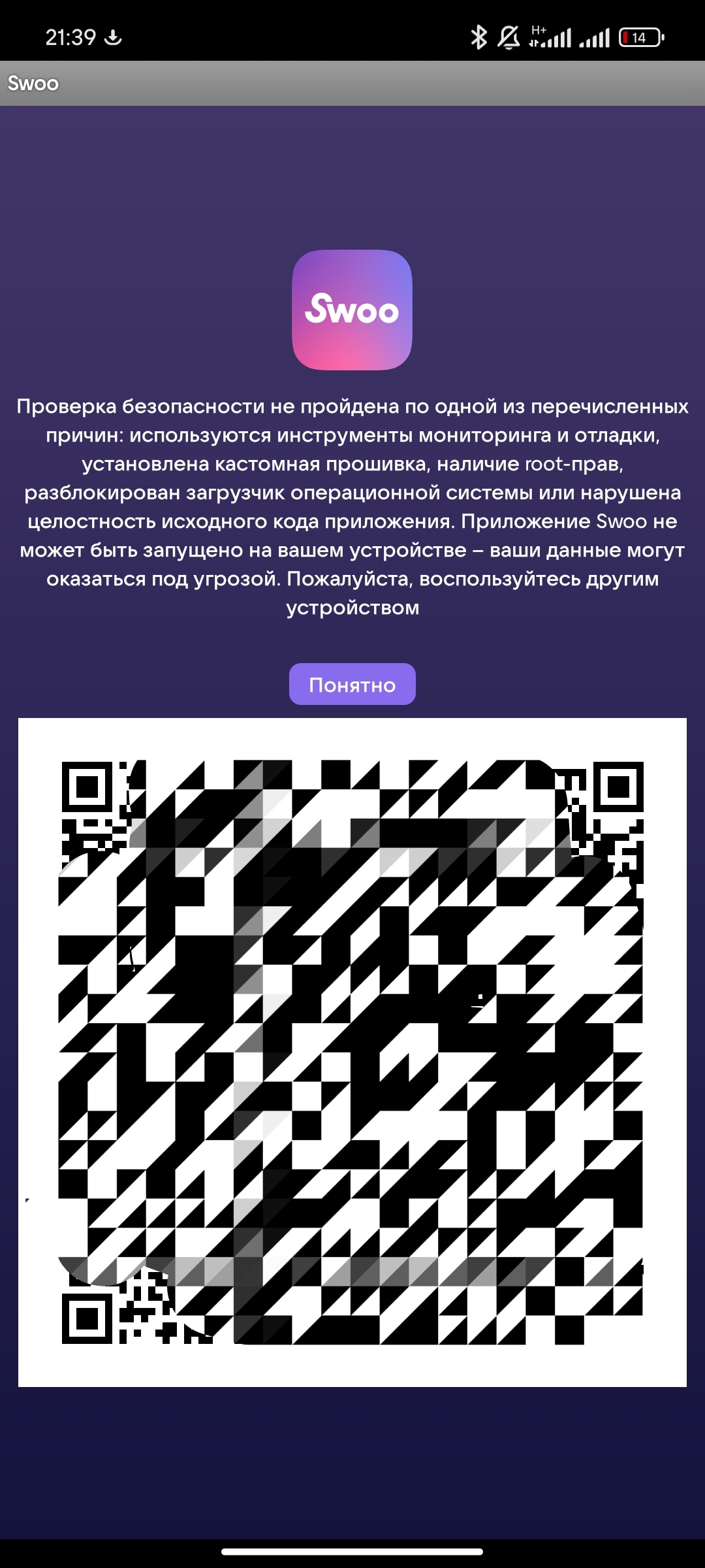

After updating the firmware xiaomi.eu for sweet_k6a (when the module mechanism for replacing fingerprints and passing Play Integrity was introduced), the Swoo payment application stopped working.

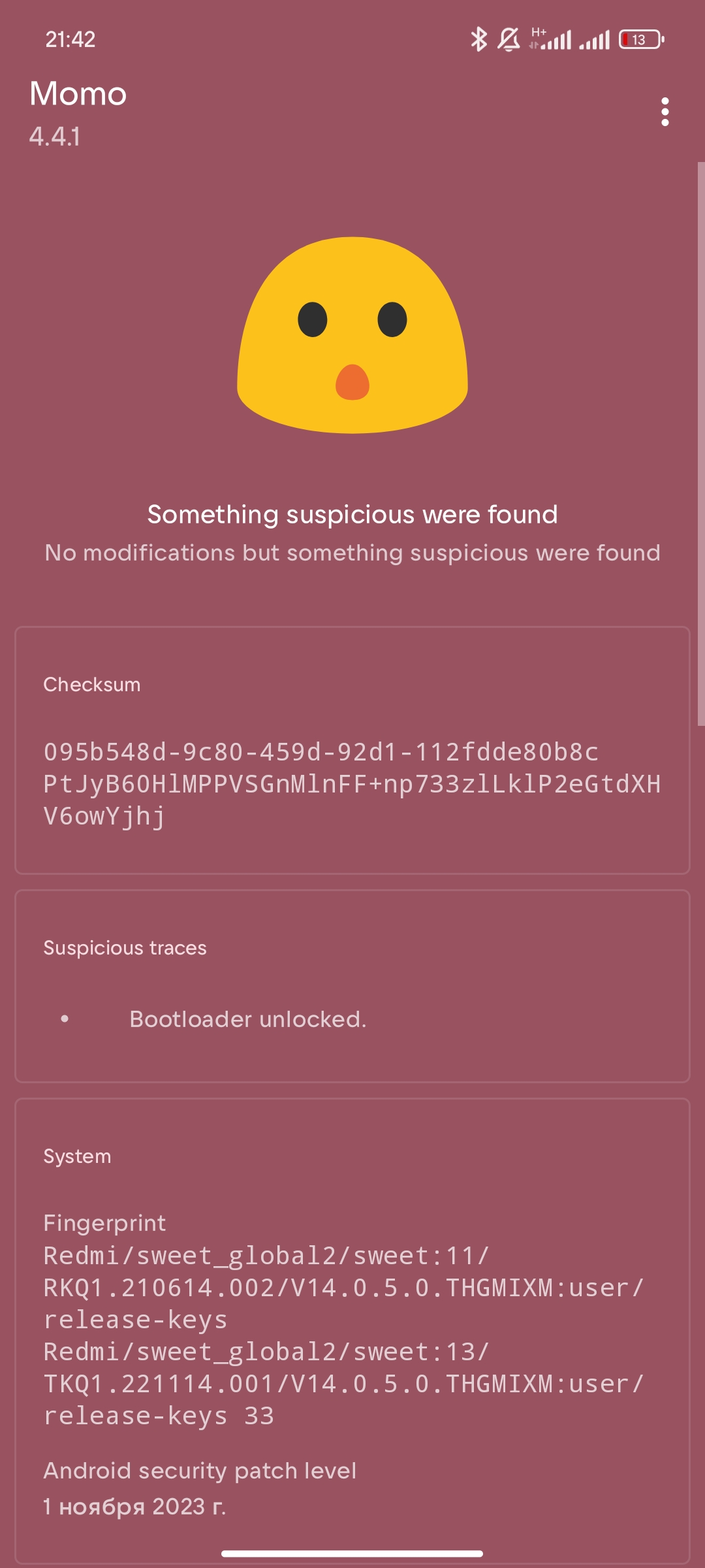

I'm inclined to think that the fact is that the application detects that the bootloader is unlocked, since, for example, the Momo application reports this.
I will clarify that at the moment when the firmware xiaomi.eu all patches for passing Play Integrity were completely removed, the application worked properly (and before that, too), despite the fact that Play Integrity was held only at the Basic level

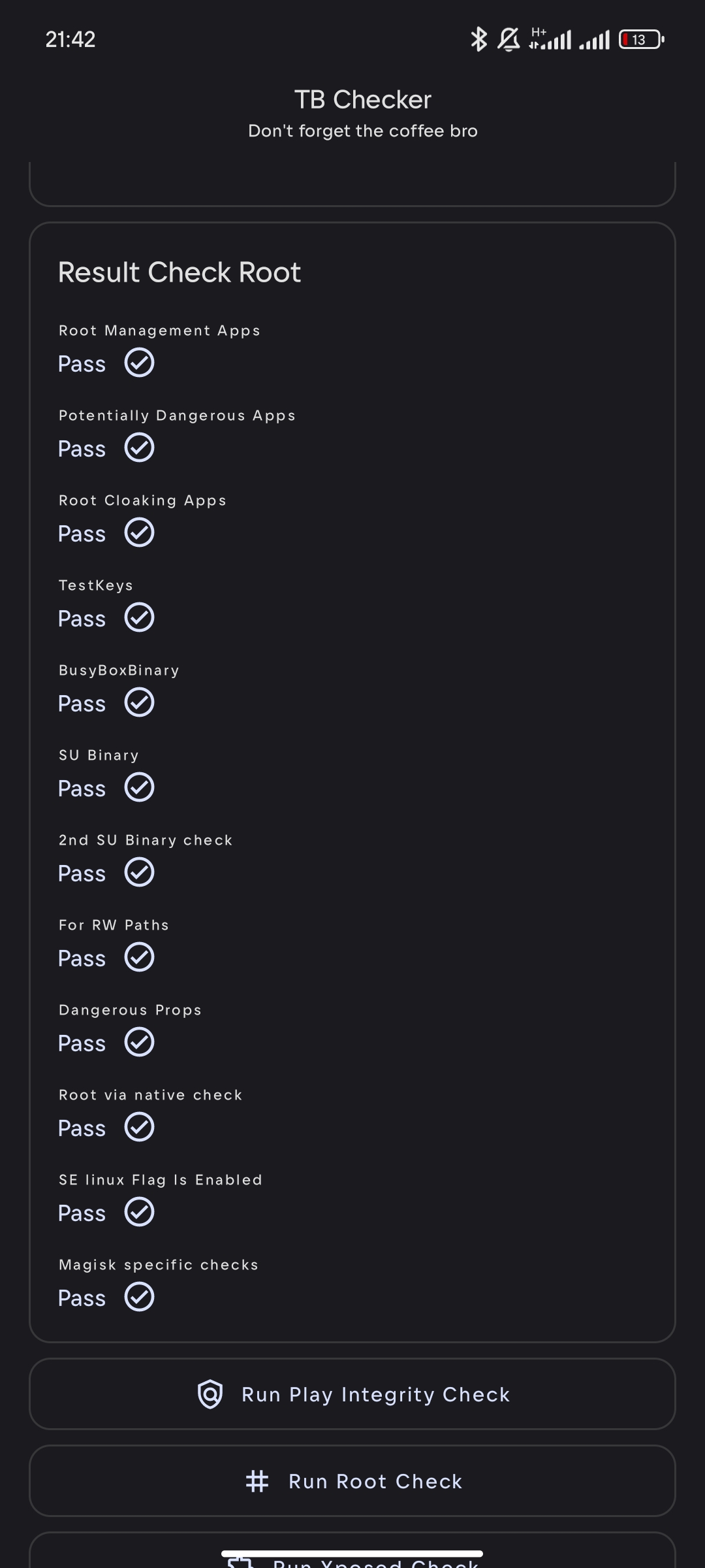

Upd.: I have no Magisk or KSU installed
Can you tell me what to do? I am ready to help solve the problem and try all possible solutions and test firmware builds (but not return a stock ROM with a bootloader lock)

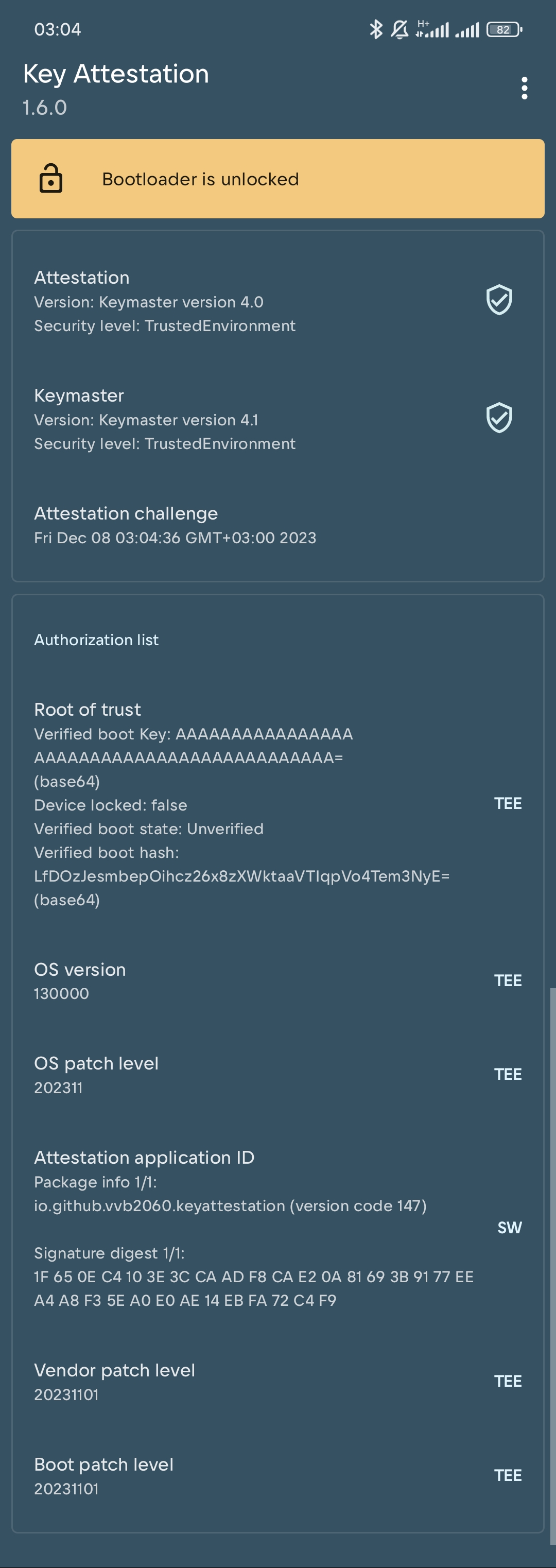

Upd.: Key Attestation results:
1) Xiaomi eu is CUSTOM, not stock ROM.
Locked Bootloader does not allow flashing anything (except updating the stock ROM)
Hence, for whatever custom ROM (or custom Recovery, custom Kernel, or KSU or Magisk), you must unlock Bootloader
And then Momo and Key Attestation app will detect that BL is unlocked
And Injector or Magisk PIF nodule will not help bcs they trick the Play Integrity (and the deprecated SafetyNet) completely the other way. Momo and Key Attestation app, both from the same Chines group of Magisk Alpha, LSPosed and Shamiko developers, check if the Bootloader is locked completely a different way, hence the spoofs applied by injector or PIF module will never 'help' for Momo
If you don't like troubles with unlocked Bootloader, go must back to stock ROM and lock the Bootloader
2) If I understood you correctly, you say that your particular app works when you remove Injector
But when you remove Injector, your Bootloader nevertheless remains unlocked (and Momo will report it), hence unllocked BL cannot be the cause for problems with that app (btw, afaik, there are ONLY FEW apps, eg Uber driver for whom it has been proved that they really look for the unlocked BL, something like how Momo does - for all others there is one or another way - like special Magisk modules, special Magisk forks, KSU with some modules and so, that will trick them to work, while Momo will still 'complain' about the unlocked BL)
There are instructions how to disable Injector and to use then Magisk PIF module or one if its several forks - you can try if that could help you
(Writing this from Lisa with Xiaomi.eu Stable 14, with disabled Injector, with Magisk and PI Fork module, with Viper4Android, CustoMIUIZer14, etc, and I don't give a :) for Momo and its detections, because the Wallet and all my 'banking' apps I need work excellent for me, 24/7)
But no guarantee that your Swoo app will work - the only 'safe' platform will be stock ROM and relocked BL

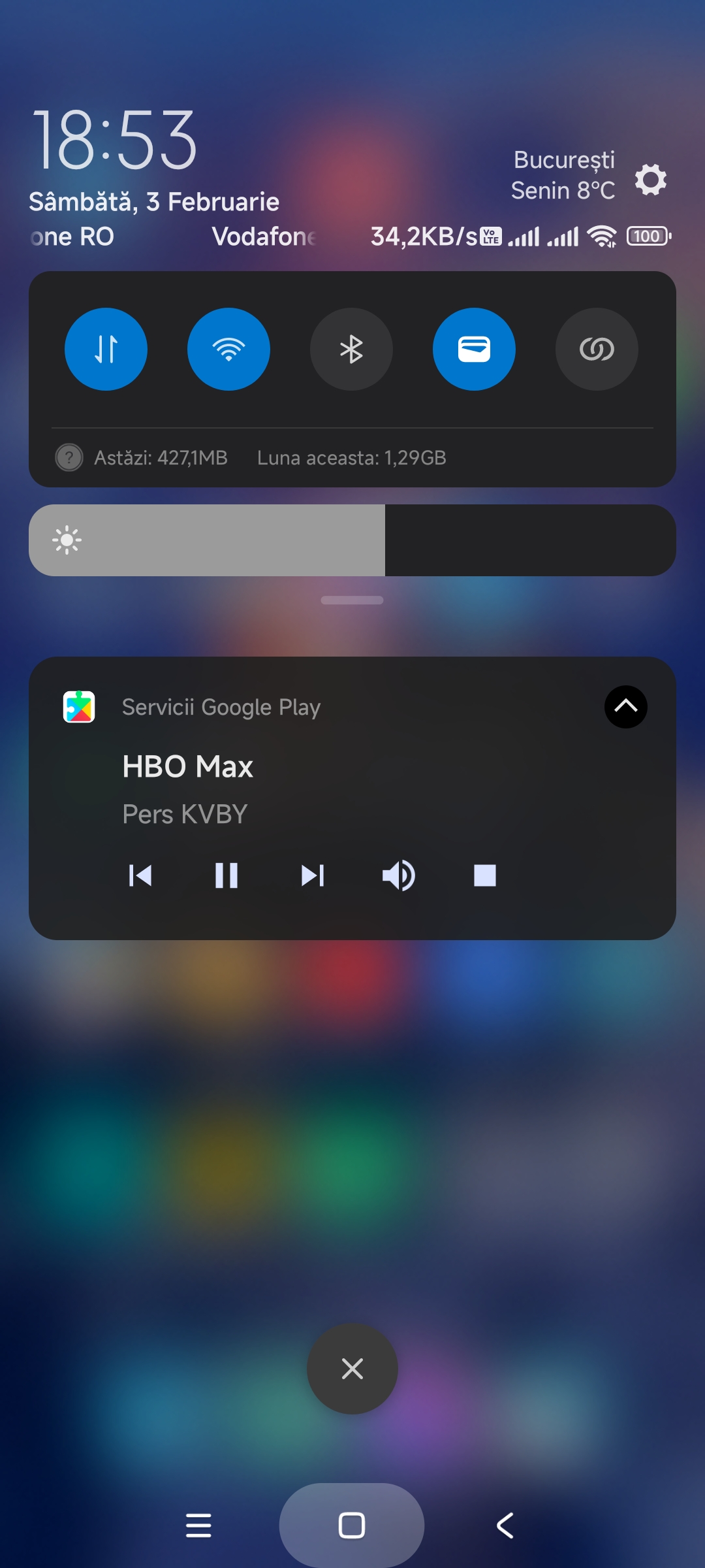

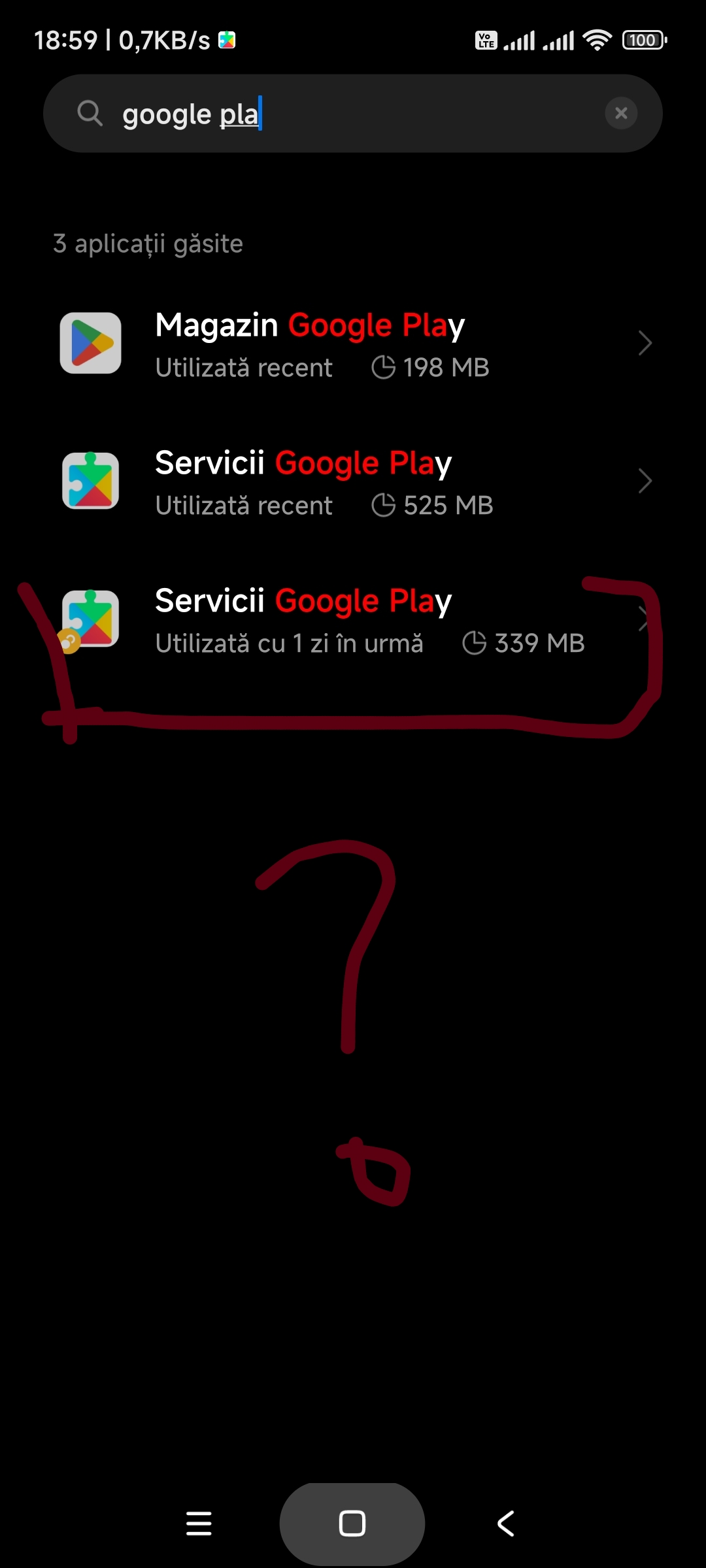

Hello. I have a very weird problem. Sometimes Google play service starts randomly to play in Taskbar : HBO MAX : pers kvby. I don't have the HBO TV app installed and nothing like that. Is this a virus or what is is, if I force stop Google play services it starts again in a few moments, this happens to anyone and has any idea of what it is? I will post a screenshot. And another problem : do you have 2 of Google play services installed in phone? Like the dual space for Google play? I have 2 Google play and idk why.
Xiaomi 13, miui 14 latest stable 14.0.31

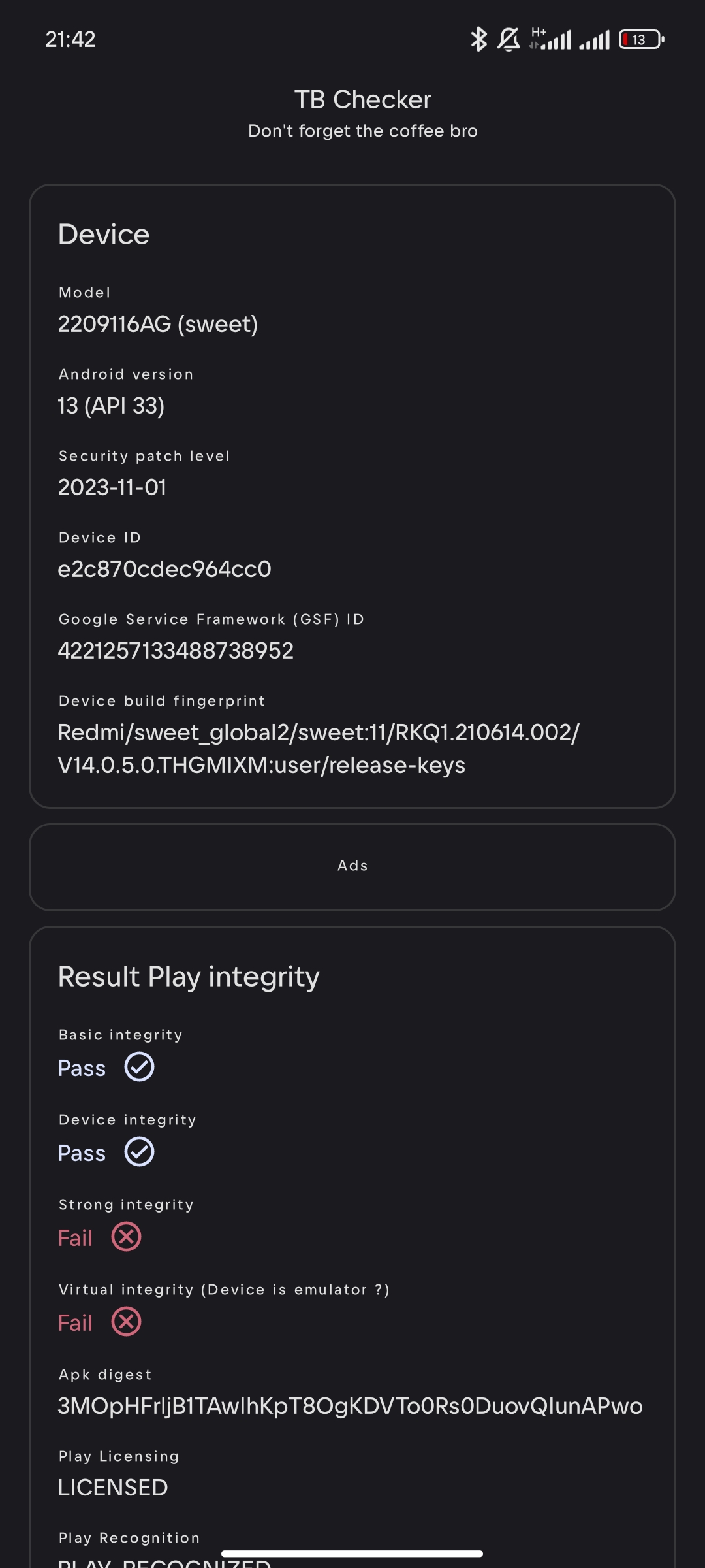

play integrity is not working in my poco F5, I already installed the XiaomiEUModule_2024.01.15.apk. Someone can help me? I can not use my bank app.
