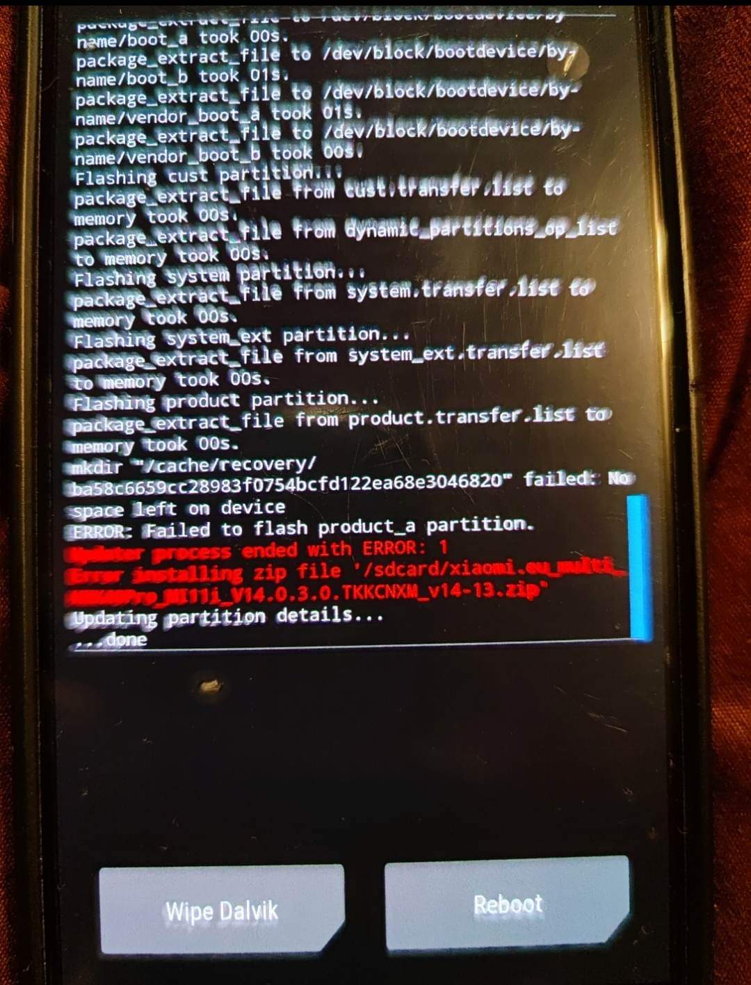

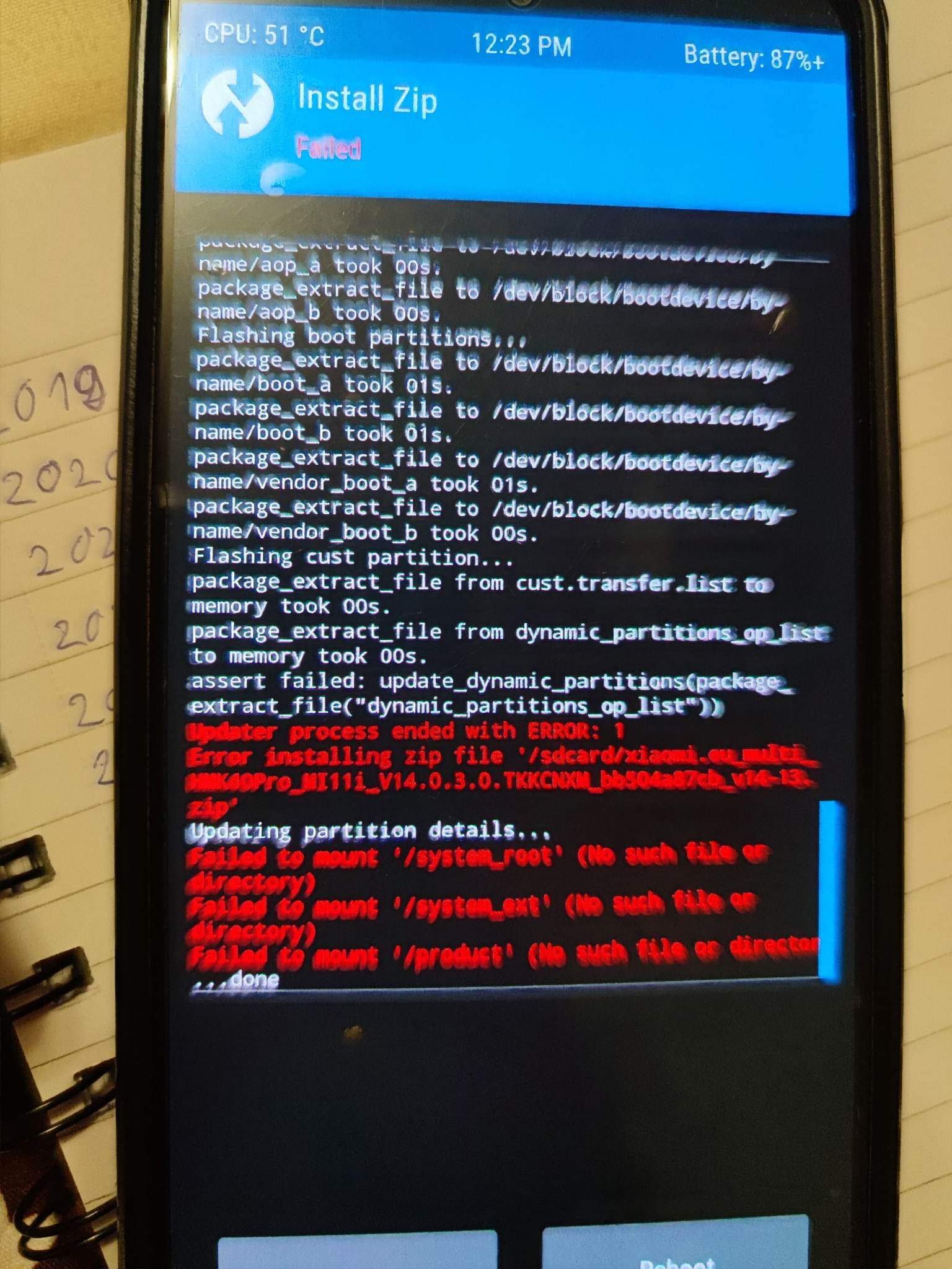

I had these two errors while fashing. One is when i wanted to Update and the other one is when i did a clean install.. what do you think guys?
