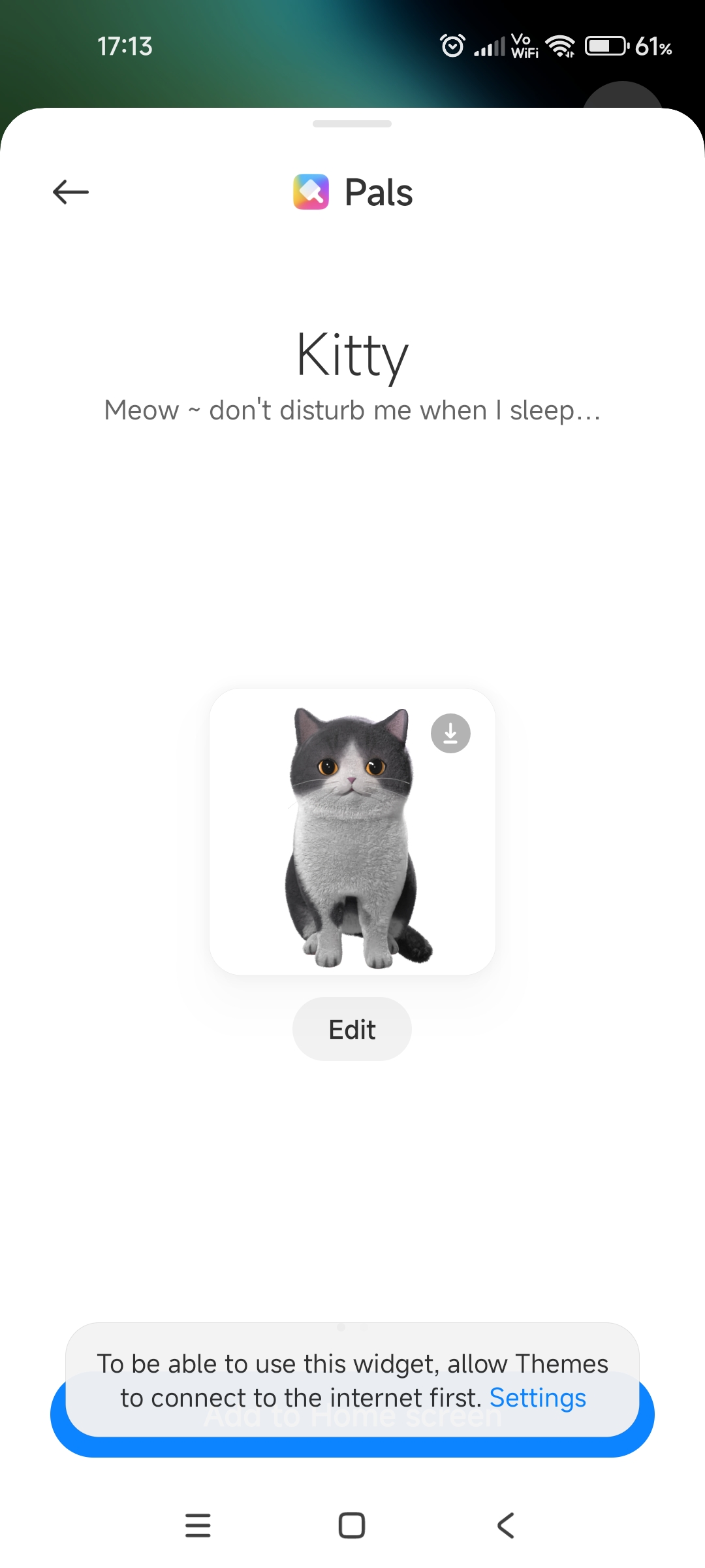

hello friends, am I the only one who can't use these animals? Or is this the case with you?

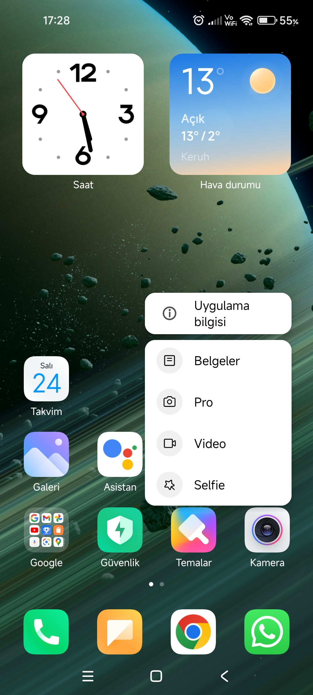

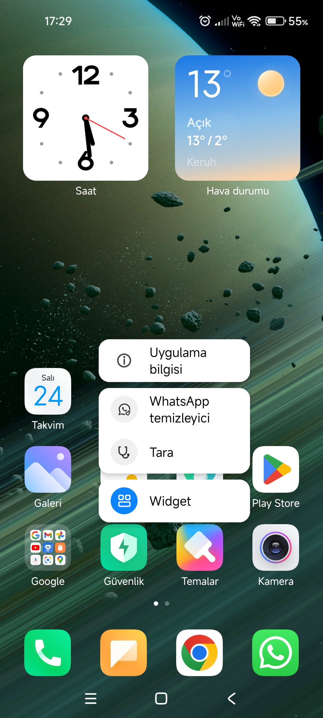

I can't use super icons.

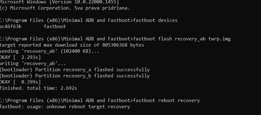

Hy. I flashed twrp-3.7.0_12-v7.0_A13-cupid-skkk.img , I renamed it to twrp.img first. My device is Xiaomi 12 so I used code:
fastboot flash recovery_ab twrp.img
It said it finished and then I used code:
fastboot reboot recovery
but the device did not reboot to twrp, I got a message: fastboot: usage: unknown reboot target recovery
What gives?
Luckely my device booted fine to system. I would like to know if there is something I did wrong or?
EDIT: dumbass! Should have used fastboot reboot twrp right?

Try to enter twrp manually. Power + up button

Some phones won't respond to that command. It probably expected an actual partition as a value such as "fastboot reboot recovery_a"

Are you able to read?
The toast notification on the bottom explicitly tells you that Themes app has no permission to access the internet.
Open the Themes app and grant the permissions as requested on startup dialog.

No. Read the first point in "Notes".
Your mistake started the moment you downloaded "Minimal ADB and Fastboot" to your computer (an archive that was last updated like in 2018). That's why you get "unknown reboot target recovery".

Yes, I can read. I click to allow the application does not ask for permission when it opens, I checked the settings, there is no problem with permissions. I will upload a video if possible, but I can't.

Lock app in Recents works for you?
Mine stopped working after updating to MIUI 14. When I long-press Recents just freezes.
You replaced our Themes app with the Global Themes app. That's your problem. We say this repeatedly: don't mess with the included MIUI system apps.
Yes, I changed it :) now I removed the updates, I tried it and I can use the super icons. I'm sorry if I disturbed you.
