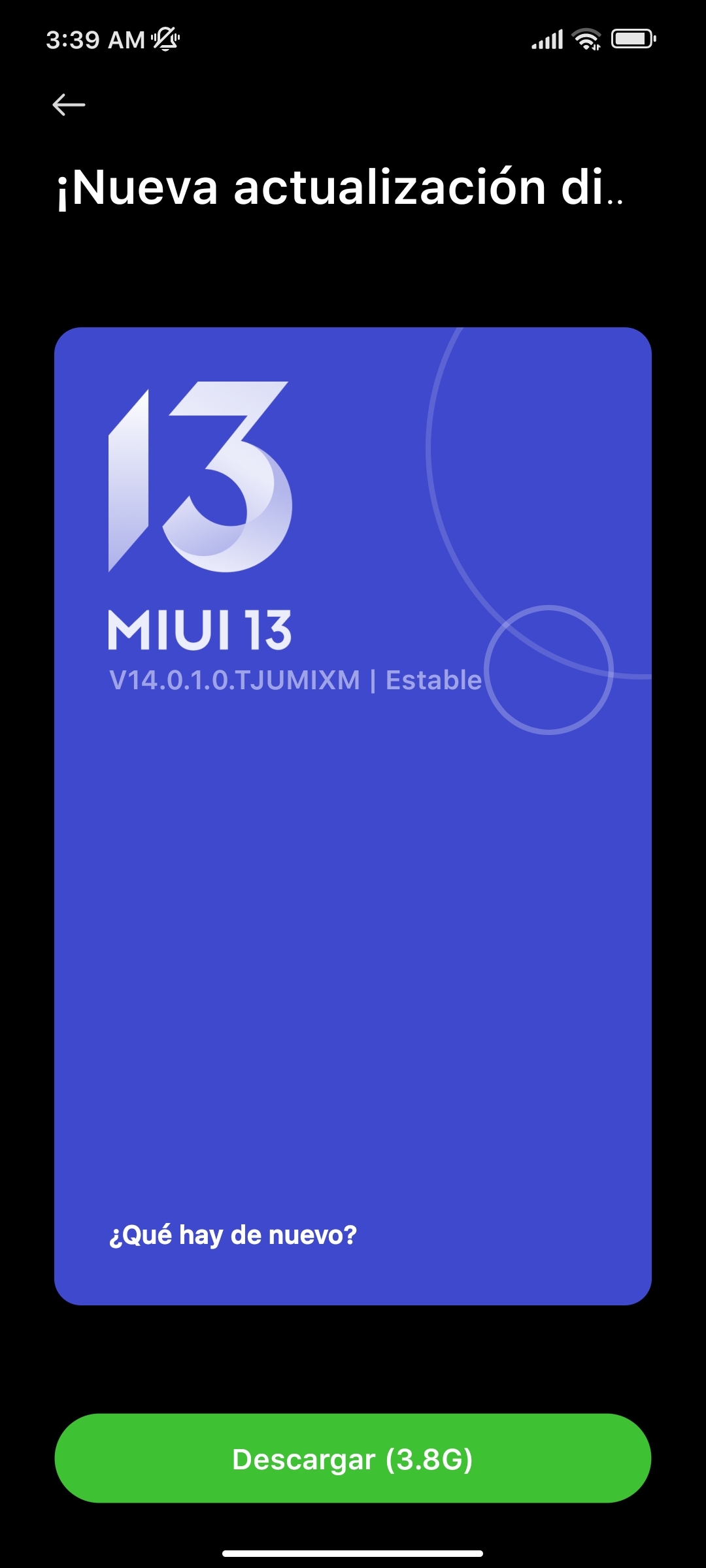

I have a question, I'm on miui 13.0.9. and I got the update here. My question is if I can flash the .zip without formatting? I don't want to lose the current data
