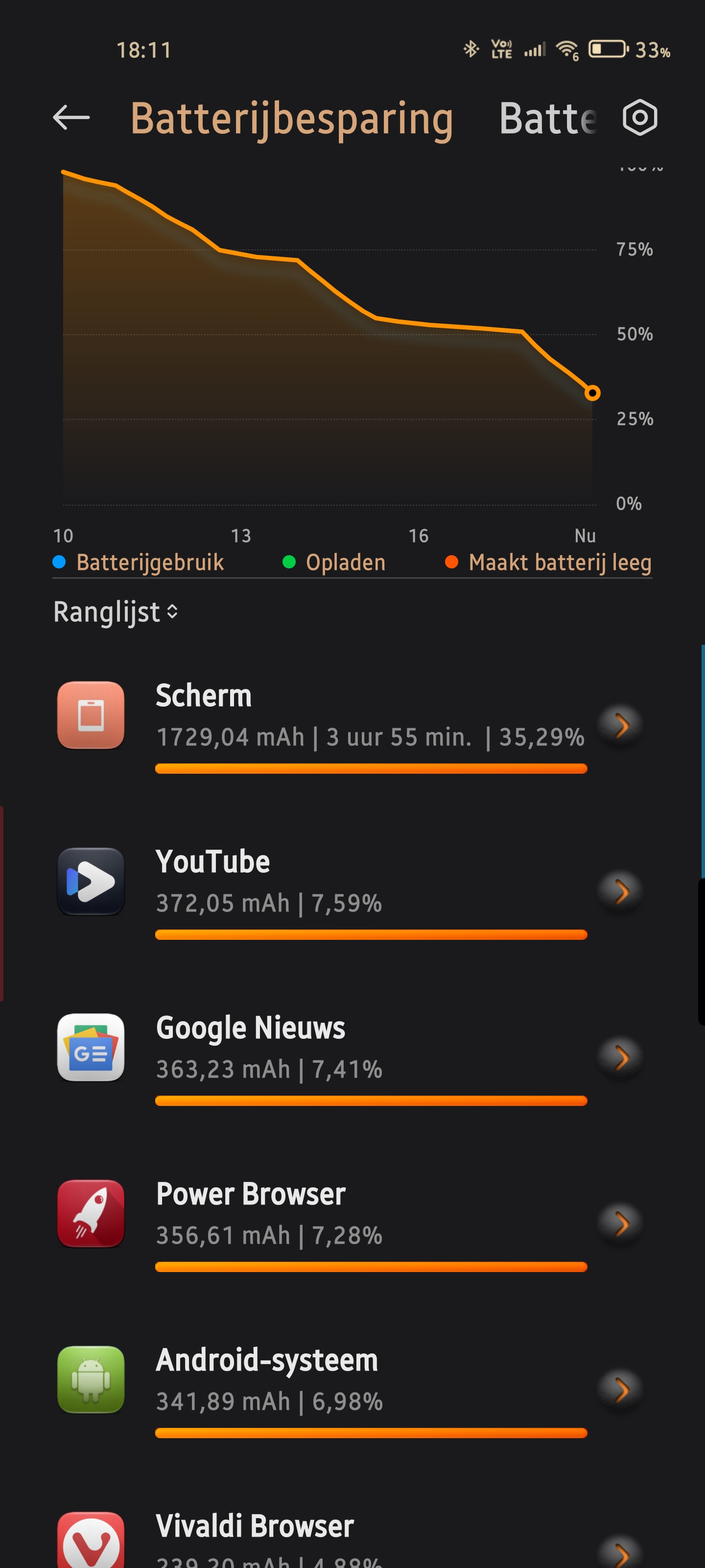

We're looking for the breakdown below that, not the chart of the total consumption. That doesn't tell us anything about what exactly is using the power.
Also dark mode should improve battery since you have an AMOLED screen and not an LCD screen. Then it doesn't waste energy lighting up every pixel to full brightness when it doesn't have to. LCD screens work the opposite way, so dark mode will use more power on those.

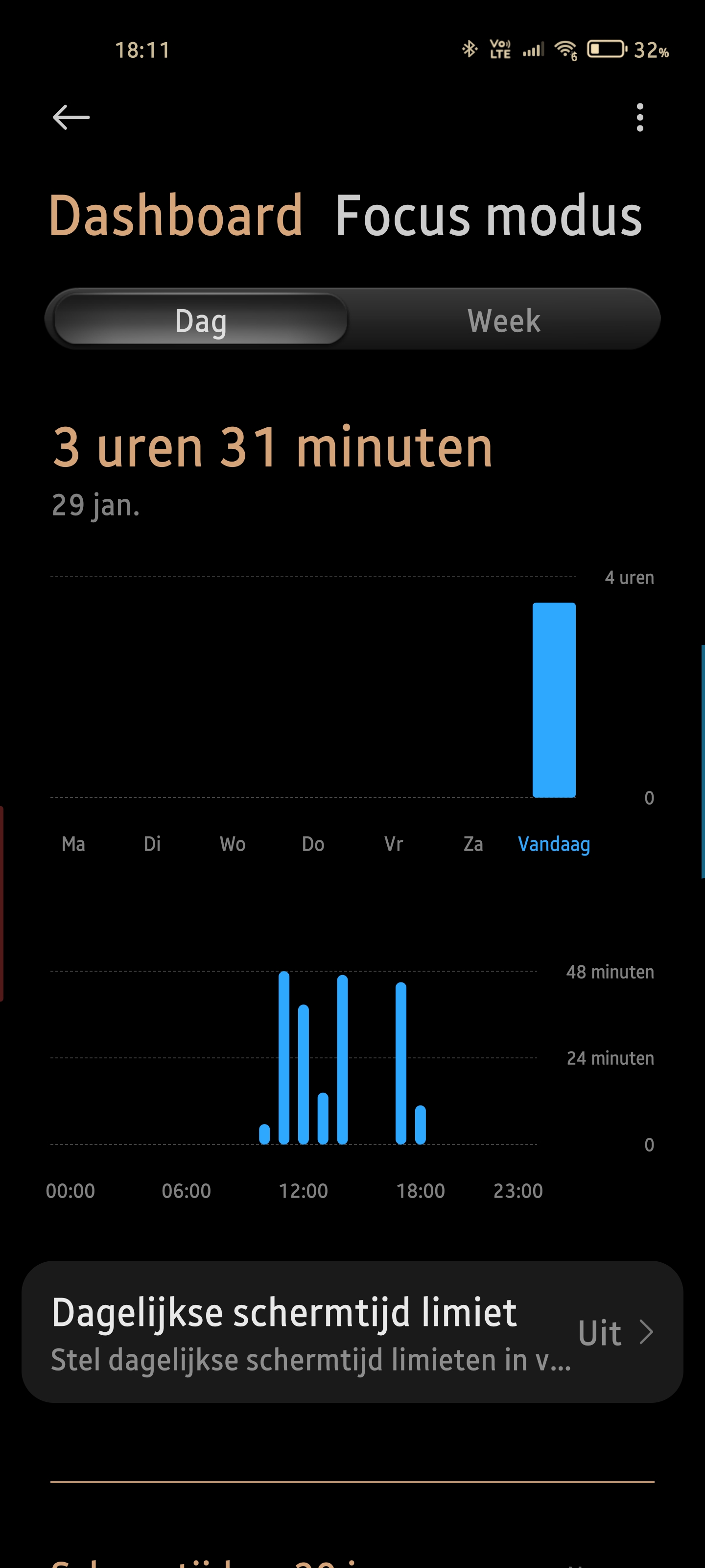

I changed to dark mode, thanks. I am now on 3,5 screen on time. Battery is down to 30 something percent. The screen is eating the most energy which is not surprising. Could set it to a lower resolution and refresh rate but who does that :). I'm just curious if this screen on time, probably around 5 hours is normal (after all the phone is more than a year old).
Your screen is still using ALOT of power. For example on my F3 on this charge it has been active 21hrs 22min, 3hrs 32min screen on time since I didn't use the phone that much yesterday, and my screen power use is 400mah. Are you using auto brightness? I would definitely try turning down the refresh rate on your phone and see if it helps. You can always switch it back if it doesn't.
My F3 is also a year old. I have 40% left currently, and I used 30minutes worth of voice calls yesterday for comparison.
Great, yes , I am using auto brightness. Will deactivate that and see if that makes a difference. After that I will try the 60hz suggestion and see if I can get it down to your numbers. Thanks for the suggestions!
Auto brightness usually is fine, but maybe it's keeping your screen too bright for some reason. I thought maybe you had it set to full brightness all the time or something based on the power consumption.
Ah, okay. No, full brightness is a bit too bright for me. Auto brightness is now off, let's see what happens. Now I know that the screen should use less energy so thanks..
