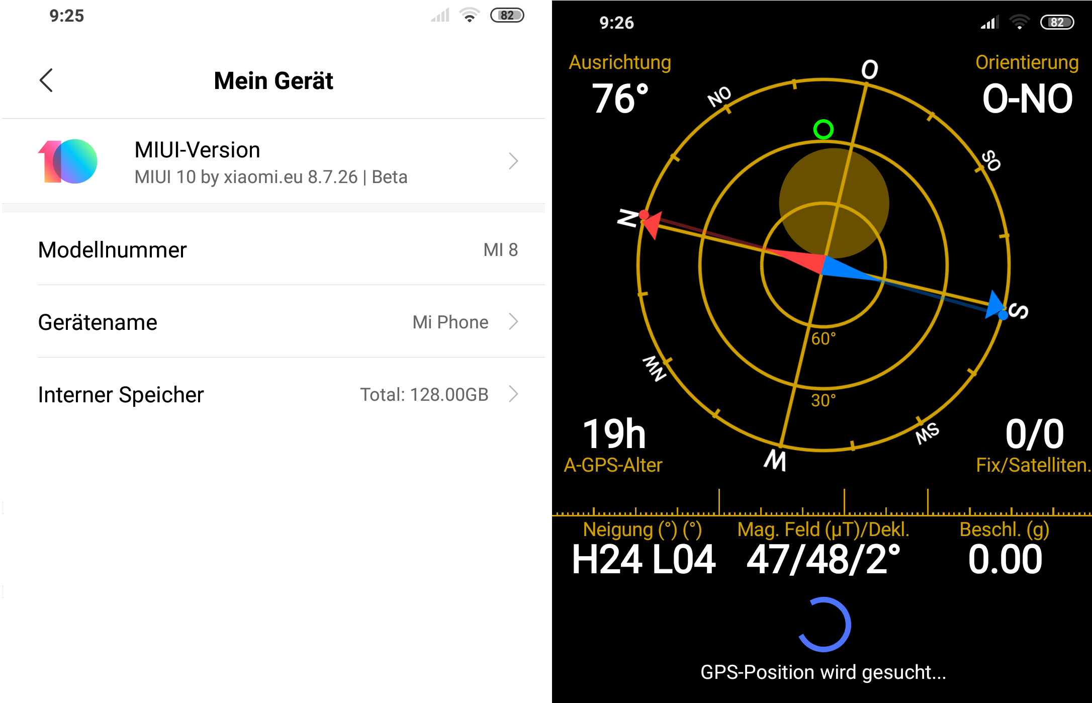

@Patit
Thats my problem. Its working, but only for 30 minutes or so. Then, GPS stops working completly. Only reboot gets it working again...

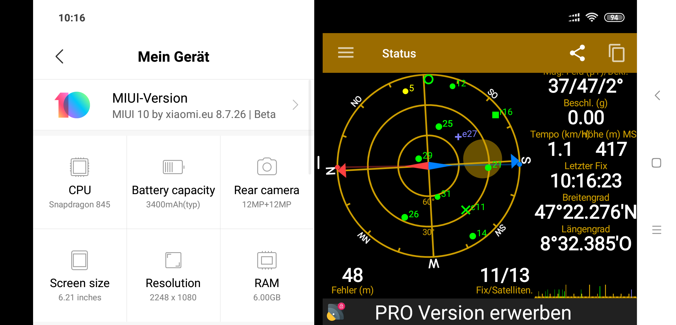

I didn't say it doesn't work. It stops working after a few hours and needs a reboot to reactivate, even on 8.7.26
Phone is still running 6 days without reboot.
