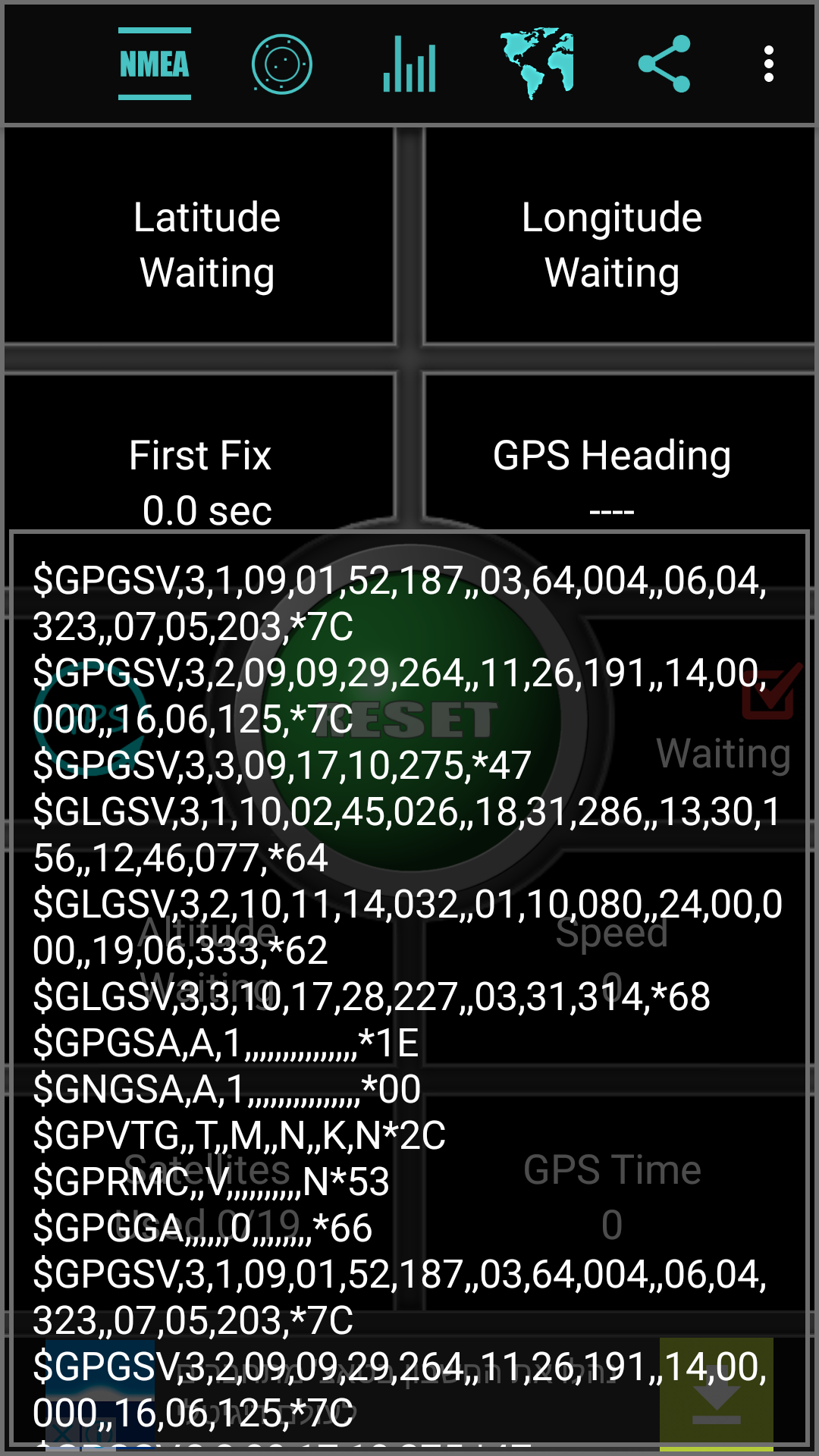

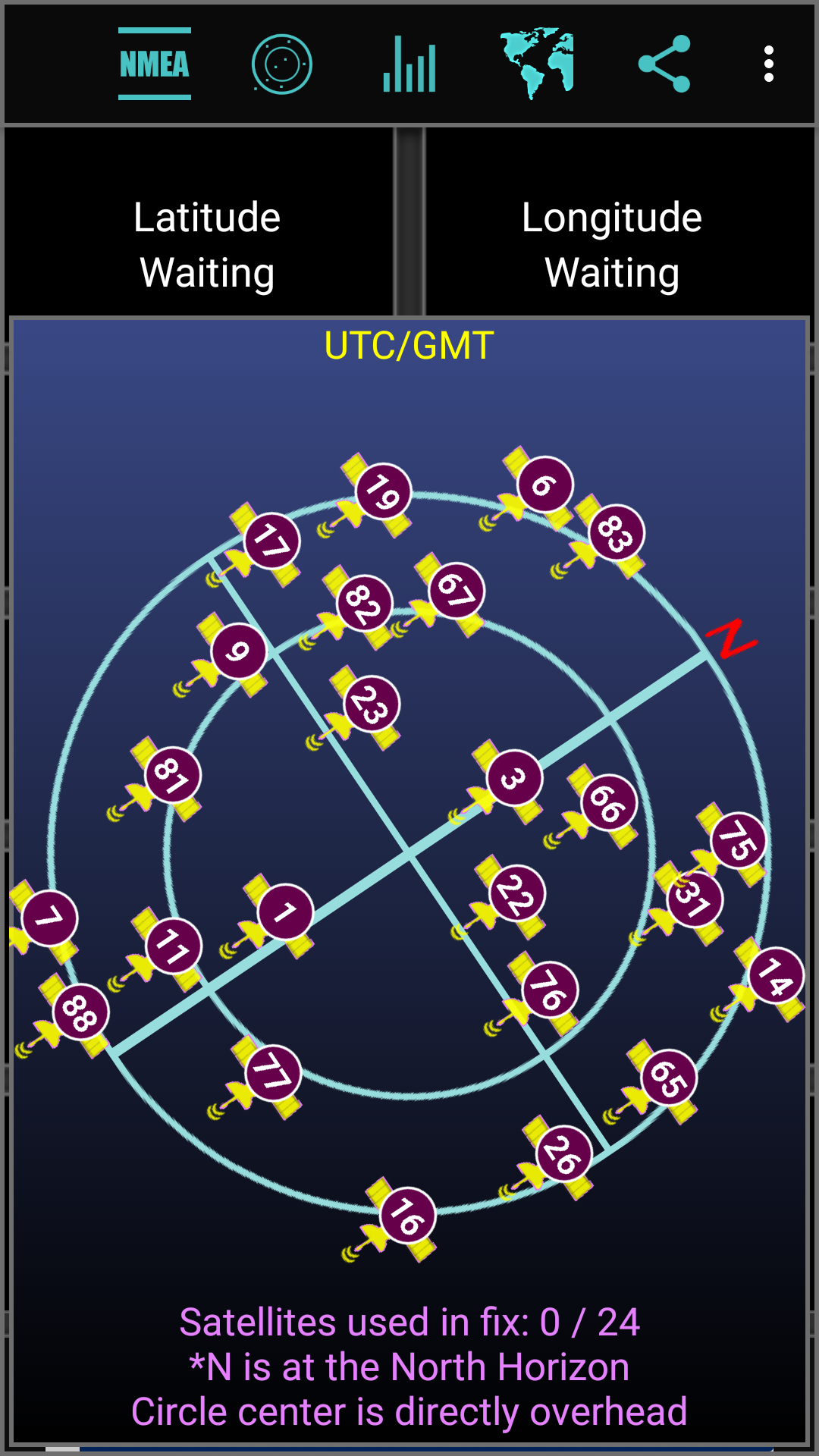

Meanwhile I flashed again Lineage as the suggested app by @debianus didn`t helped in MIUI, that`s the result
These probably describe satellites but the phone fails to connect to any of them no matter what
