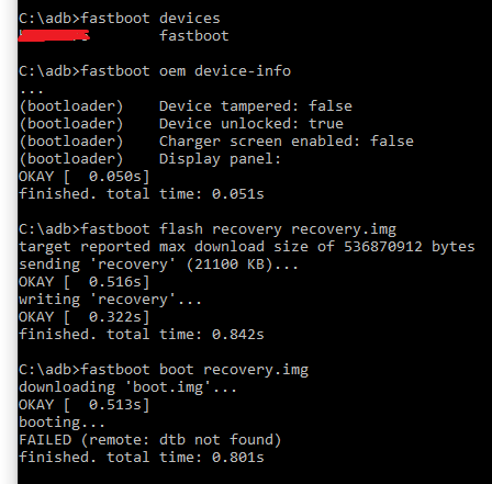

I have an issue, I can't boot on TWRP.
I downloaded twrp-3.1.1-1-libra.img and put it in my adb folder. I rename it recovery.img.
I ran the phone in fastbootmode and did the cmd as follow (see img)
"dtb not found" sounds like the twrp version is not good. Now I can boot normally or in fastboot mode but I can't access to TWRP anymore.

Okay, I finally managed to install the rom. Here, all my steps:
- download twrp-3.1.1-0-libra.img (doesn't work with 3.1.1.1)
- put the ROM at the root of my phone
1. adb reboot bootloader
2. fastboot devices // check if device is listed
3. fastboot oem device-info // check bootloader info lock/unlock
4. fastboot flash recovery twrp-3.1.1-0-libra.img
5. fastboot boot twrp-3.1.1-0-libra.img
6. wipe
7. install the rom and reboot
8. error: boot loop
9. use miflash_unlock-en-2.3.803.10 and re-unlock the phone
10. reboot and wait a bit. Here we go, I am on MIUI 9
