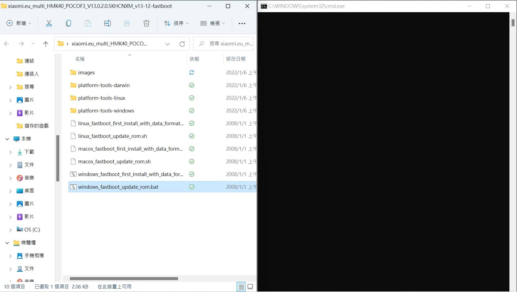

POCO F3 fastboot update to MIUI13 stable not work
Miang
Jan 6, 2022
4
5
I click setup, cmd is blank not everything change ,what happened?

Means fastboot is waiting for a device to be connected to the PC in fastboot mode.
Fix your drivers.

Where can download driver, I use miflash don't success because it don't find midrive.exe
get that latest flash tool
download and extract and then run XiaoMiFlash.exe
and then there should be the driver installation window coming up, if it doesnt, click on "Driver" in the list inbetween Configuration and "Other"
After that, use the update rom bat
