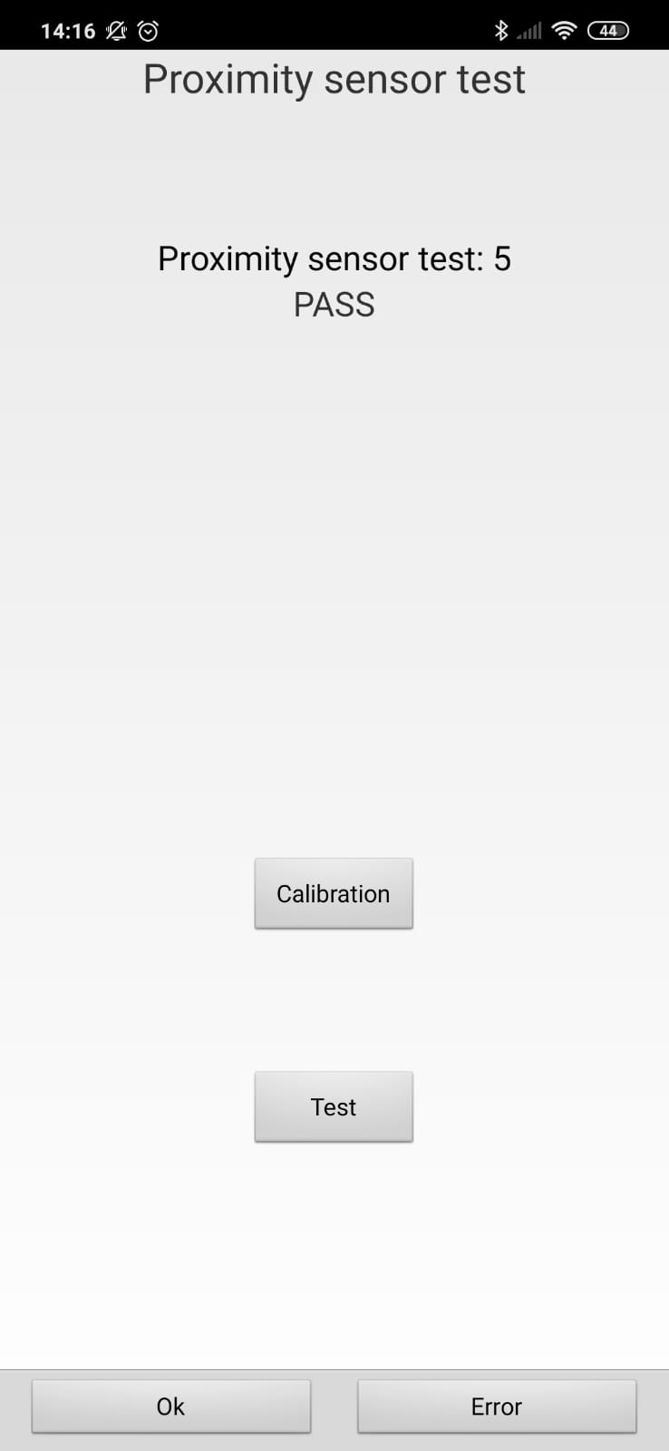

I'll try asap, I will post here results and other noticesMeanwhile you could try this app and see if it works or not > Proximity Sensor Reset (Calibrate and repair)
are you talking about the setting that is in "call settings", accessible from the dialer?
I'll try asap, I will post here results and other notices![]()
No, the app didn't fixed the bug. Is it that because my proximity sensor is broken? I mean... maybe is a hardware problem <.<
I too am facing the same issue (I'm on lavender, 10.3 stable). I tried to test my proximity sensor via the dialer -> *#*#6484#*#* -> Proximity Sensor, but nothing registered (as if it were disabled).
I'm wondering if there's a way to use the light sensor as proximity sensor during calls (value drops significantly when close to the ear) - but I couldn't find anything yet...
