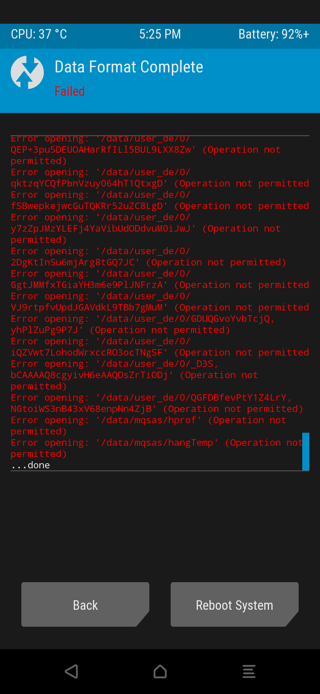

I have tried that and it does not work. It gives the dreaded RED ERROR list no matter where I flash from.
Given that I can not use TWRP to flash, that ROM is also unflashable because I can only flash a ROM through FASTBOOT and there is no Flash_all.bat

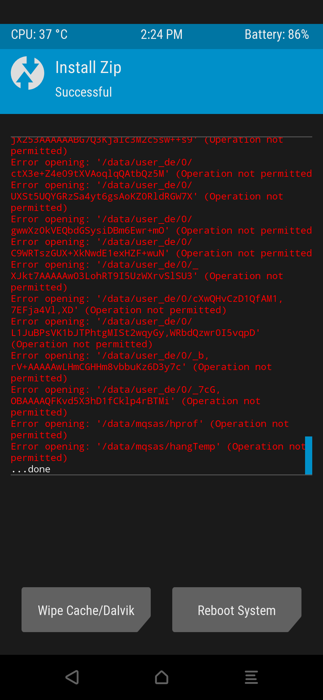

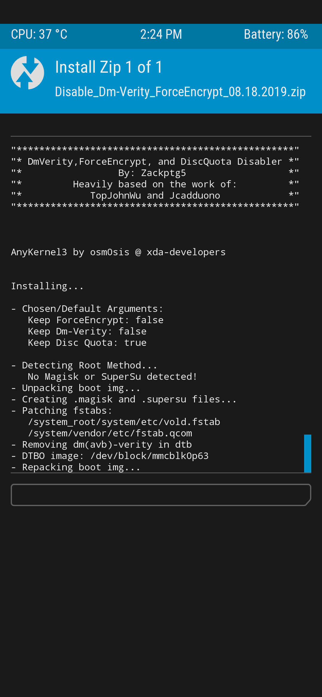

I can not run anything even by dropping a zip file on the sd card. EVERYTHING is read only from TWRP
Last pic added is from trying to flash a zip that is on the sd card. It says that it was successful but actually it caused the RN8 not to fully boot.

I would like to install the ROM you have posted above but it seems only fastboot roms can be flashed in the state I'm in now

Stop playing with "forceencrypt zip file" . You don't need it for the steps I suggested.
