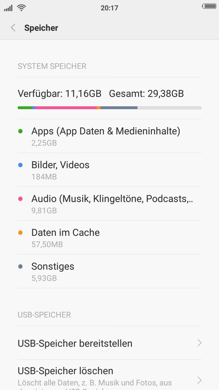

I'm on sMIUI 5.7.16 with merged partitions. At least I think so... btw, is there a safe way to test wether or not I'm on merged partitions?
With TWRP flashing of AOSP finally worked - but after booting into the new system there is no SD card detected...
wrong layout of your Mi2S
there are 2 layouts the old one and the new one - for the new one are SDcard and appdata merged, you have to install the other layout rom
Reactions: Matze002
Does the attached image tell?
EDIT: seems I got partitions merged, question now is, wether or not CM or AOSP are available for merged partitions... (as OP ROMs are for unmerged, correct?)
