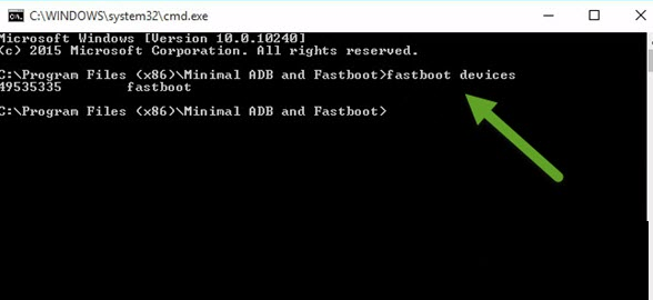

3. Enter the Fastboot mode and connect your Tablet with your PC.
4. Check if your Tablet is successfully connected by typing "fastboot devices" in your command line.
