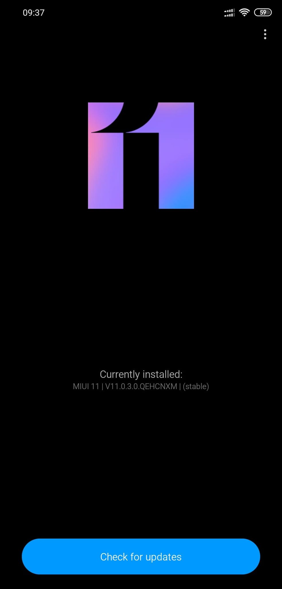

I tried it and its fully working and i installed the miui11 sable with it.

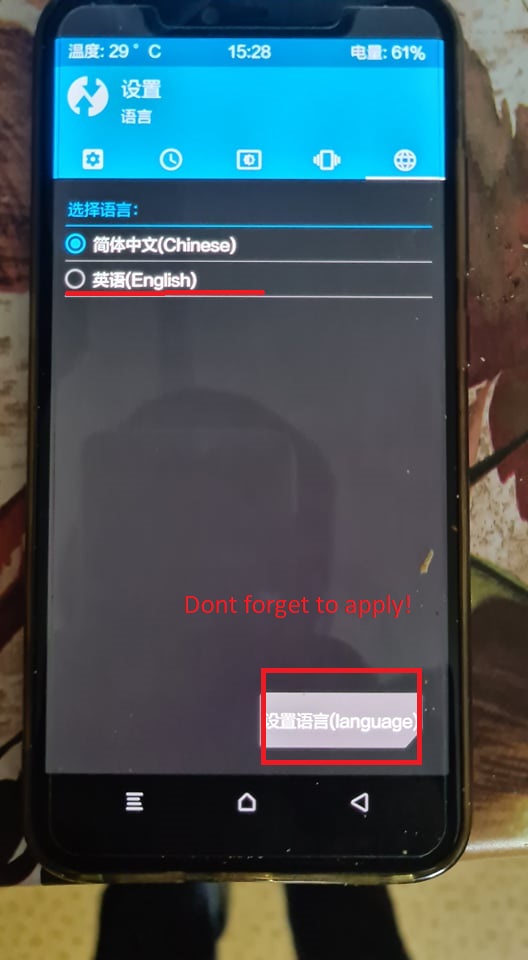

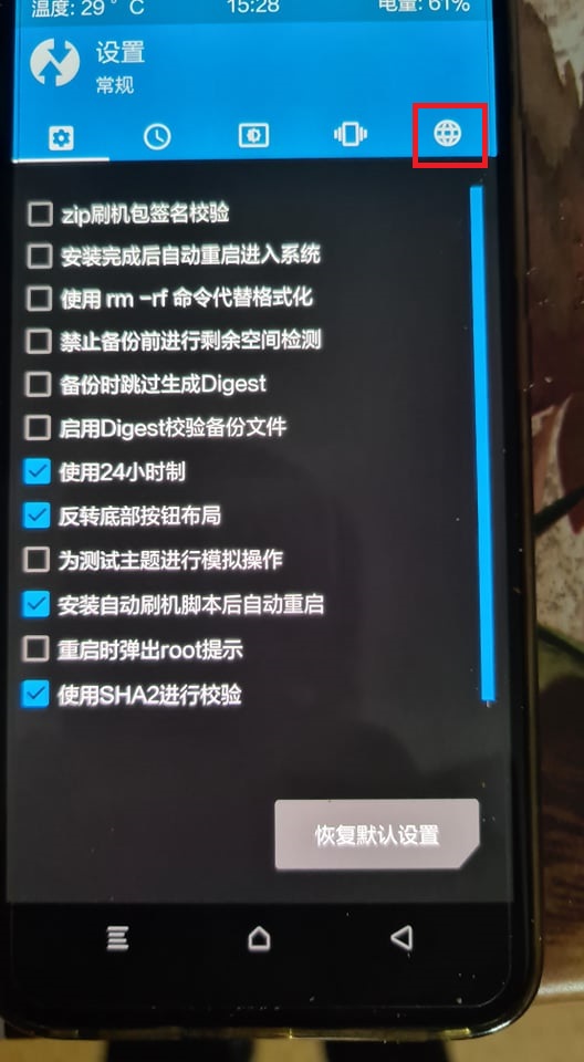

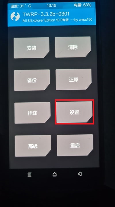

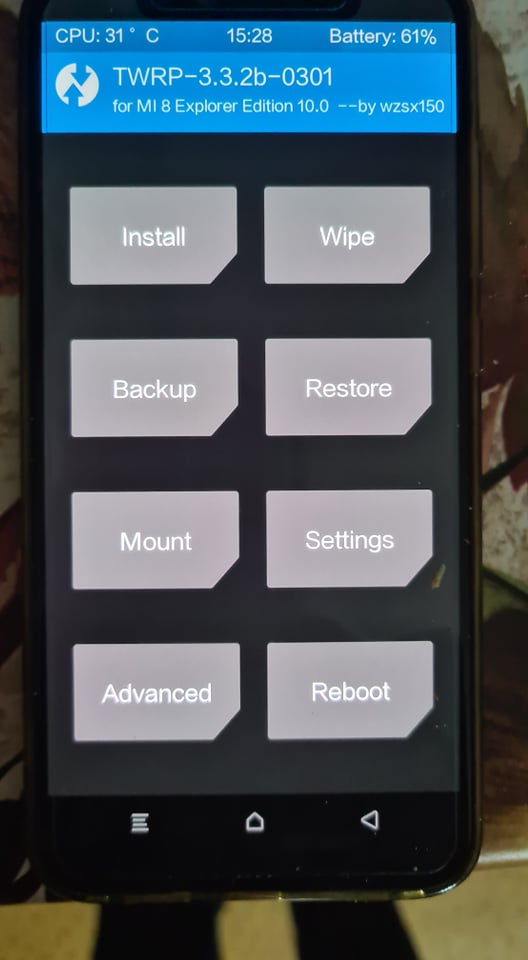

But as you can see it was chinese, but you can change to english (see the attached pics)
