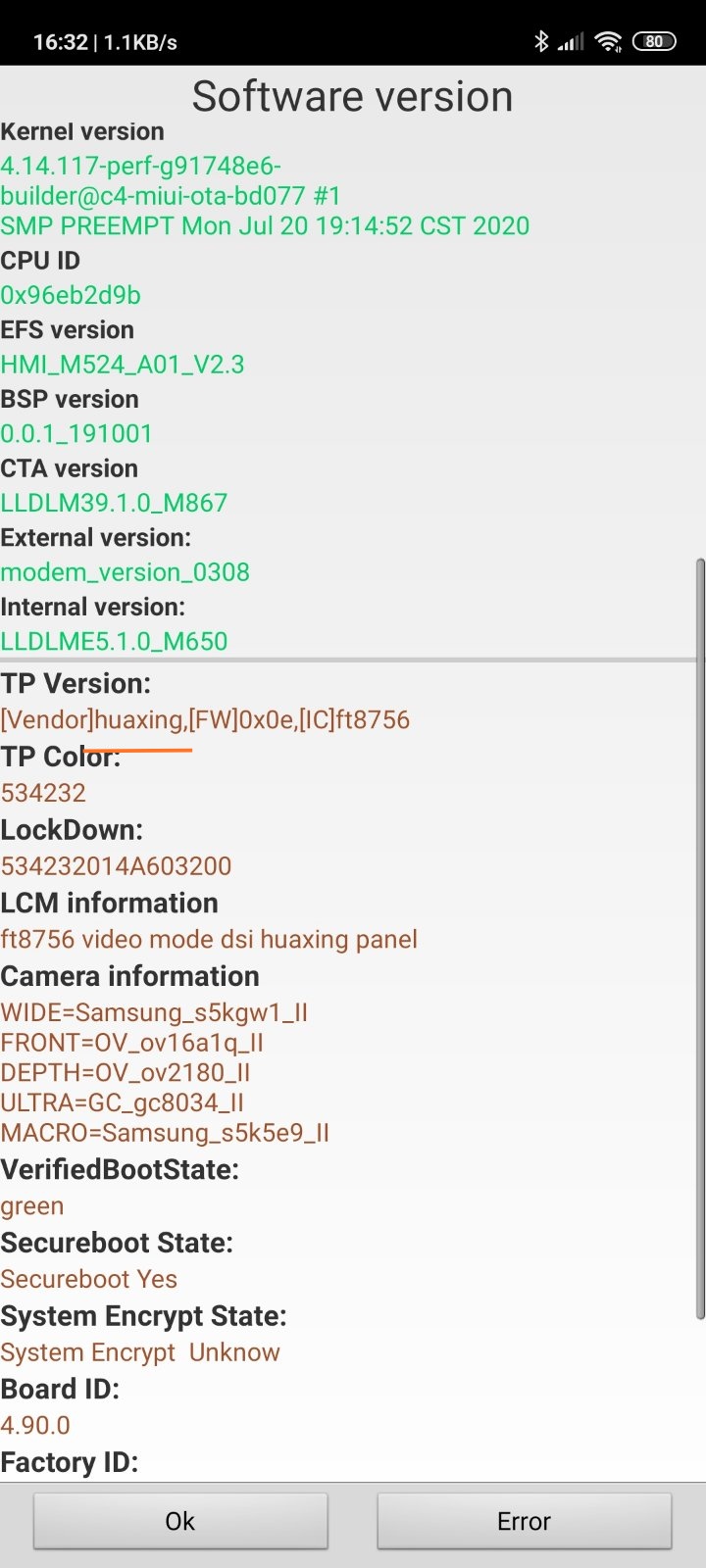

I understood what's the problem! Isn't caused by the wrong way of following the procedure and installation, but is simply linked to the panel adopted on your terminal.
This model (RN9P) uses two different panel versions: "Tianma" or "Huaxing".
My terminal has a "Tianma" panel and the bug is present. Can anyone else who has or does not have the "Swipe to unlock" problem tell me which panel their phone uses?
This is on my wife's Joyeuse. Everything works ok.
