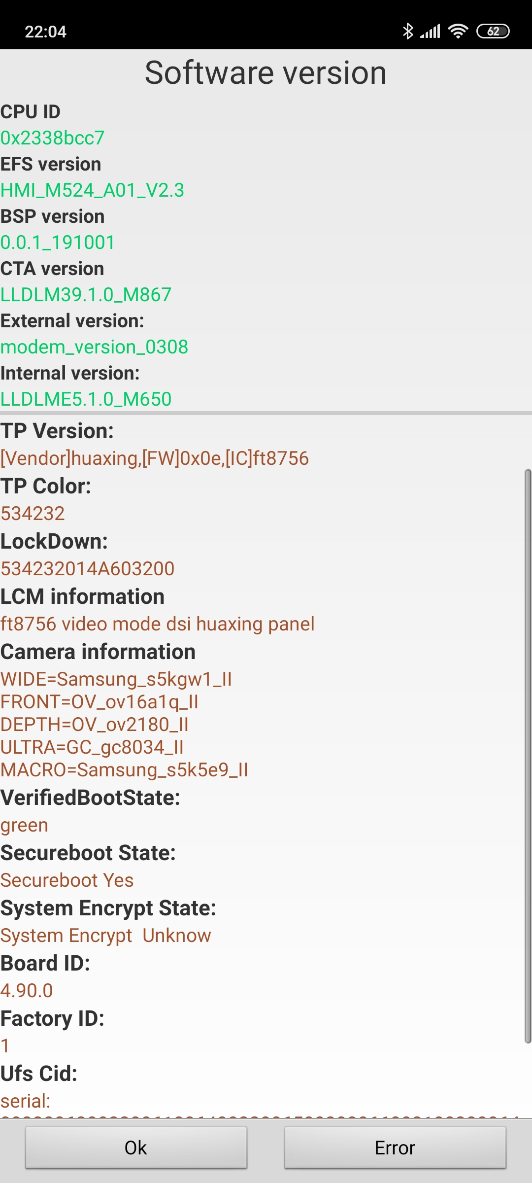

Delboy tell me name of this app, I will check type of my display. I haven't problem with Swipe.
Isn't an app, is integrated on the firmware. Go to info/kernel/tap 5 times, and enter on "software version". Scroll down and read to ""TP Version" or "LCM information"

If anyone still needs the info. My Display is Huaxing. As seen below:

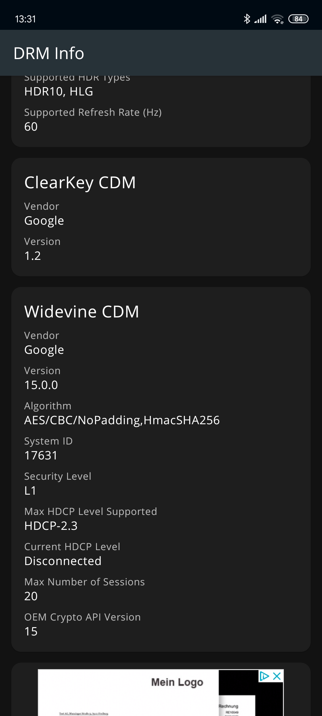

Good morning no I didn't flashed any persist.img file. Still on widevine L1.

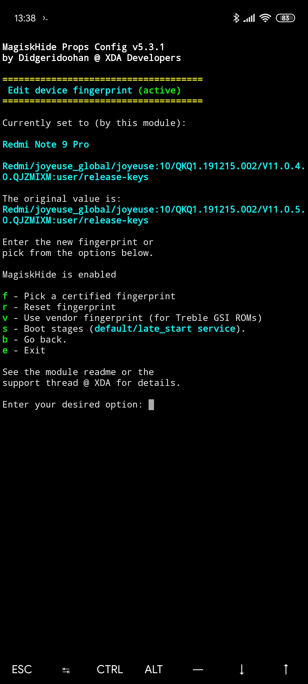

I installed the written Module via magisk and followed their tutorial. Easy and short:
Open any commandline app for android, in my case I used termux.
First typing "su"
Now "props"
Going through their easy menu step by step to choose a New ro.build.fingerprint from already working ones within the App.
A working one for Redmi Note 9 Pro (joyeuse) is already saved within the Module and can be easily choosen from a list.
Restarting the Phone and using magisk hide did the Trick then

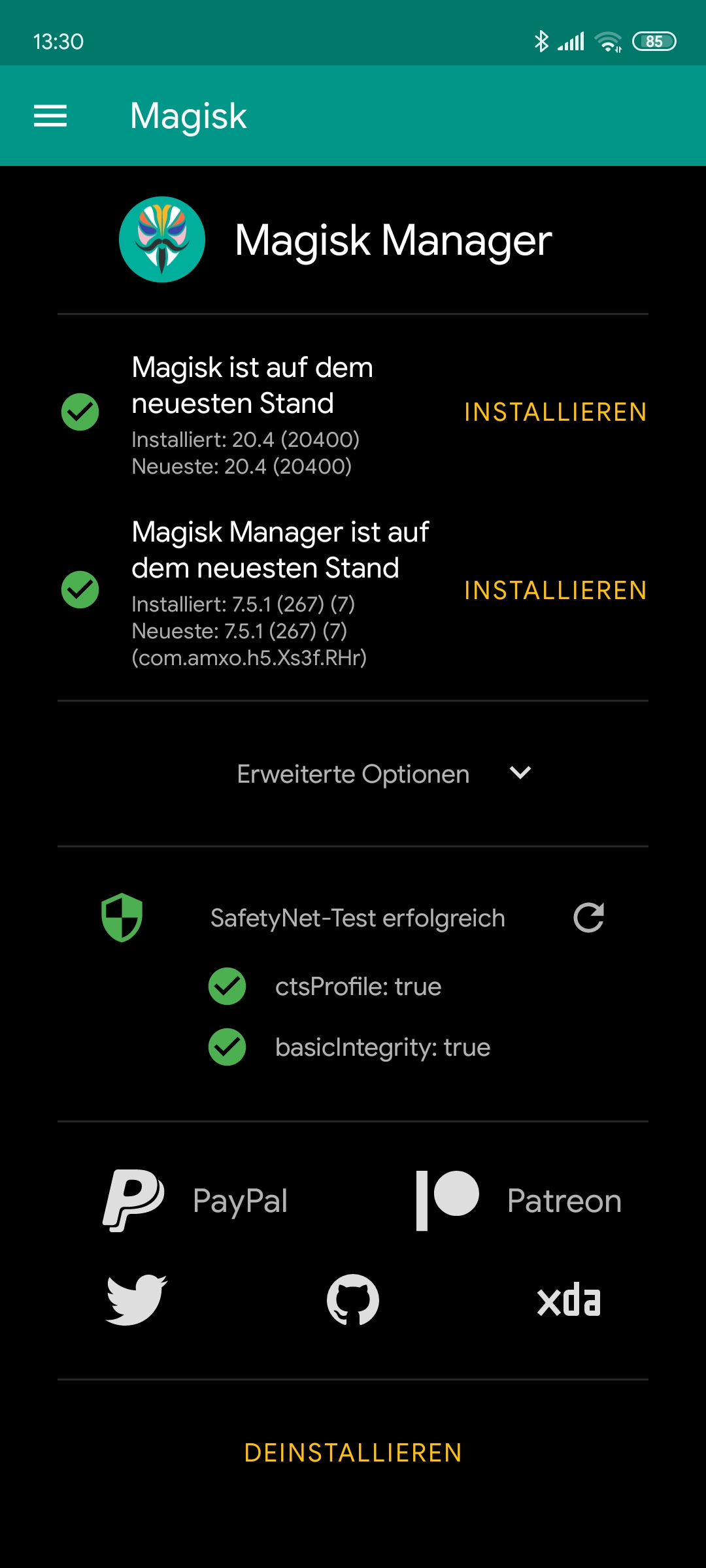

Just saw even if it's working already that magisk Shows Ctsprofile as false.
To fix that just use the mentioned magisk Module and after changing fingerprint click on the second Option aswell.

So to get working TWRP, xiaomi.eu Rom and magisk simply follow the OP.
Activate Magisk Hide and give Magisk a New package Name. Both can be done within magisk itself.
To have CTSProfile true and keeping Widevine L1 you have to install the following magisk module:
You can install this within magisk without Problems.
After that you have to download a commandline app. I personally installed termux:
After installing open termux and type in
su
and grant root permissions

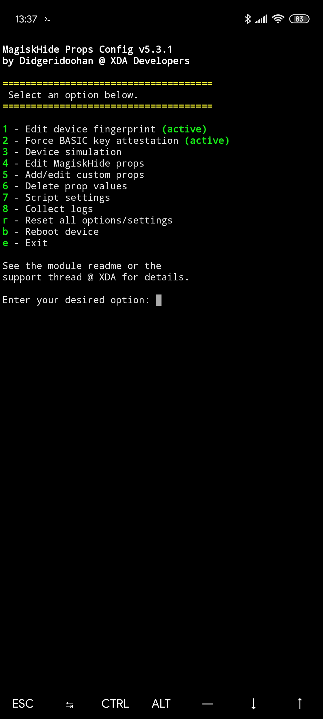

After that type
props
The following menu will show:

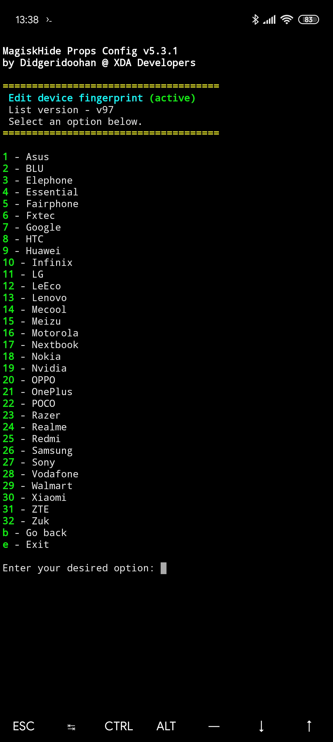

Type 1 and press enter
Type f and press enter

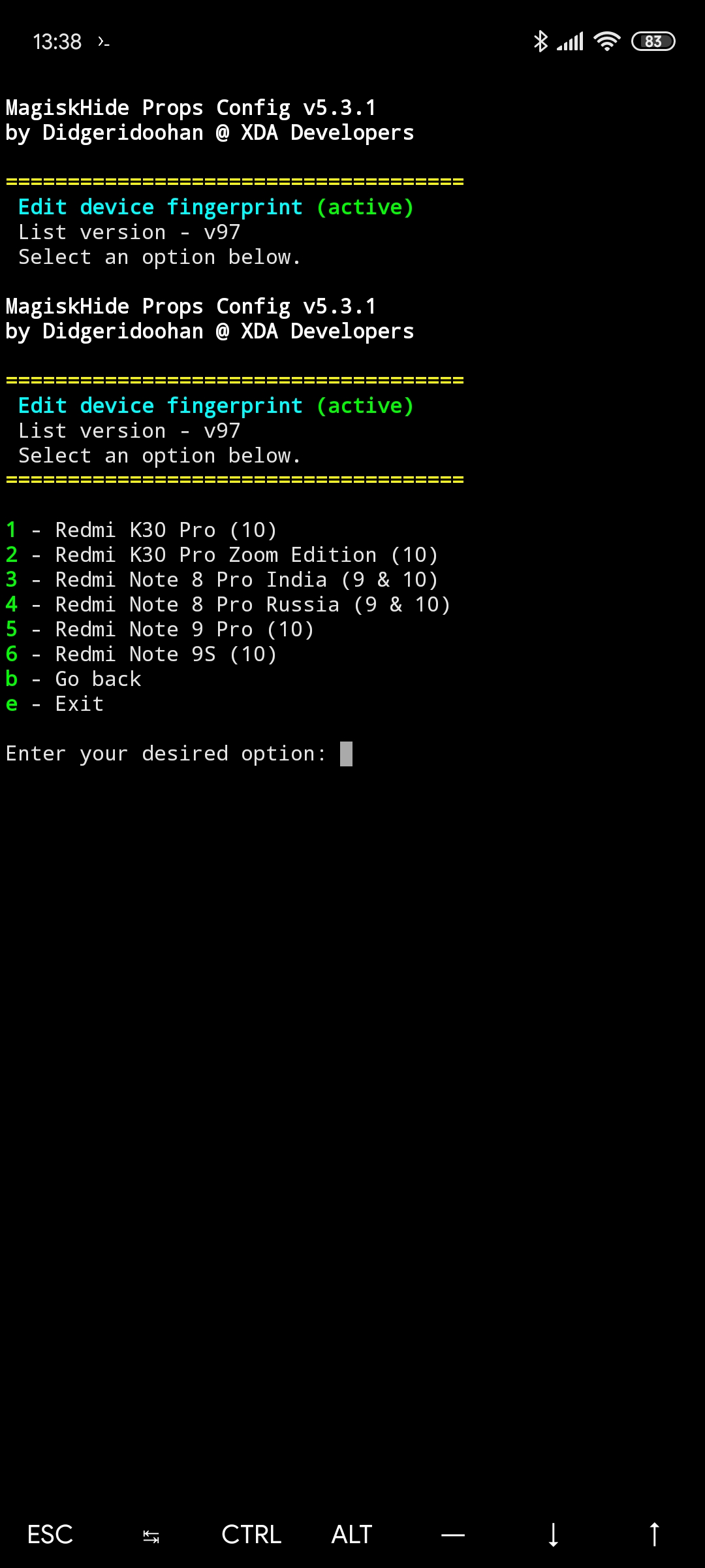

Choose Our Phone by typing 25 for redmi
And 5 for the Redmi Note 9 Pro
Finally type y to confirm the restart.

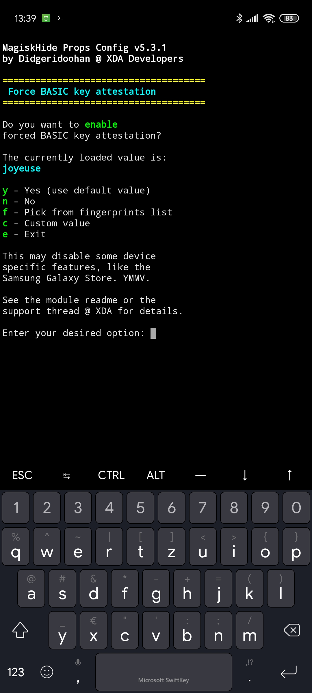

Again go into termux and grant root by typing su. After that type props and choose option 2
To enable force basic key attestation.
Confirm your Phone Model by typing y and restart again.
You are ready to go.

After that type
props
