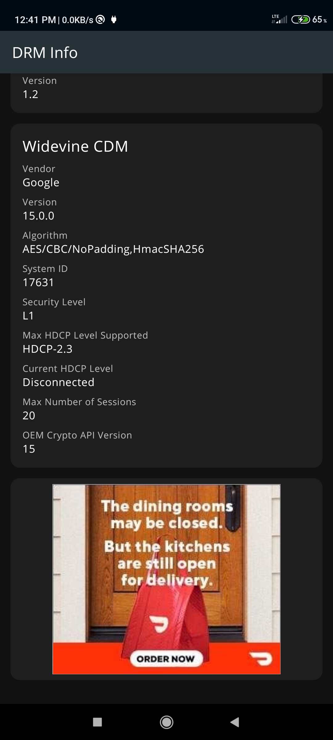

How can I detect a damaged CDM widevine?

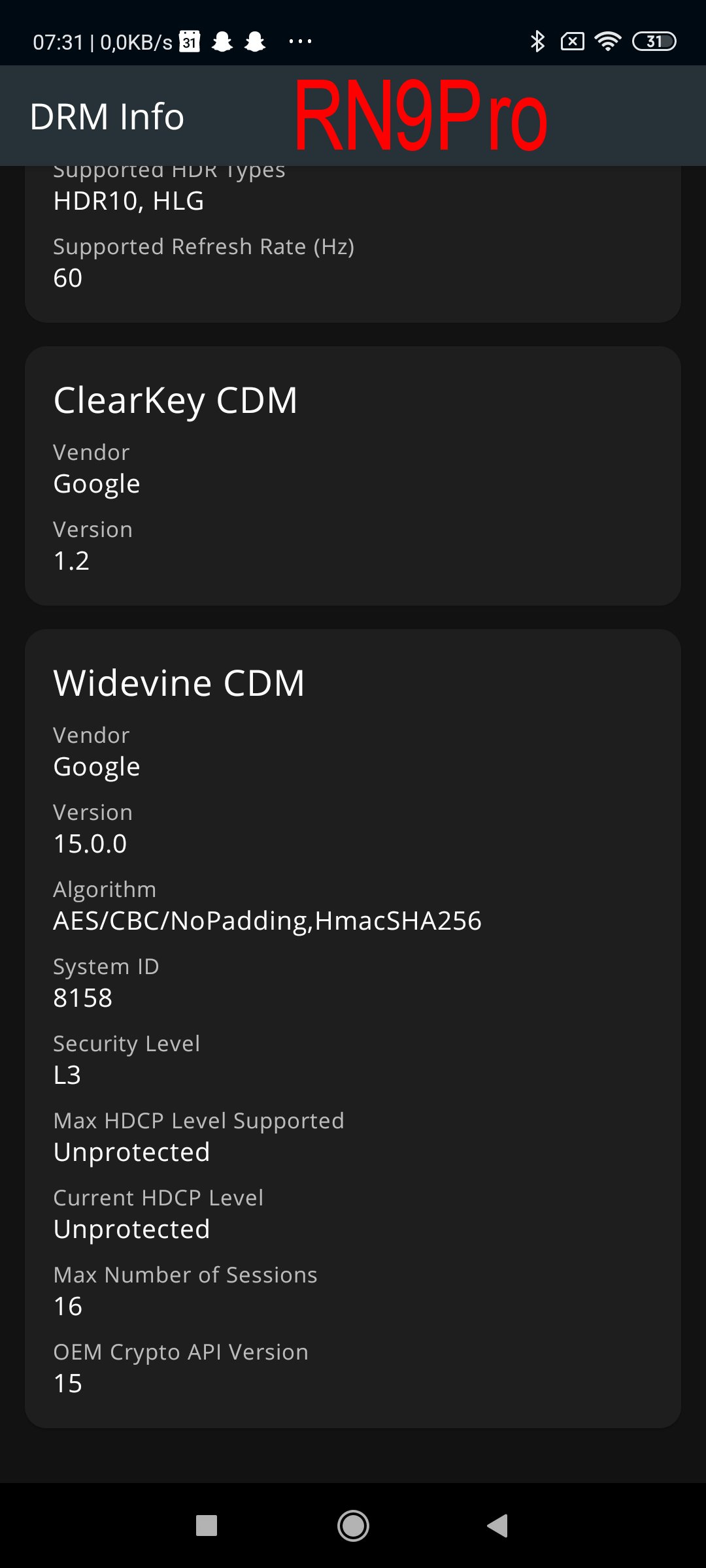

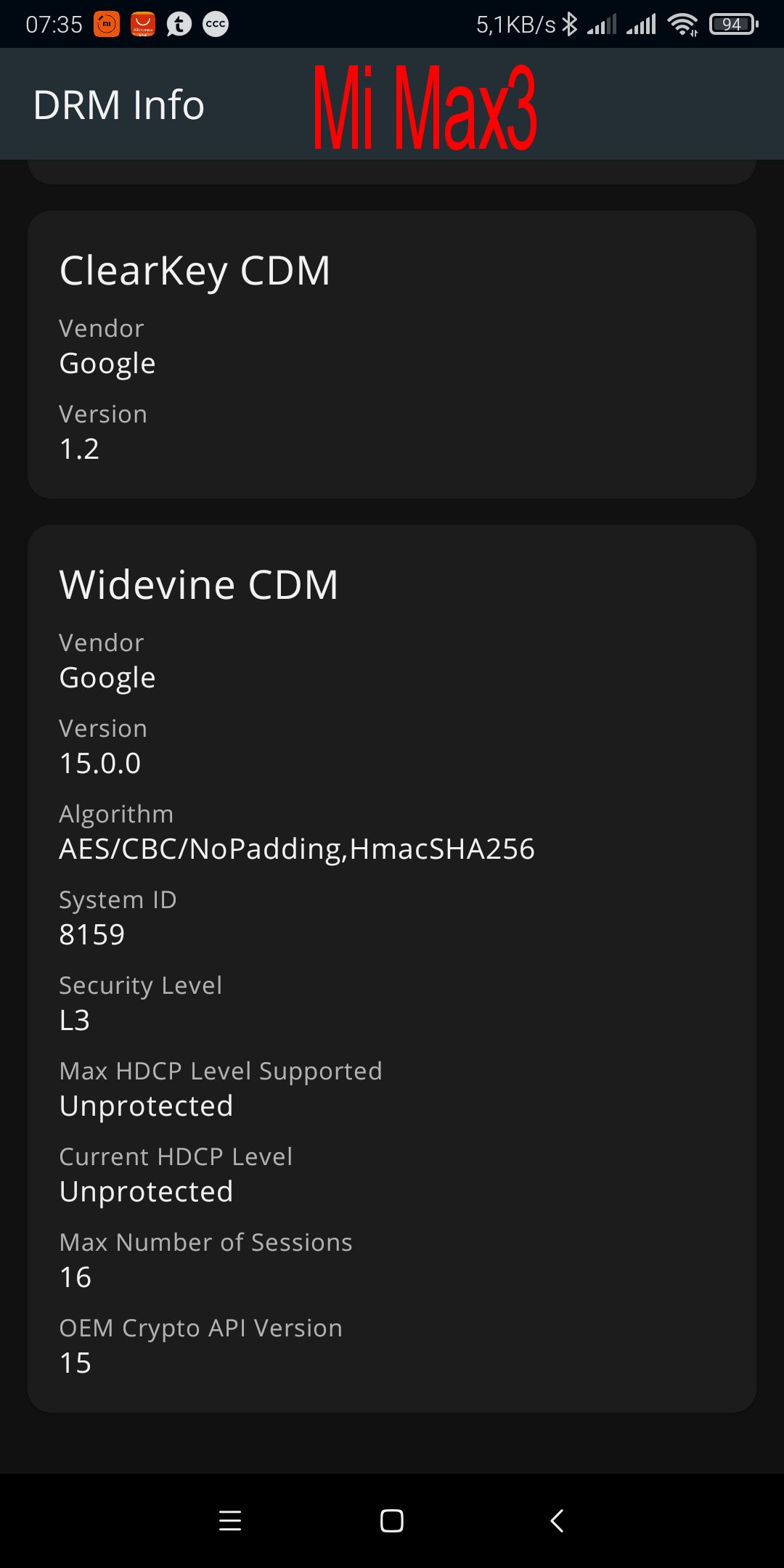

DRM Info on RN9Pro with replaced Persist.img shows the same things as on my second phone, Mi Max3, where I didn't overwrite Persist.img.
Both phones uses local ROM from this web.
It will show L1 instead of L3.

Well, that means that the L3 level was not caused by overwriting the Persist partition, but it's probably a matter of ROM itself, isn't it?
