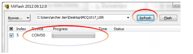

It's easy to save your dead phone with MiFlash. But I have to translate the Chinese guide to English...My god...
I suggest: First of all, connect your phone to your computer, and if the computer find new hardware"QHSUSB_DLOAD", install the driver, then open the MiFlash, and see whether there is device list on the panel, see the picture. If it is, you can flash it and save it.
If not, you should do the "short-circuit" ...

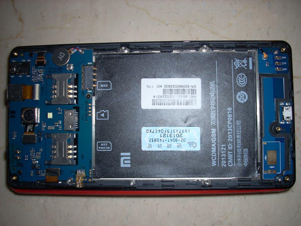

Hello everyone, I have the same problem but with a REDMI NOTE, I watched the pictures to make the connection but the REDMI NOTES is different and near to the contacts of the SIM there are no points where to connect the forceps as images
I removed the back to see if I found them but I have not seen anything that looks like, I include photos of the cell opened, someone can tell me if it is possible to do the same procedure with the REDMI NOTE?
Reactions: ollan
@kront75 If you can still enter the bootloader, you can try to press volup and voldown same time when powering on the phone.
If not it'll get complicated :p
@M1cha the phone shows no signs of life, if I connect it to the charger does not appear nothing, same thing with the pc ... is completely dead:confused:
mi2 is the only device with (known) test points. I guess ur mi4 is fully bricked now.
