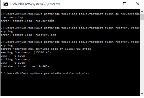

    i tried this tutorial but still cant flash twrp .
    but it looks like it went well but when i reboot its the same mi recovery

    I flashed TRWP recovery on my Redmi Note 2 Prime using this manual http://4pda.ru/forum/index.php?showtopic=684153&st=0#entry42646290
    You have to download trwp.zip, rename it to update.zip and place to internal ROM. Then go to standard update app and choose this file to install.
    Please let me know if you have any difficulties.

    Used mi recovery to flash a china dev rom, installed flashify to flash twrp 2.8.7 img. Then used twrp fir flashing any rom you like. But when you are going to flash the china stable rom, flashef superSU to root the phone first. Once your phone booted up, used any file explorer with root permission, go to system folder to rename recovery-from-boot.p to recovery-from-boot.bak else it with be back to mi recovery upon reboot.
