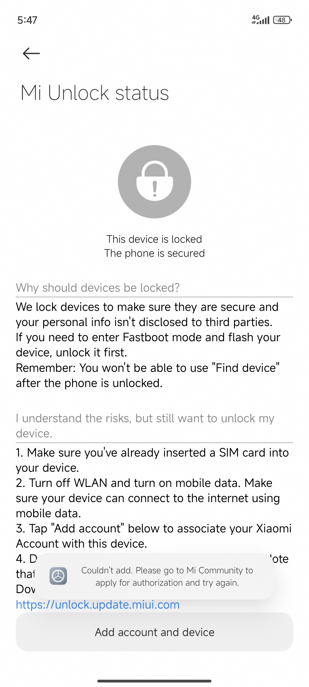

Hello, maybe i need your Help:
I bought the Xiaomi Mi 14 Ultra (Aurora) in China. Unfortunately I have the problem that I cannot unlock my device. I tried using the cell phone itself and the application for the PC, but unfortunately both don't work.
I would also like to install TWRP for the phone, but I can't find the file.
Can you please help me?
Read this, info also valid for Aurora
No TWRP at the moment, flash via fastboot
@djkerimofficial When you bought your device in China, you have most likely a chinese device and it seems like you didn't inform yourself beforehand. With a chinese device you cannot unlock the bootloader, unless you have a chinese Mi account level 5. Since I don't think you have, you have to look for a paid service.
In this forum are threads and posts about that which you can find with search function.
But in this thread your question is off topic.
Linked thread by @k3067e3 is for global devices, not for china devices.

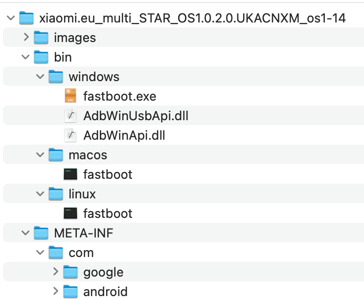

I have some problems with that.
I Downloaded "xiaomi.eu_multi_STAR_OS1.0.2.0.UKACNXM_os1-14.zip" on mac.
1) when trying to unpack - i have an "unsupported format error" (default unzip utility of mac)
2) when trying to unpack by Unarchiver - there is a warning "missing a part of archive", but it unpacks the archive
3) after 2) i have this folder
there is no "first_install_with_data_format" or "update_rom" scripts
4) tried to launch macos/fastboot - and, obviously:
Code:
.../bin/macos/fastboot ; exit;
fastboot: usage: no command
Saving session...
...copying shared history...
...saving history...truncating history fi
so it is just fastboot cmd file, like in adb tools.
i have a mi 11 pro, fastboot mode, replugged ("fastboot devices" shows it).
rom - miui 14.0.9.0.TKACNXM Stable by xiaomi.eu.
want to install latest stable hyperOS.
- do i need to install latest one of miui?
- what i am doing wrong?

Download again and check MD5 hash: 7582f079095b01750e656d40bcea70f7

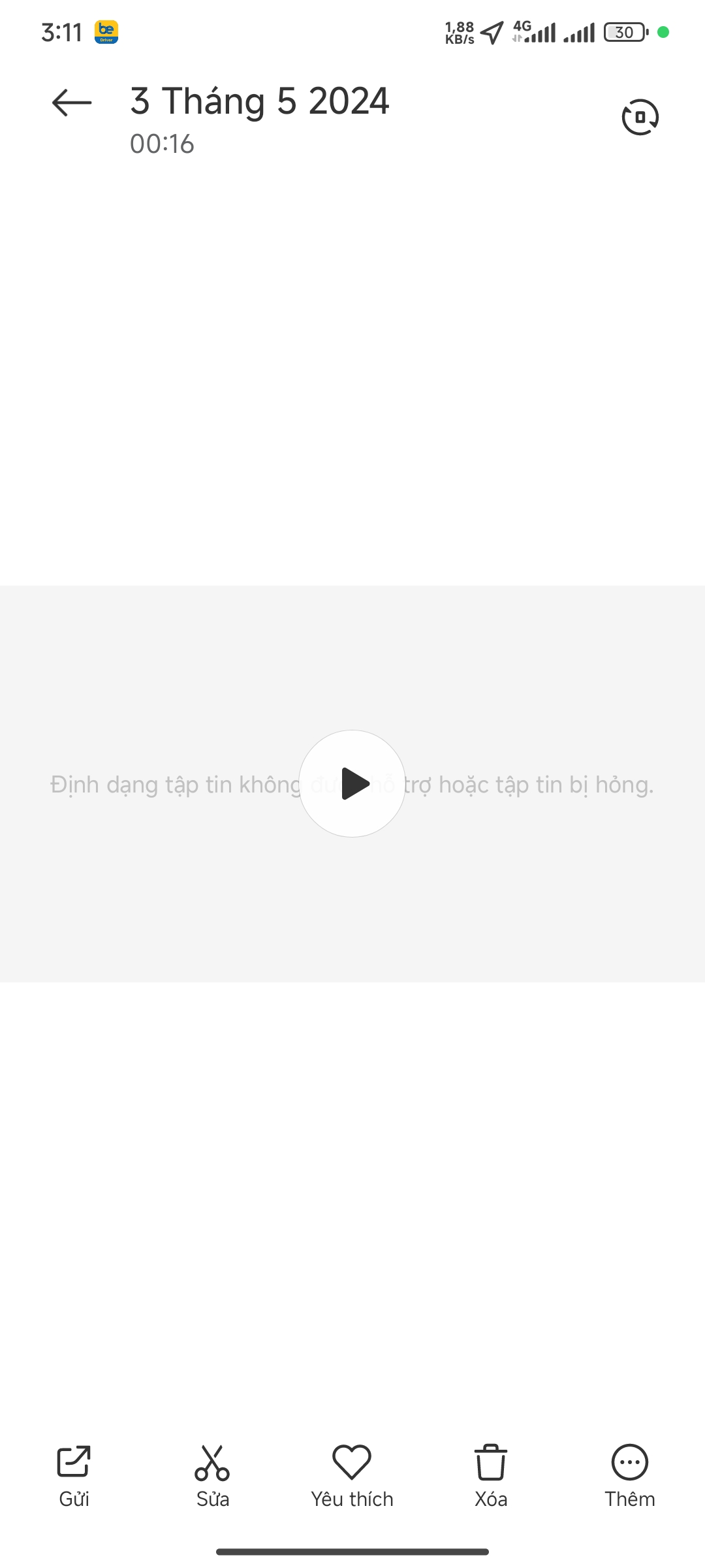

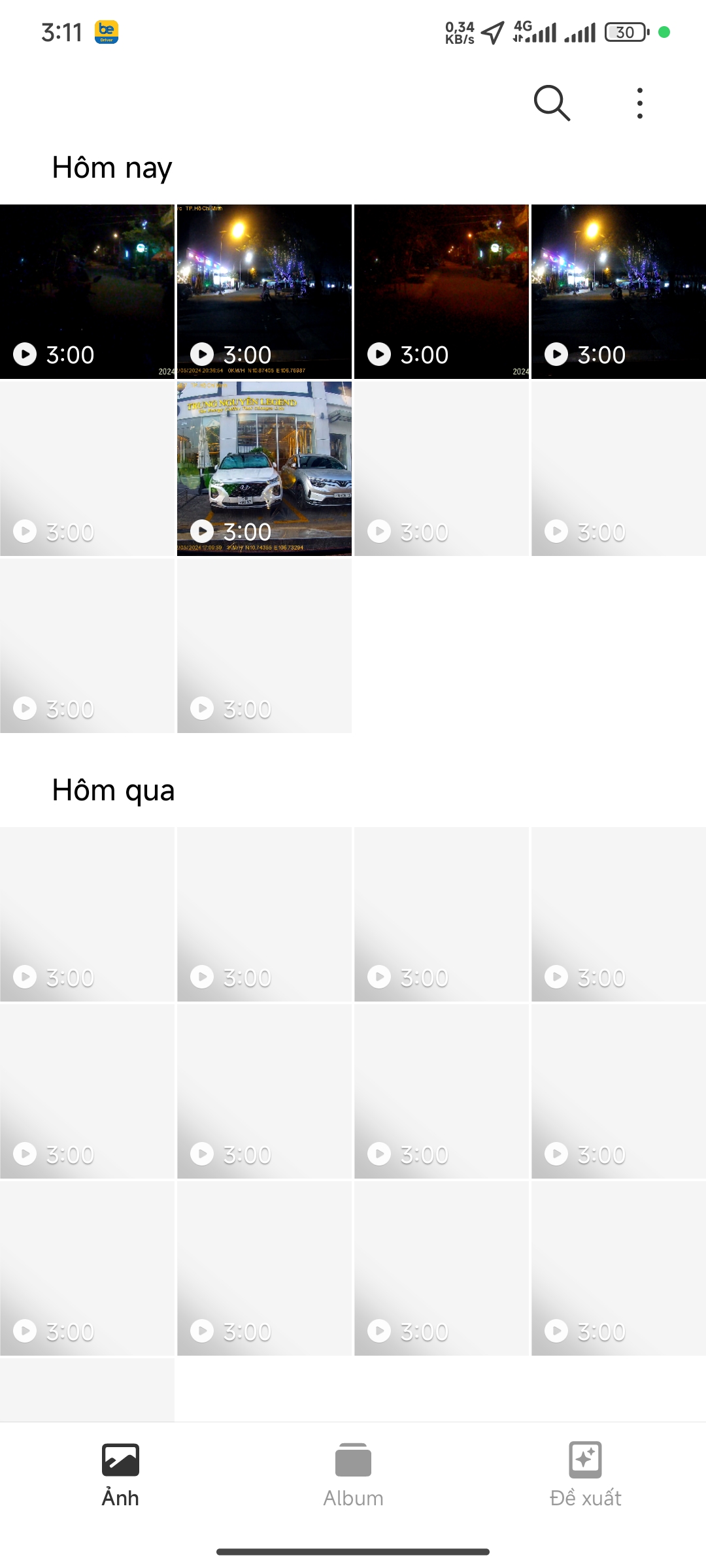

K40S/ Foco F4: This Problem when I insert the USB OTG into my phone, the gallery app puts pictures and videos on it and these cannot be deleted, if I try to delete it it appears again, the files APP It also has a problem when on the removable drive it doesn't display the exact date and time of the video. The dash cam from my car makes it really difficult to select the correct video to export.

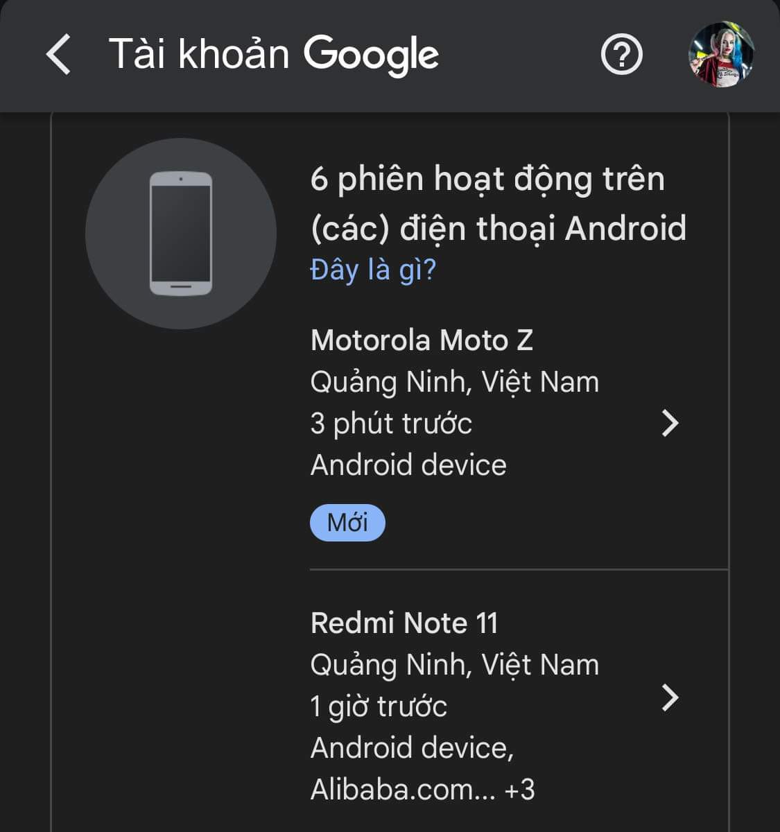

Hi. My device is redmi note 11 4/64 spes. Updated from Miui 14 EU to HyperOS EU completed
But when I add my google account, It shows in my active devices is "Motorola Moto Z"
Why not "Redmi Note 11" or same?
Hi. My device is redmi note 11 4/64 spes. Updated from Miui 14 to HyperOS rom EU completed
its for the phone to pass DEVICE_INTEGRITY
if it doesnt pass it, things like Netflix, Google Pay and certain Banking Apps stop working..
