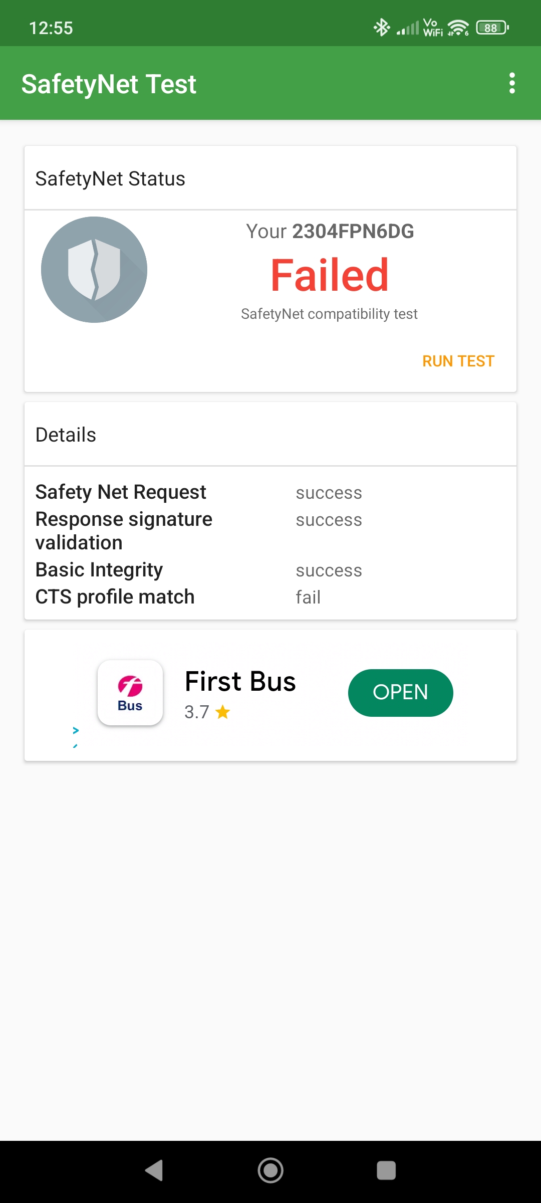

Get a copy of the ADB software development kit from the web, extract or place the files in a folder. Download the eea ROM, extract and then extract again and place the files and images folder in the same folder as before. Make sure the phone has unlocked bootloader, connect in fastboot ( power on vol down) and open the flash all bat file or flash all except storage bat file and wait untill it's finished and rebooted. You will see the progress in a CMD window if you done it right. DO NOT OPEN OR USE ANY BAT FILE WITH LOCK. You MUST NOT LOCK your bootloader on any non original region ROM or you may well brick it. Always, this is at your own risk, no comebacks on me. This how I flashed my 13Ultra from Stock Chinese to EEA.

Because the bootloader is unlocked and not hidden like the EU version, it fails CTS, so no cards from my bank can be added to Google wallet but the app works fine as does Google assistant.
I will use this ROM until a working EU version from the forum devs IS available, then swap to it. It's better than the Chinese stock but not as good as it can be when made by the Devs here.
