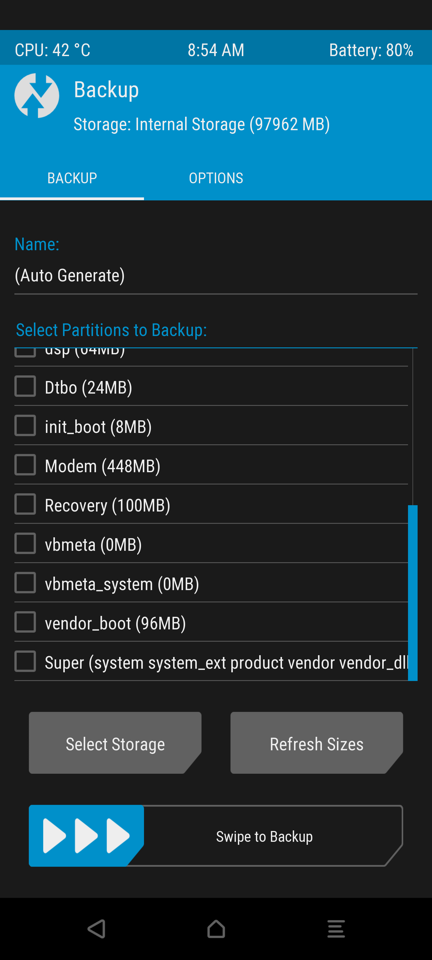

Ah I see. Yeah luckily I make incremental backups of my data anyway, via a sync between my phone and pc. So once my phone is set up well, it's fine enough actually. Though in this case, I already set up my friends new Xiaomi 13 Ultra, which took quite a bit of time, so I thought I'd just save myself some time by creating an image of my friend's phone.
Anyway, would you happen to know what this 'super partition' is called that I'd have to select in backup of TWRP?
Thanks again so much! ☺️
In my 13U it's just called "super" at the end of the list, see attached screenshot

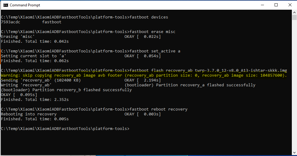

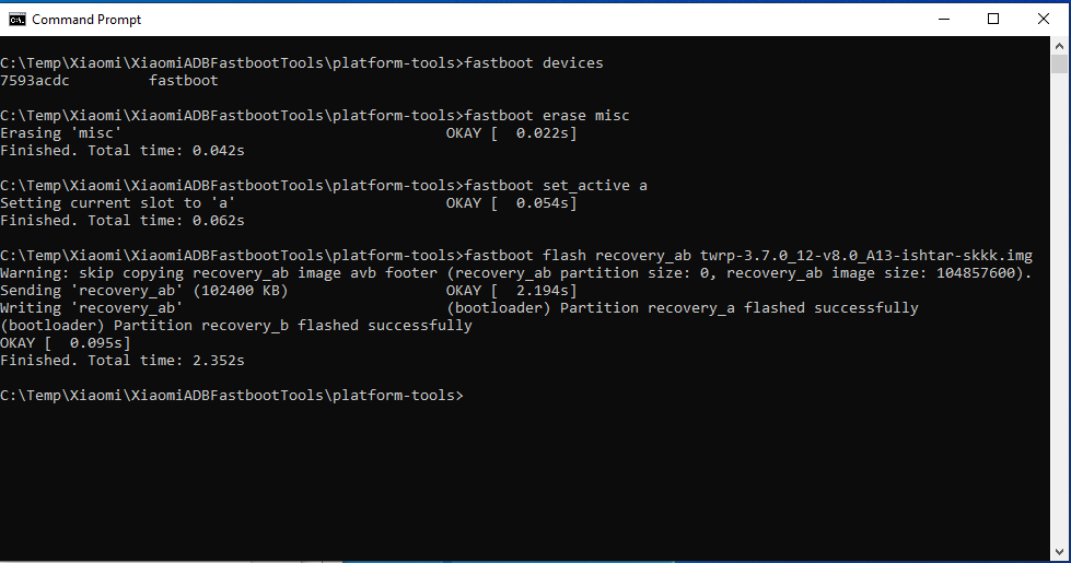

Hi All,
Some help please :emoji_pray:. I am install TWRP on my ultra 13 and it appears to go ok, but when I reboot goes back to stock fastboot screen. Is that highlighted line a problem ? Phone is in bootloop mode now :(

Do not flash ab devices, boot recovery. Hope it helps
fastboot boot recovery.img
This why.
Devices with Dedicated Recovery Partitions (A/B):These devices have dedicated "recovery_a" and "recovery_b" partitions.The custom recovery image can be flashed to "recovery_a" and "recovery_b" partitions directly.Flashing to "recovery_ab" will flash to both "recovery_a" and "recovery_b" with a single command.The custom recovery will persist across ROM updates.Platforms: Snapdragon 685, 7/7+/8/8+ Gen 1/2Devices: cupid, diting, fuxi, ingres, ishtar, marble(in), mayfly, mondrian, nuwa, socrates, tapas/topaz, thor, unicorn, zeus, ziyiImage size: 100 MiB (104,857,600 bytes)Installation:Code:
fastboot flash recovery_ab recovery.img
fastboot reboot recovery
Never try to "fastboot boot" these images. If you do that, you will get a "Bad Buffer Size" error and your device will be stuck in fastboot mode.To get out of being stuck in fastboot mode, run these commands:Code:
fastboot erase misc
fastboot set_active a
Then install the recovery correctly.Devices with Boot as Recovery (A/B):These devices don't have a dedicated partition for recovery.The recovery ramdisk resides in the "boot_a" and "boot_b" partitions.A shared kernel is used for both the system and the recovery.Due to that, you should never flash a custom recovery image directly to the "boot_a" and/or "boot_b" partitions. If you do that, the system will fail to boot.Platforms: Snapdragon 678/680/695/778G/778G+/780G/870/888/888+Devices: alioth, haydn, lisa, mona, moonstone, munch, odin, psyche, redwood(in), renoir, spes(n), star/mars, sunny, sunstone, taoyao, thyme, venus, veux/peux, viliImage size: 192 MiB (201,326,592 bytes), or 96/128 MiB (100,663,296/134,217,728 bytes) for low-mid devicesInstallation:
Code:
In the recovery interface: Advanced -> Install Recovery Ramdisk
