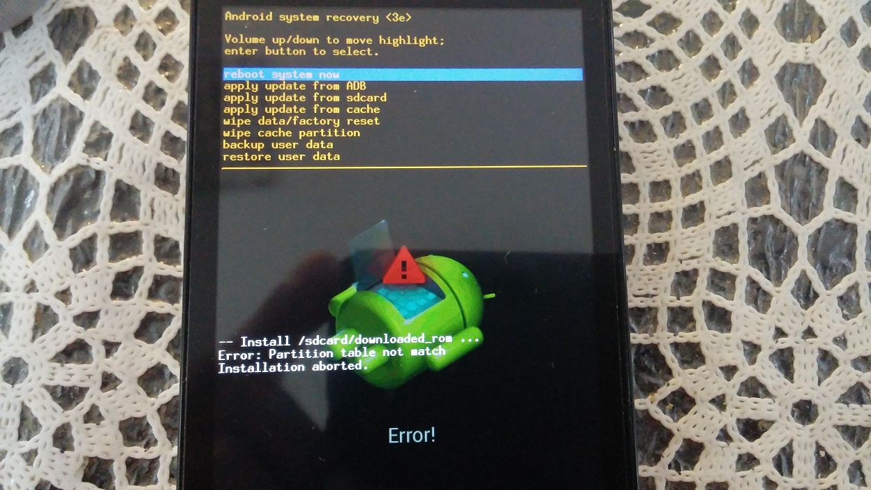

Please Help can not install any rom,
Reactions: chefsunter
