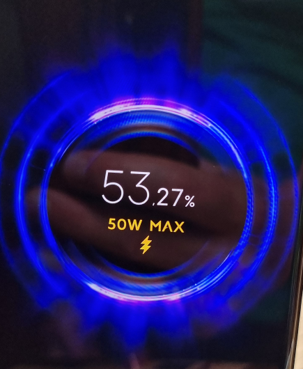

No, I'm on Xiaomi.EU weekly - what I see on the 55W Xiaomi Wireless Charger is this (strangely enough also not 55W. but its still pretty fast ;) )....
