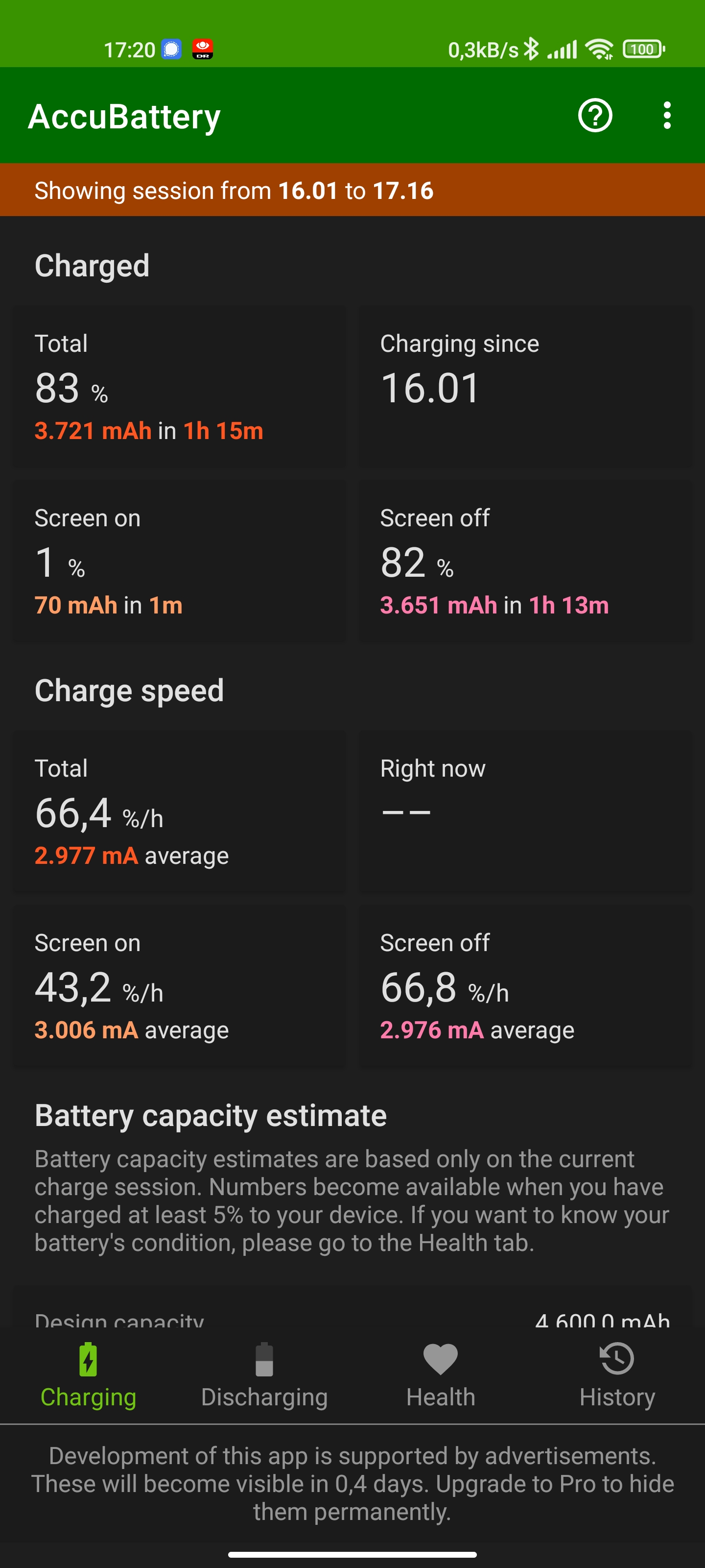

Here is the results:
Charged 83% in 1h 15m, avg. 2977mA, without cover.
The phone stood in the charger during the whole period. I've only used it a couple times for 2FA approvals, while keeping it in the charger.
For good measure the specs one more time:
- Mi 11
- 67W GaN Xiaomi charger + included cable
- Xiaomi 55W wireless vertical charger
- Mi 11

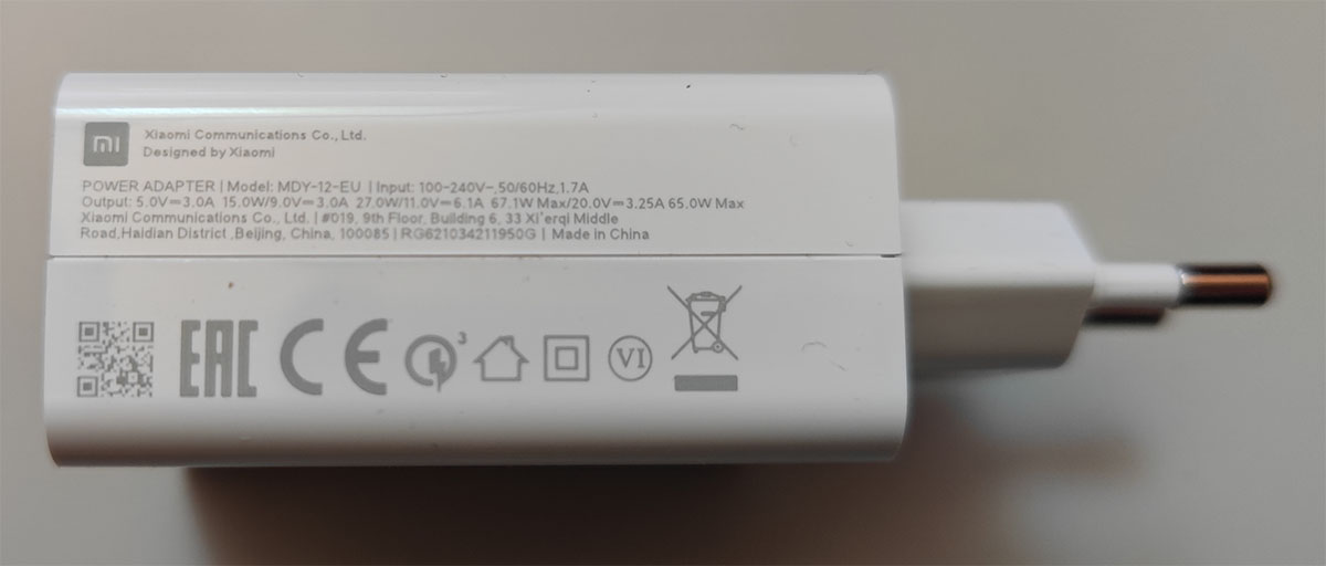

I assume your charger has a problem. You should change to another charger. Yesterday I tried to charge Mi11Pro with 55W charger (Mi11's) and it took me 50 minutes to fully charge the battery (15-100%)
You mean the wall adapter that came with the mi 11? Is that strong enough to power the wireless charger?
That right. I assume your wall charger has a problem. If you are afraid that the 55W charger is not enough power for the wireless charging dock (50W), you use the 120W charger. But I think you should change another 67W charger.

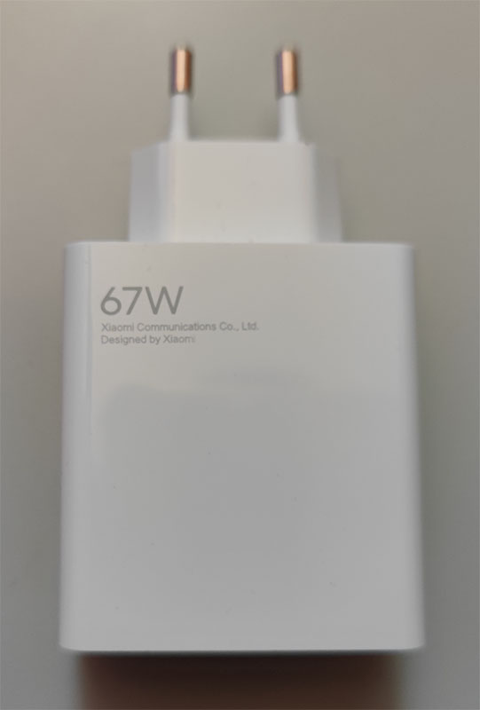

Also, can you take a detailed picture of your charger (wall pin) for me to see? I have seen a lot of fake chargers but still got Mi Turbor :D
It's bought from one of the bigger danish electronicstores, I'm pretty sure this isn't a fake. Google Xiaomi 67W GaN. It's one of their newest.
I'm not gonna test with the included adapter, as I've just got my mi 11 back from a charging issue which occured after using the included adapter with the wireless charger. If anything should be a fake, my bet is on the wireless charger as that is bought via ebay. I'm gonna upload pictures of both the dock and the adapter tomorrow.

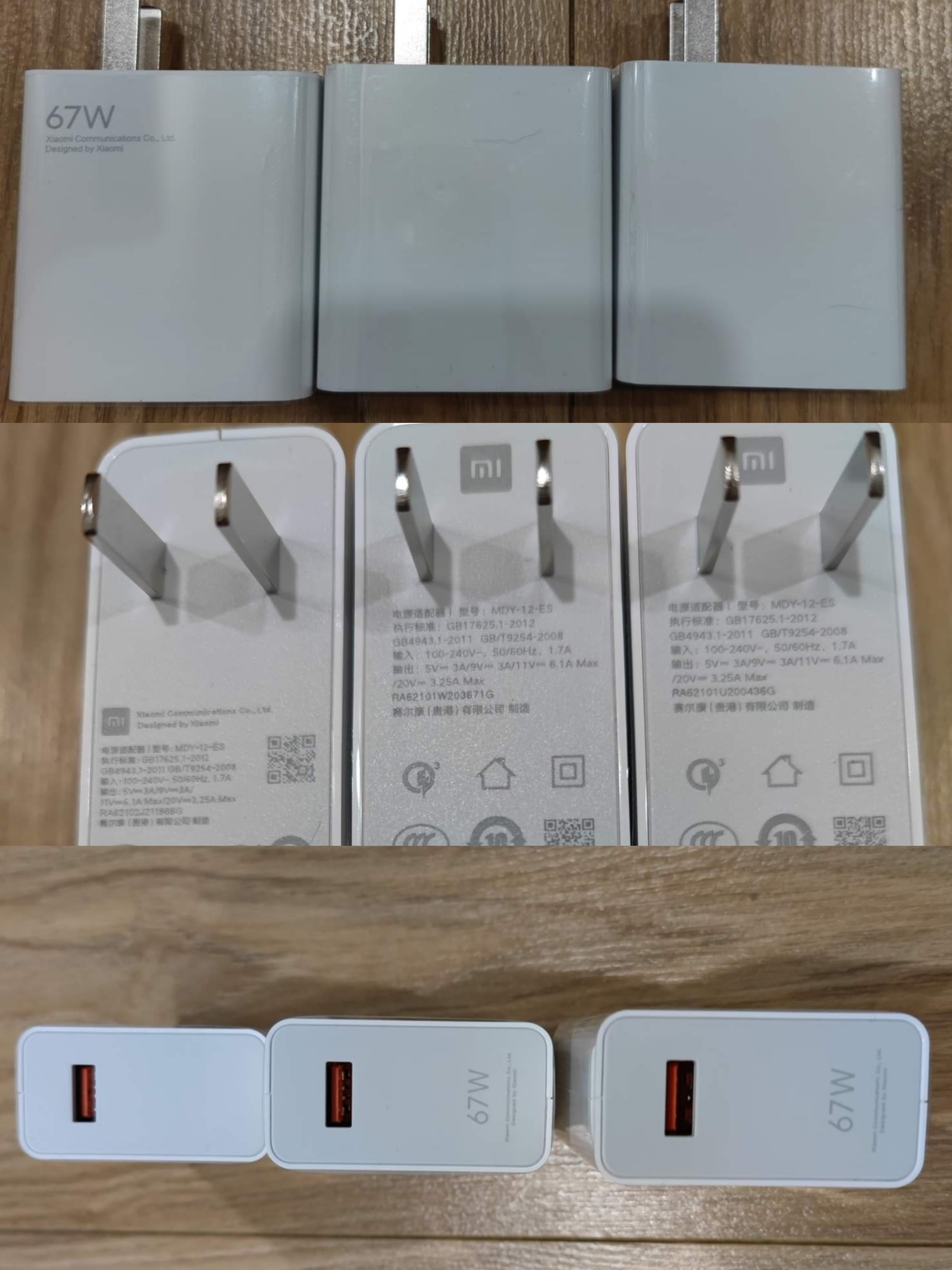

These 3 chargers are all 67W chargers that come with Mi11Pro. :)
Apparently the pictures were too big to be uploaded here. Here's an imgur album:
Fixed.
I've been saying 67W this whole time, It's the 65W model, my apologies.
Note: the 65W charger, charges fine directly via USB-C (around 9000-9500mAh)
