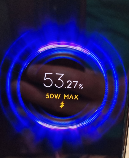

On the picture is wireless charging on Mi11Ultra. For Mi11pro / Ultra, both support wireless charging up to 67W. To use the 67W charging capacity, you must use the 80W wireless charger with the 120W charger (the full Xiaomi wireless charger will be included)
This is device (Mi11Pro - xiaomi.eu rom)

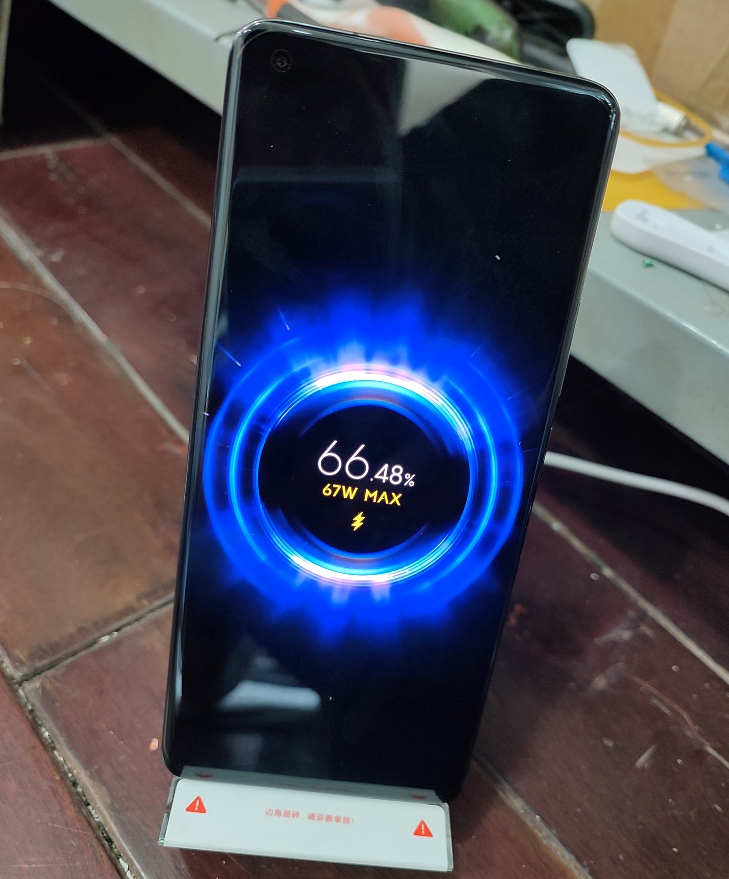

No, I'm on Xiaomi.EU weekly - what I see on the 55W Xiaomi Wireless Charger is this (strangely enough also not 55W. but its still pretty fast ;) )....
37772
Reactions: nicolajkl

Okay Folks, here are the result for Venus:
Charger
Wireless:
Wired:
I need to upgrade the Rom it's still from March on this device. So the 50 Watt Max ist not yet in the Rom (latest battery management)
Regards
Sent from my Mi 11 Ultra.
