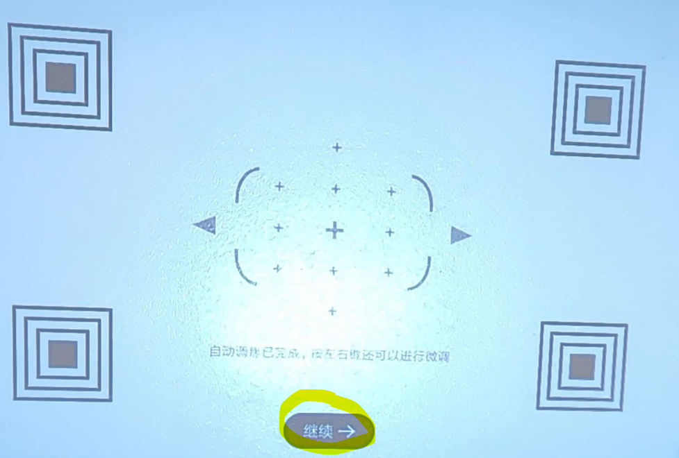

Hello community,
I have a xiaomi smart projector 2 (chinese version fengmi without its remote) and i am unable to pair it with my mi box tv remote.
So i tried installing keyboard apps on my phone to pass the focus validation scrren with no luck so far (as suggested by @sham80 here https://xiaomi.eu/community/threads...nt-pair-with-the-projector.55305/#post-627258). When pressing TAB the continue button is selected but i can't select it. Do you guys can help on this to pass the focus adjustment screen ?
Thanks a lot
Same issue here for those having it. No solution so far :(:
Hi gyus,
I just figured it out !
You just need to install a bluetooth keyboard on your phone and use its numeric pad:
8 is UP
2 is DOWN
6 is LEFT
4 is RIGHT
and...
5 is CLICK
Hope this will help others
