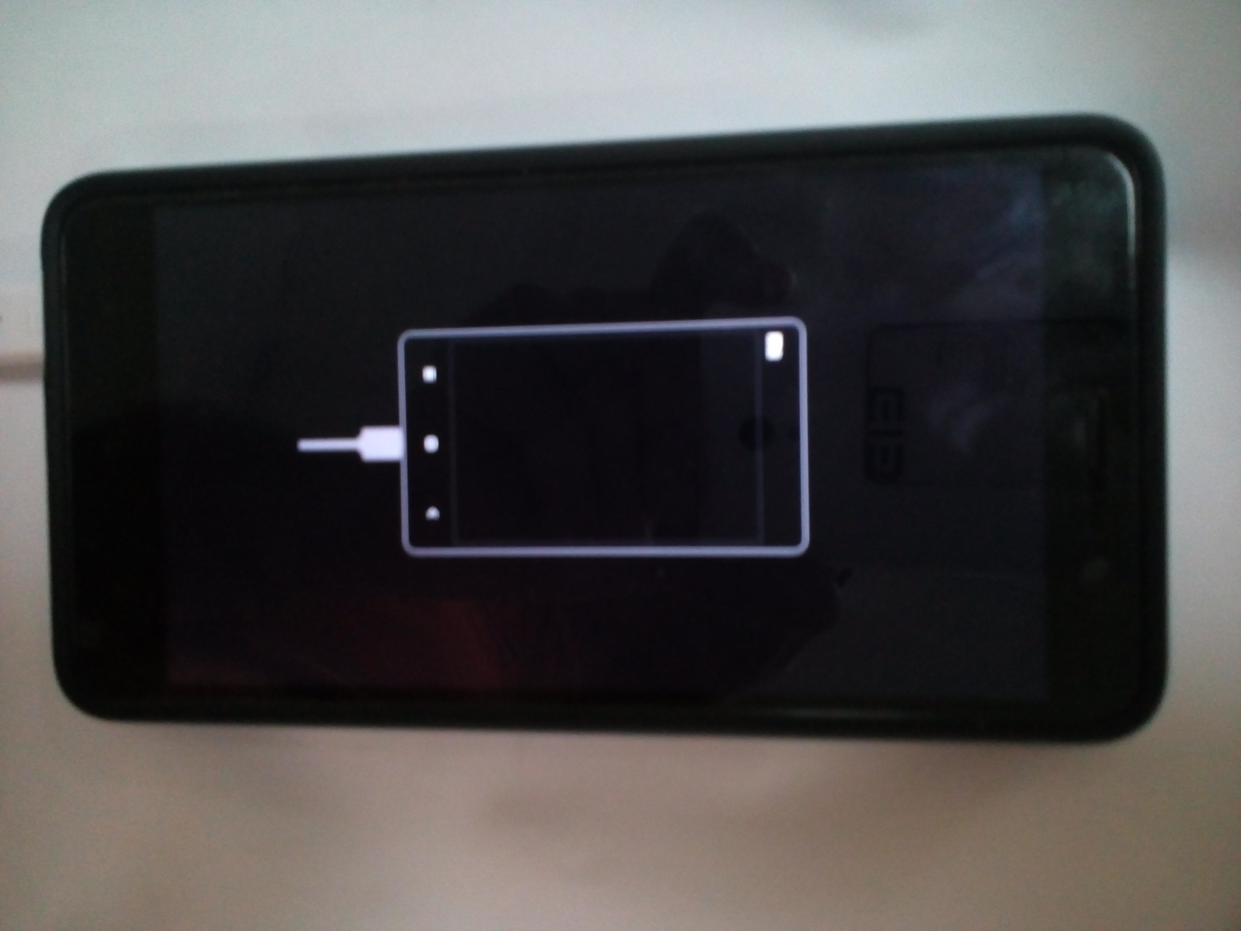

Thank you for the update! I proceed like below and at recovery boot (power + vol up) appear a phone design which show me when the phone is plugged in. This is normal?

I read somewhere to "Boot your Phone to Recovery Mode (Power + volume up)" ! If I am doing this, appear a phone picture which show me if the phone is plugged in or not! See the picture !

I read somewhere to "Boot your Phone to Recovery Mode (Power + volume up)" ! If I am doing this, appear a phone picture which show me if the phone is plugged in or not! See the picture !View attachment 12933
No it's wrong this phone with plugged in. You have to see this: https://www.google.it/search?q=miui...hVBnCwKHcJpAqwQ_AUIBigB#imgrc=GbjNdErMrRwyHM:

I writing fastboot flash recovery twrp.img. Same result ! The phone icon when I reboot in recovery mode.

I don't know how to help you, You must know how to do those things if you buy a xiaomi phone. I've installed twrp and rom on Mi4, Redmi note 3 MTK and PRO version too, but I got no issues.
These are the full instructions, see if you've missed a step:
Put the phone in fastboot mode (volume down + power)
Download adb drivers
Download twrp from twrp.me
Copy the twrp .img file to the same adb folder where you have fastboot.exe
Rename the image file to twrp.img
Shift + right click in that folder and select open command window here
Command: fastboot flash recovery twrp.img
When the flashing is finished, command: fastboot reboot
IT IS IMPORTANT TO HOLD VOLUME UP + POWER WHILE BOOTING
Phone should boot to recovery (twrp)
Thank you ! This was the issue! After "fastboot reboot " need to keep vol+ and power pressed !
