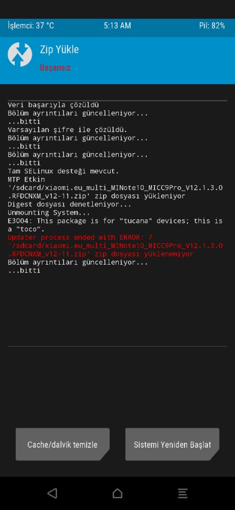

mi note 10 lite twrp version twrp-3.4.0-14-toco i downloaded xiaomi.eu_multi_MINote10LITE_V11.0.8.0.QFNMIXM_v11-10 magısk 21.2 but it gives this error
can you help me thank you

You are installing wrong rom for your device
You are installing tucana (Xiaomi Mi Note10 / CC9 Pro) instead of toco (Mi Note 10 Lite)
