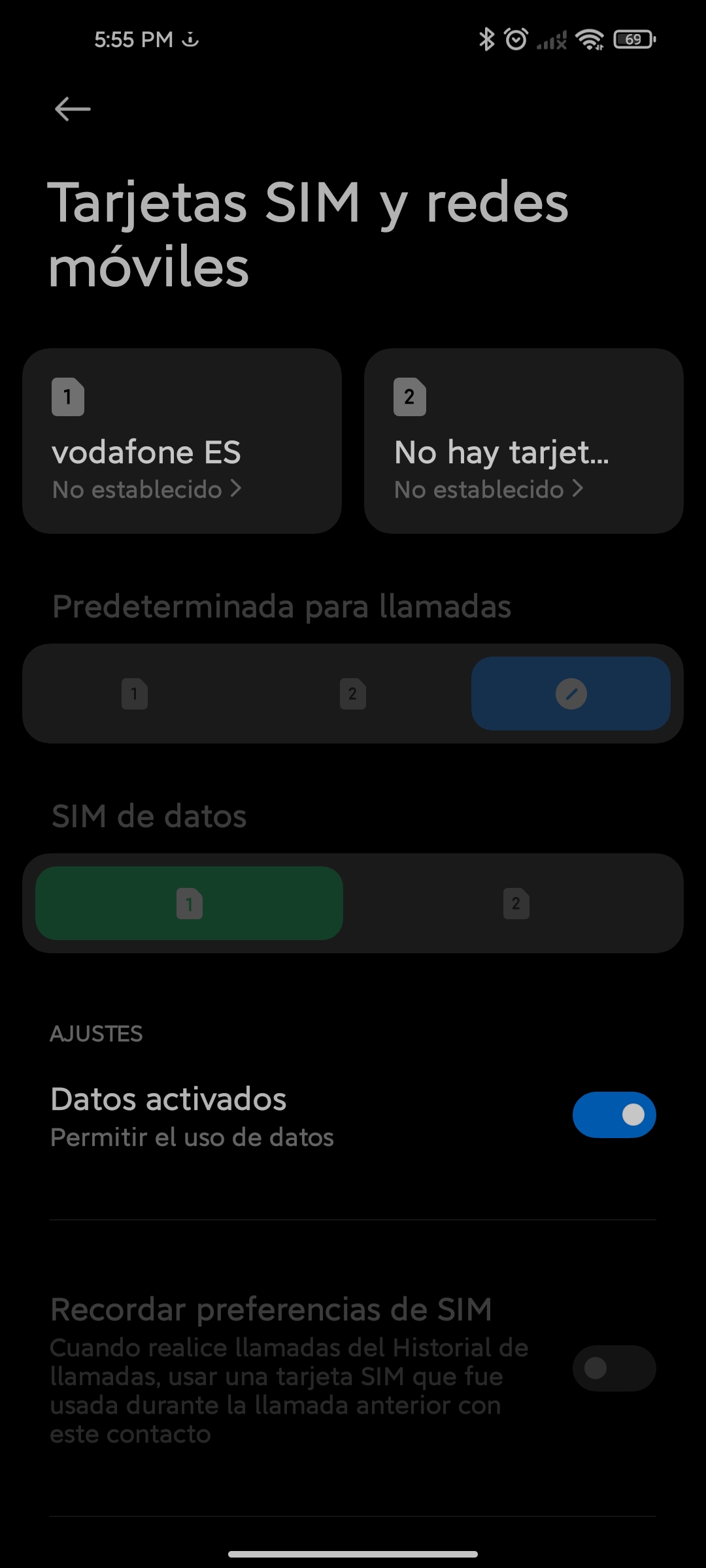

No network connection after flash. I tried a couple of flash, wipes and write apn again with no success.
Recognices sim but does not ask por pin code.
35501

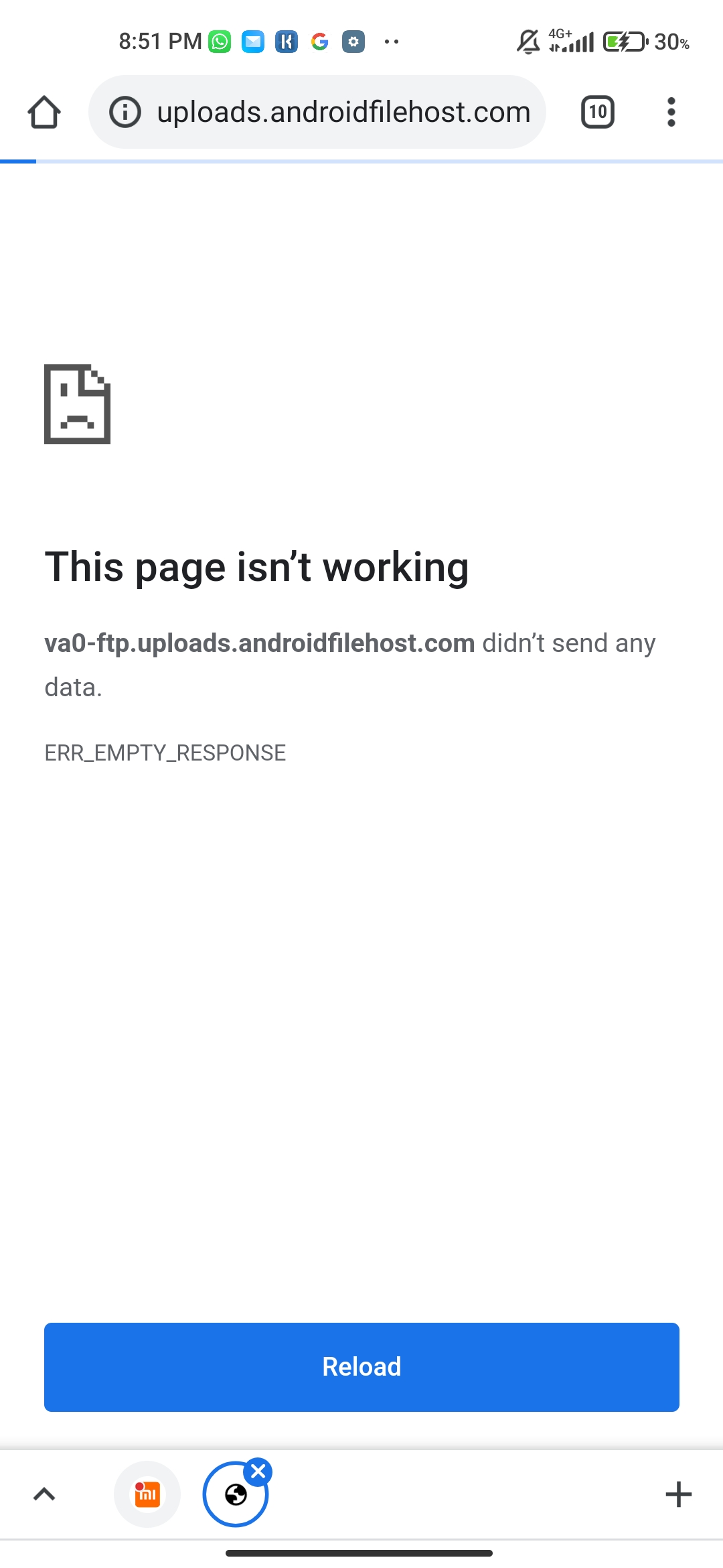

Why I can't see the update and download it for mi 10 ultra!
