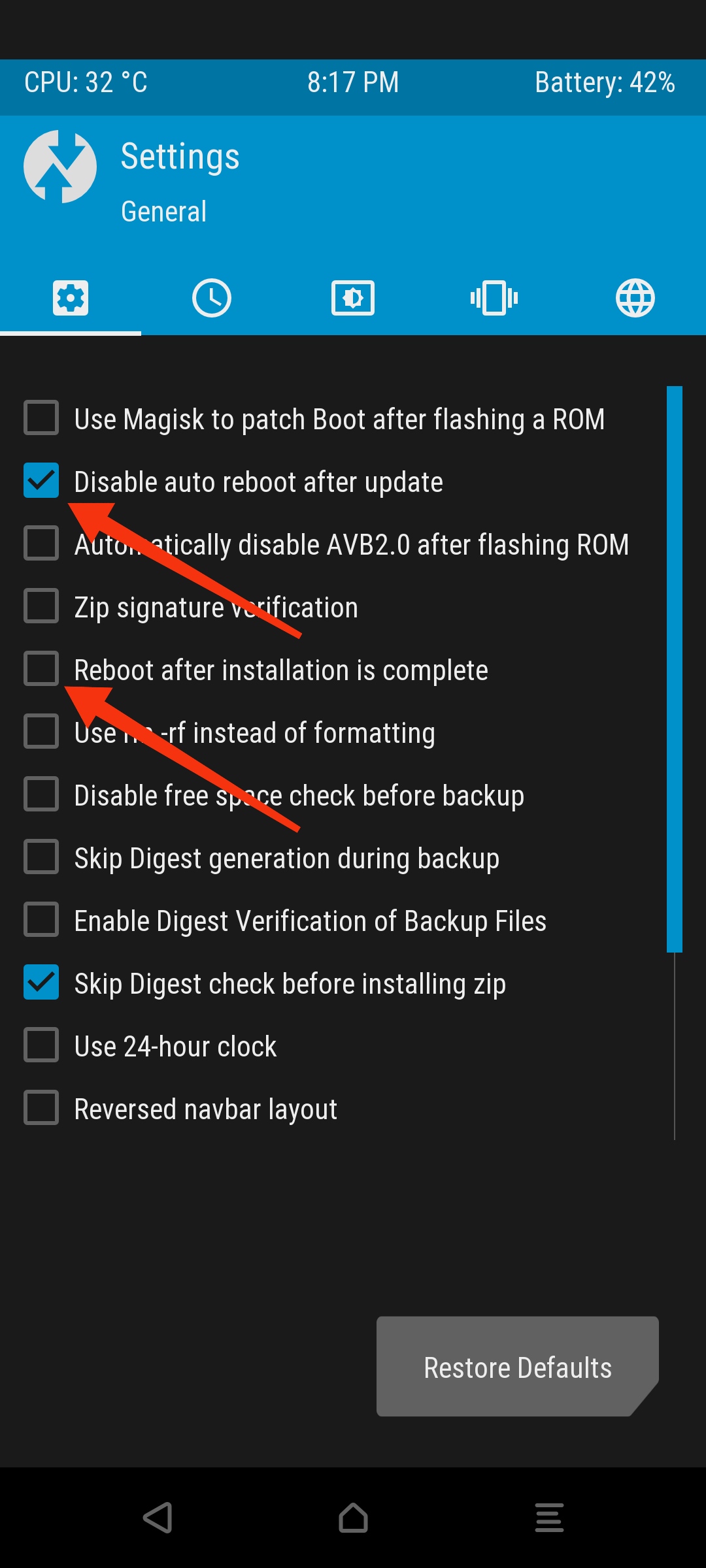

After each update in the TWRP step the automatic installation does not restart when finished. - Report
I'm running the TWRP SKKK from MIUI.eu's script and I noticed now that the option "disable auto reboot after updated" is selected by default. (annex)
What is the correct configuration to restart at the end? I would like to test it in the next update.
Regards,

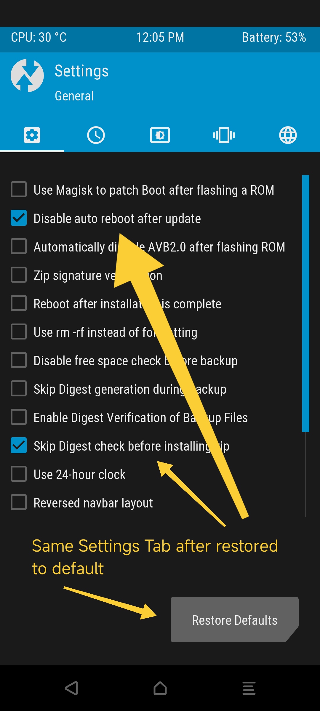

I did it just after you asked to do and confirm now that previous Settings Tab is the TWRP SKKK Default configuration. (annex)
What's the recommended options to select and/or deselect to run MIUI.eu install script?

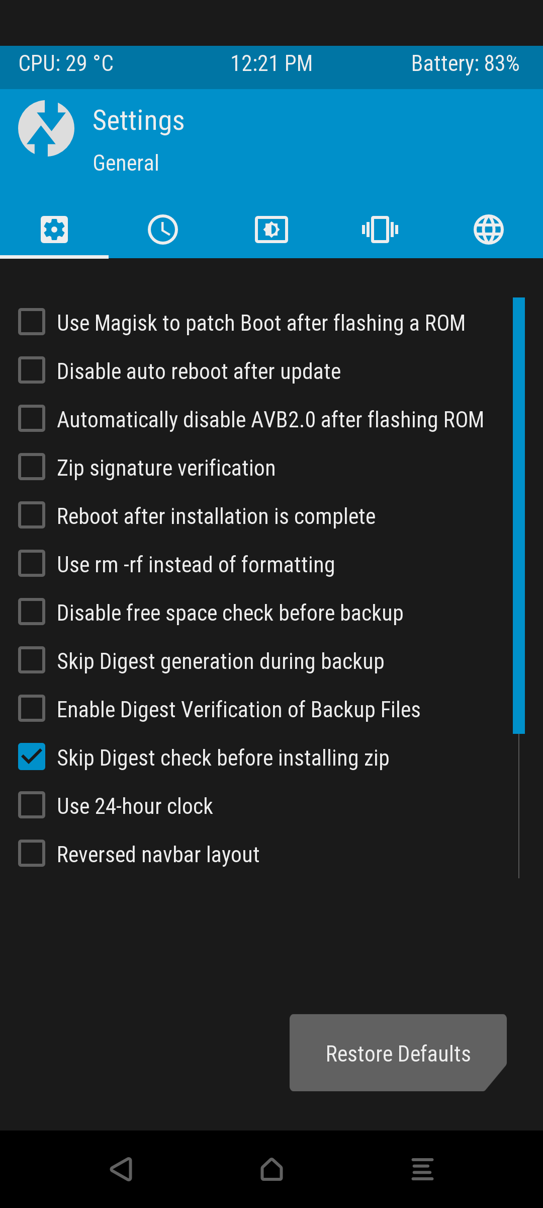

Try with these. It's what I use and don't have an issue. Different phone though, I have cas

Thanks for your input. Since I have a confirmed Issue Report for Poco F3 open for one month with none response I decided to open this thread to help everyone who like me wants automatic installation with reboot at the end.
My suggestion is to deselect the option "disable auto reboot after updated" since the MIUI.eu script should do the reboot when finished. If it doesn't work, also select the option "reboot after installation is complete".
EDITED: I CONFIRM that just deselecting the option "disable auto reboot after updated" fix this reboot issue when automatic installation.
