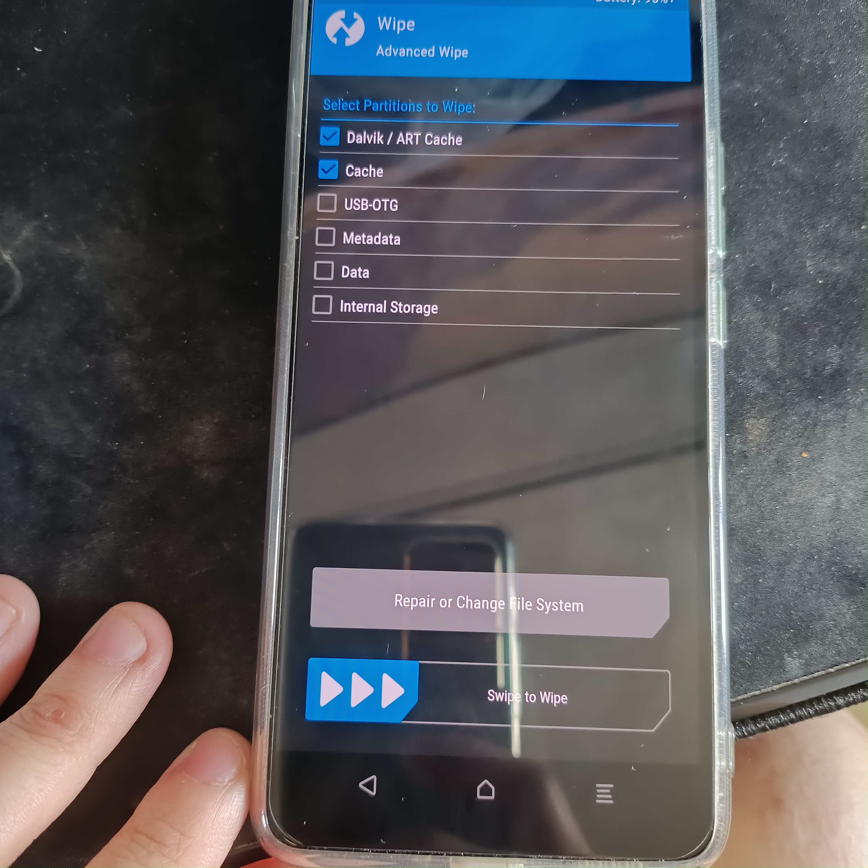

Then I saw somebody said you can try to clean the Dalvik/ART cache and cache before you reboot after flashed in Recovery, So I tried with that, and I got this situation: The WiFi is working, the SIM card working, Google crashed, Webview crashed and Xiaomi Account crashed, then I try to clean data of these apps and re-install the APP that getting force close such as WeChat. Right now every APP works well expected Google Pay.

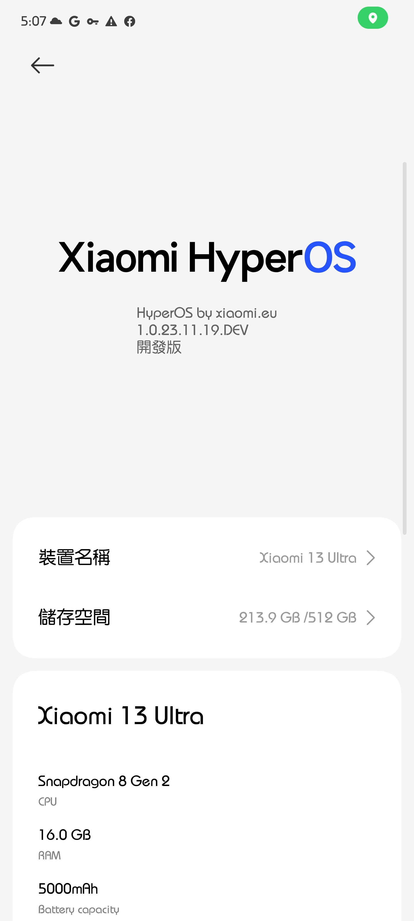

xiaomi 13 ultra Some apps crash after updating version 11.19. Whoo GPS app, grindr app, and Instagram cannot take pictures. Hope they can be updated soon.

Seeing some people commenting on clearing the Dalvik cache, I thought that I would give the installation another go. However, it would still not install with TWRP.
So, rebooting to system, and then after I cleared all the recents, Boosted the speed and used Cleaner, I went into TWRP, and cleared the cache and Dalvik. No error appeared, implying that they were both cleared. I had previously tried to go into Fastboot from TWRP, but that did not seem to work properly. So, I rebooted to system, but held down the Power + Volume Down to get into Fastboot.
I then installed (successfully) with Fastboot. When it came to the reboot at the end, I held down the Power + Volume Up to get back into TWRP. I again cleared the cache and Dalvik (to be absolutely sure!), and then did a system reboot. It took maybe a couple of minutes to boot up
So now it has been successfully installed (with Google Wallet / Pay working properly). I shall comment separately on my issues with this newer version.

Neither I can't accept cleaning all the data and then updating, so I tried all the way and finally found this one.
I do share how to solve it in the same theme before, flash 11.19dev in TWRP, then clean Davilk/ART cache and cache before you reboot, then after booting into the system, you will see Google、System Webview、Xiaomi Account、Chrome said stop working, just uninstall them and re-install and clean the data of Xiaomi Account APP, and re-install those APP that getting force closed without delete them (like cover them but keep data) then it should be work...
This is my experience but may not work for you.
I think about is better to share which part needs to be cleaned with the screenshot to avoid my express may have something wrong.
