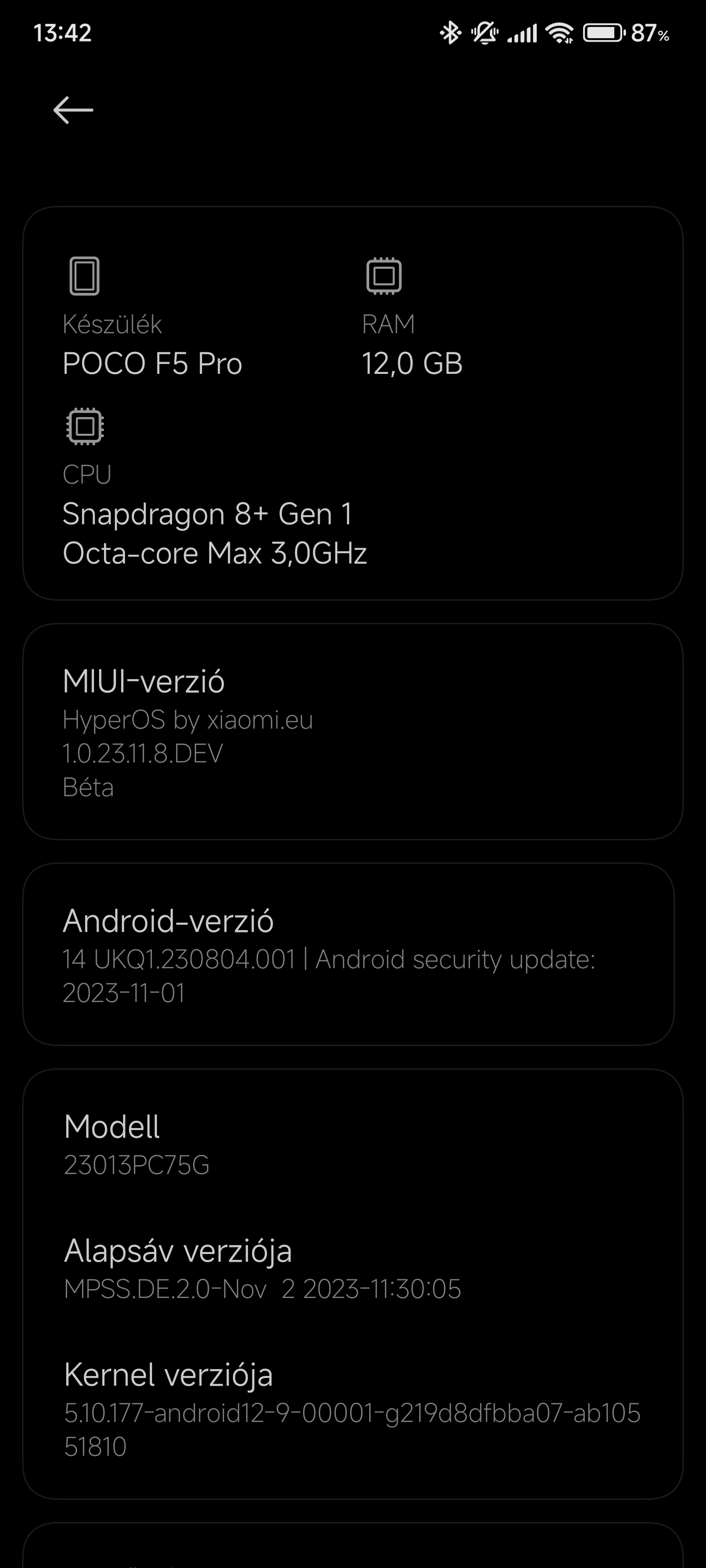

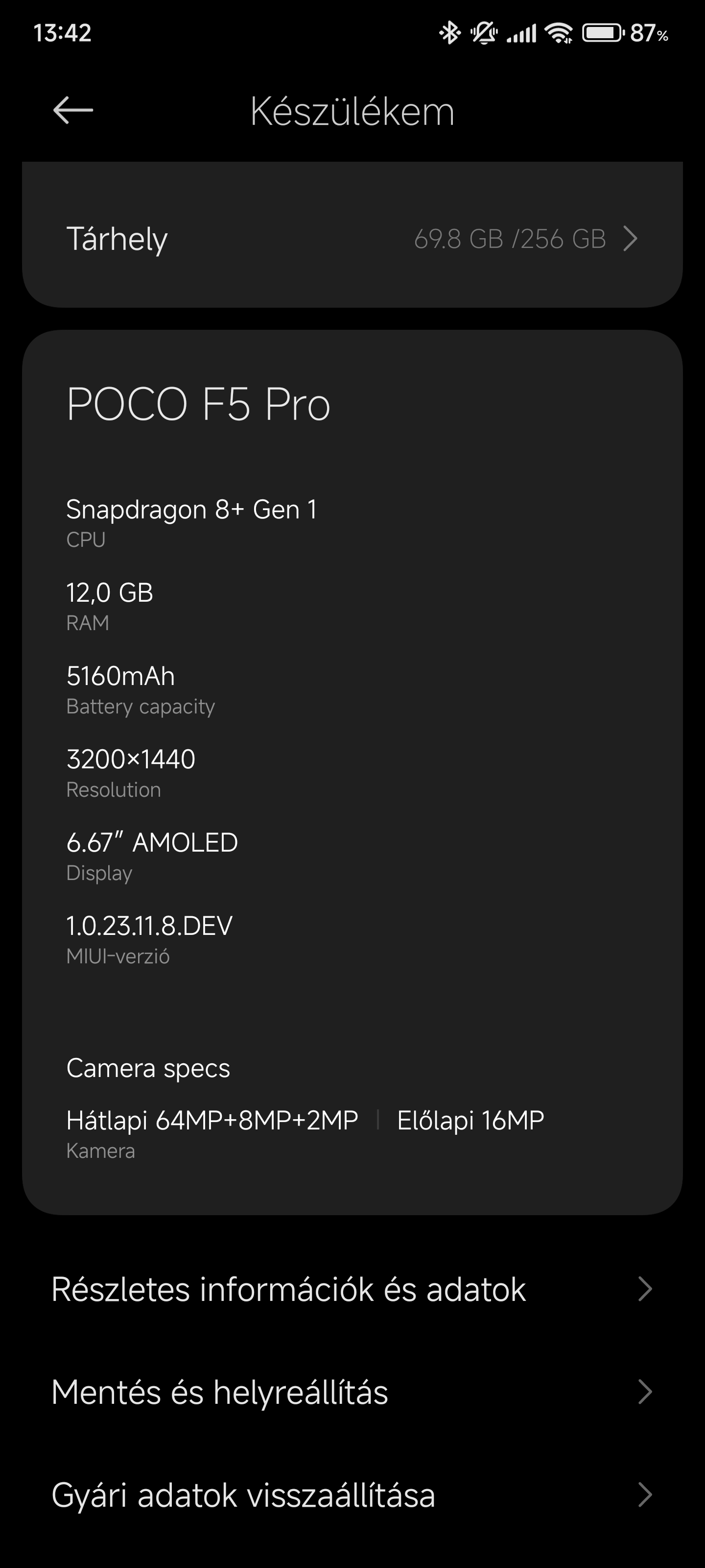

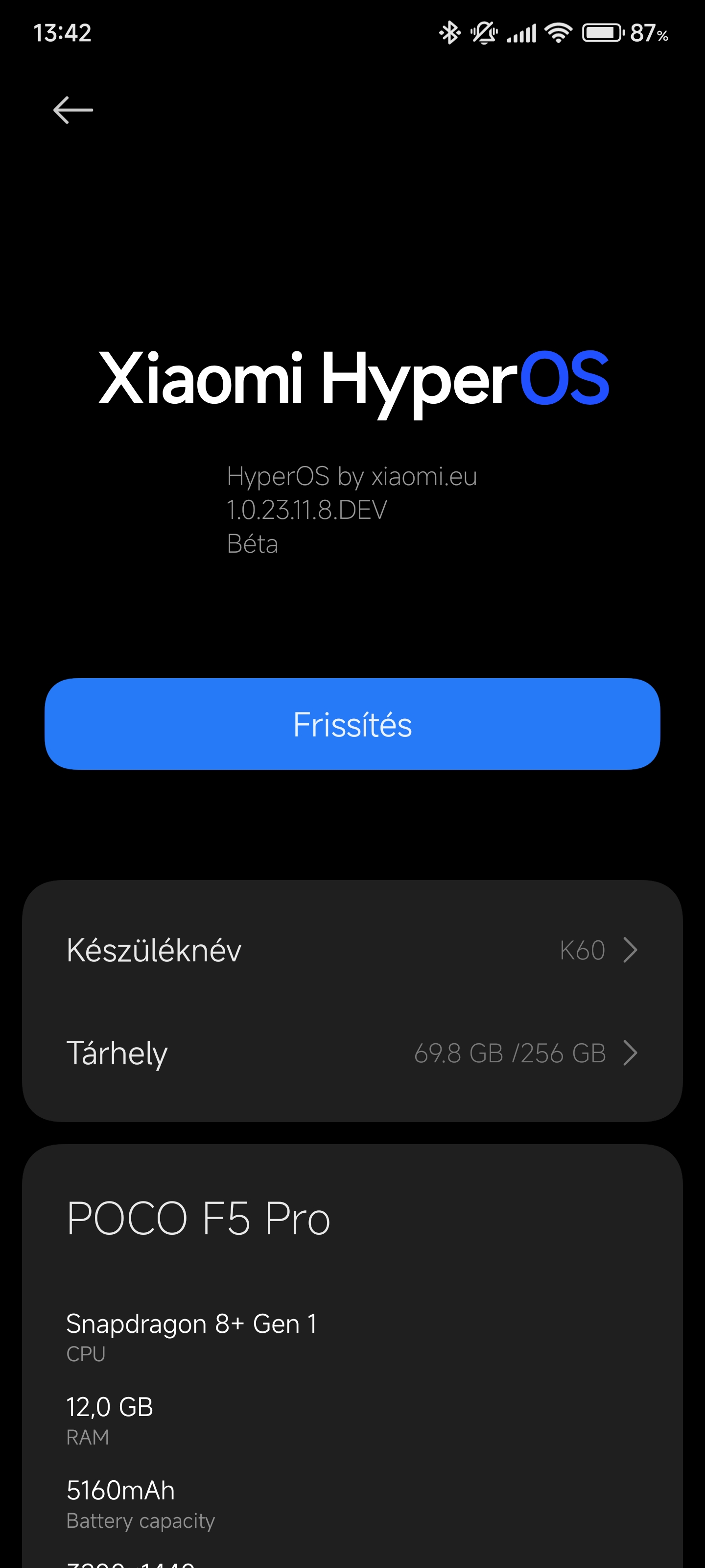

I confirm! Poco f5 pro, it works for me too! Last Stable xiaomi.eu v14.0.28.0 From ... via TWRP

Just dirty flashed form latest weekly on Fuxi, it works as expected, can't install KernelSU since I can't use twrp because of the encryption but that's not on Xiaomi.eu to fix
Security app stuck during verification. After deleting application data, everything is fine
Poco f5 pro is perfect, my data remained.

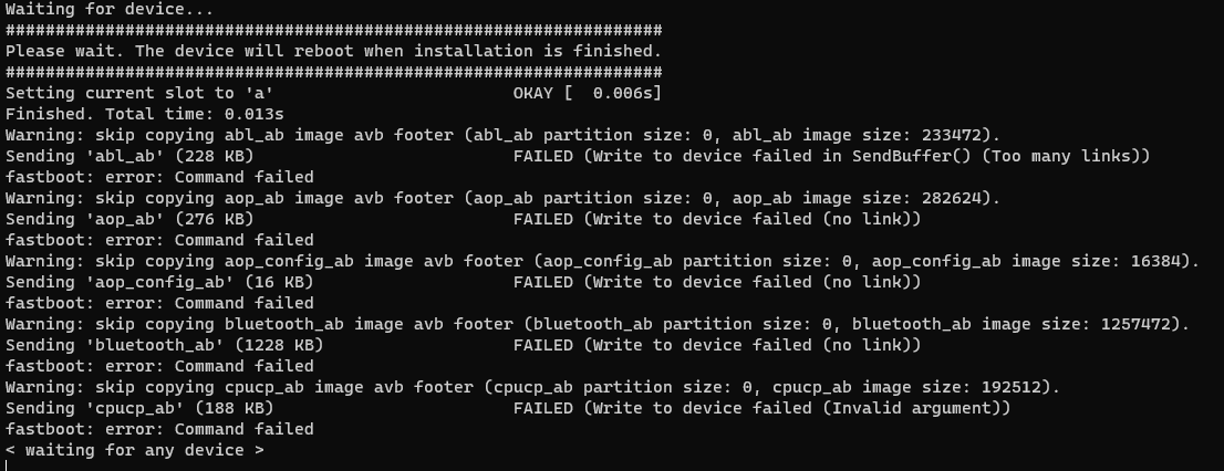

so I downloaded the rom for xiaomi 13 pro twice just in case
1. I ran windows_fastboot_update_rom.bat as administrator
2. everything went OKAY
after flashing the phone keeps rebooting, the Xiaomi HyperOS appears, it loads for a while, but then it reboots again into the xiaomi logo and it keeps rebooting over and over again for about 5 minutes. Is the rom ok?
It's OK, otherwise we would have a bunch of similar reports. Which ROM had you before?
the last weekly rom that came out for 13pro. Same thing over and over again and I tried reinstalling the rom. crashed into fastboot mode after 30 minutes
I am in the same situation as him. My phone is Xiaomi 13 Ultra. I upgraded from the last version of MIUI 14 EU to HyperOS but it keeps restarting and cannot successfully enter the system. I try to downgrade it back to the last version of MIUI 14 but it can boot. Please ask developers to solve this problem!
Try to make a log if possible.
