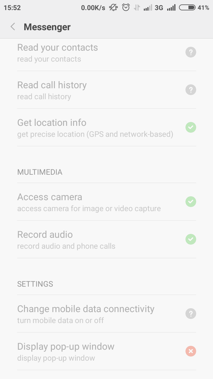

@ingbrzy: on redmi 1w I can't set any permission for any application. On mi2s I don't have this problem
