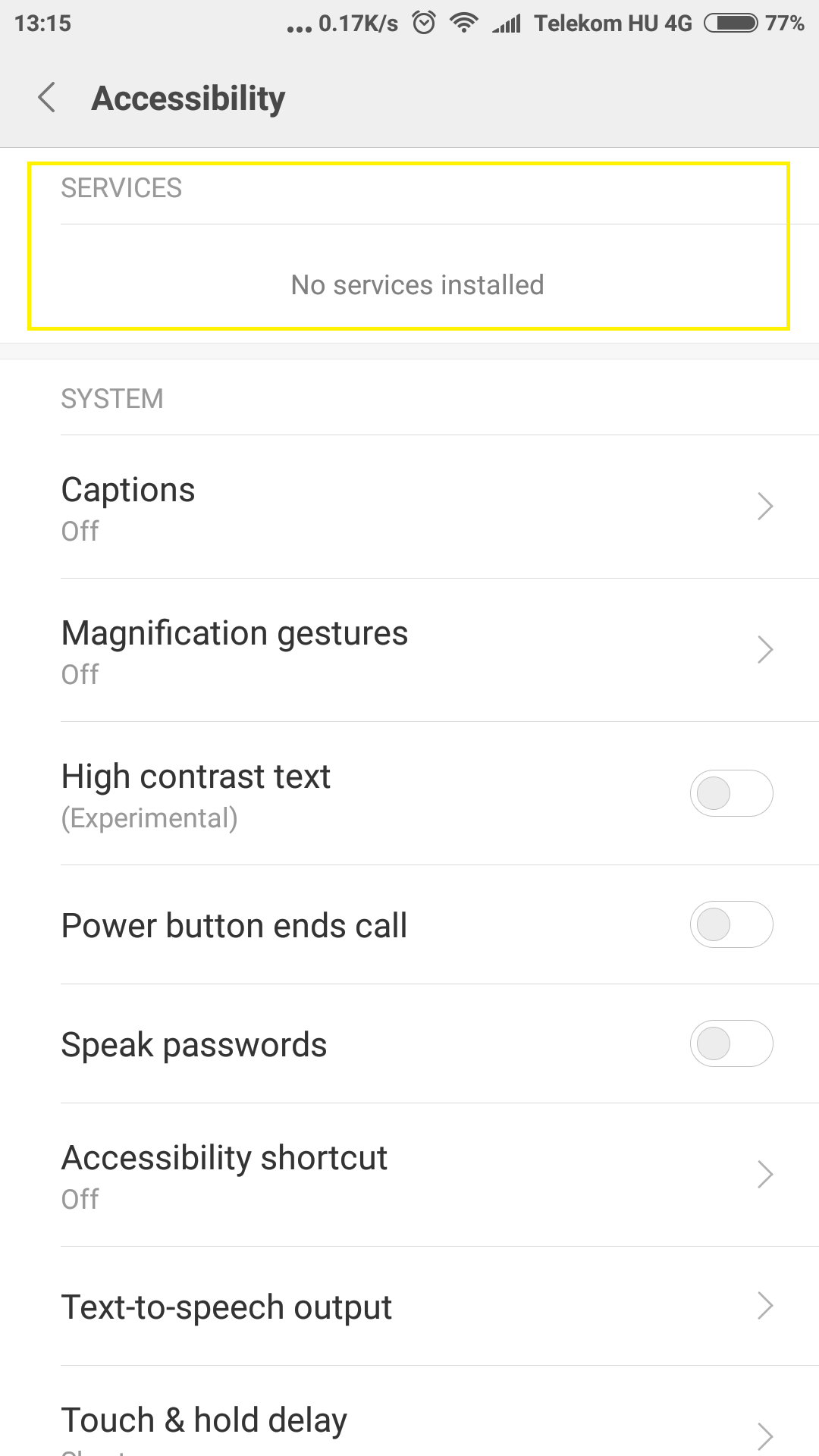

3. Settings > Additional settings > Accessibility: Disable Chinese assistant app service

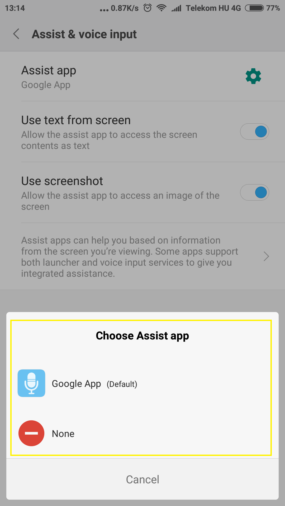

4. Settings > Installed Apps > Defaults > Assist & Voice input > Assist app: Choose "Google App" or "None" instead of Chinese assistant - This is the main point before remove PersonalAssistant.apk otherwise you will get bootloop!

1.
2.

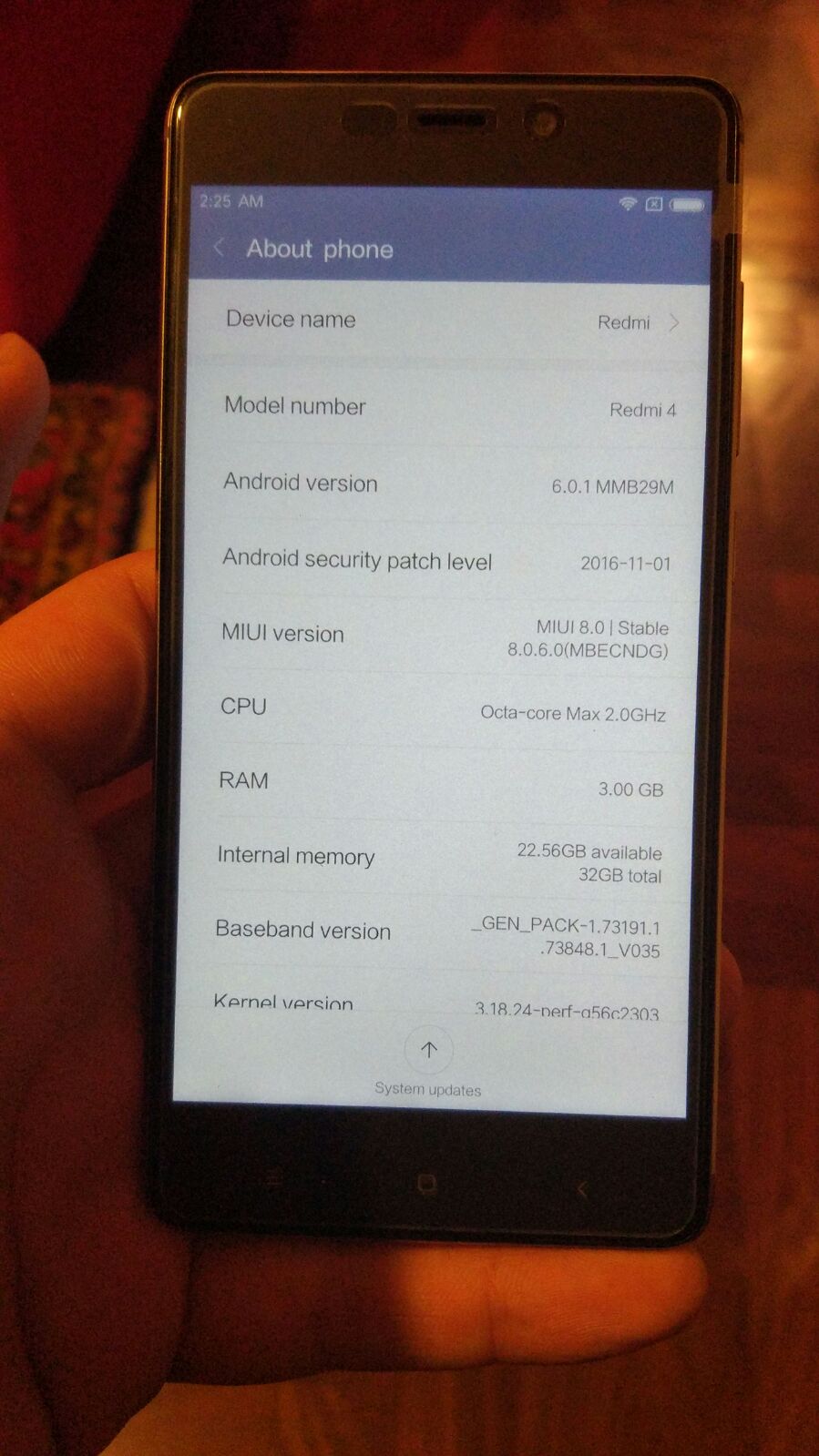

excuse me... i'm really confused now... my device isn't redmi4 pro? 3/32 gb ram rom, octacore 2.0 ghz... isn't this the redmi4 pro???

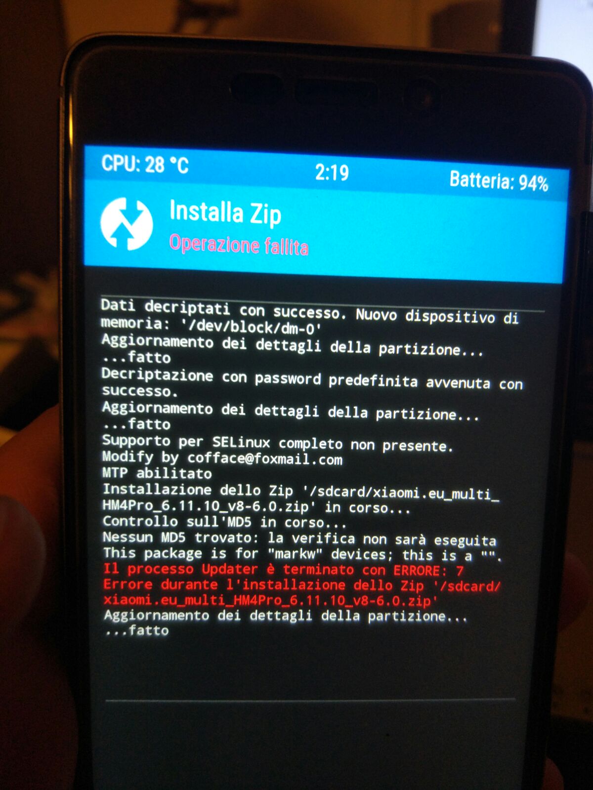

of course i did... unlock bootloader and installed the twrp... in the pther thread i posted the photos of my phone and twrp error... i try to post here too View attachment 14292 View attachment 14293
You're flashing the wrong package, that is for Redmi Note 4, your device is PRADA named just HM4
The recovery is telling you that you have a different device. Not me.
In fact after looking again at the endless list of Redmi's it seems it's the right one for your device.
It looks like you recovery does not recognize your device as a Redmi 4 Pro (codename MARKW)

The recovery is blocking you because it's not recognizing your device as a MARKW.
If you try to flash a different device signature the recovery just gave error.
As you can see in your picture it clearly says that the .zip file is for "markw" your device is " " so I am pretty sure that you have downloaded the correct rom, but the problem is in the recovery.

Simple, your recovery is not recognizing your phone.
You probably flashed in the correct way the recovery but something is definitely wrong. Download again TWRP from link in the first post and flash it again via fastboot, then try again.

there is some problem with REDMI4 PRO's TWRP
after install it when i try to flash any rom twrp give me error

i did... solved finally. there is a problem isnide the files in the rom, a with help of Daniele Benati on a fb group i did it
i write what to do in any other people need it
Download the last xiaomi.eu rom (6.11.17)
open the zip file with winrar
META INF->COM->GOOGLE->ANDROID
using exclusively the blocknotes open the file UPDATER SCRIPT
delete on the first string:
getprop("ro.product.device") == "markw" || getprop("ro.build.product") == "markw" || abort("This package is for \"markw\" devices; this is a \"" + getprop("ro.product.device") + "\".");
until the first string start with:
ui_print("Tar etc etc etc
save the file and put the modified file in the device and use it to flash the rom with recovery
