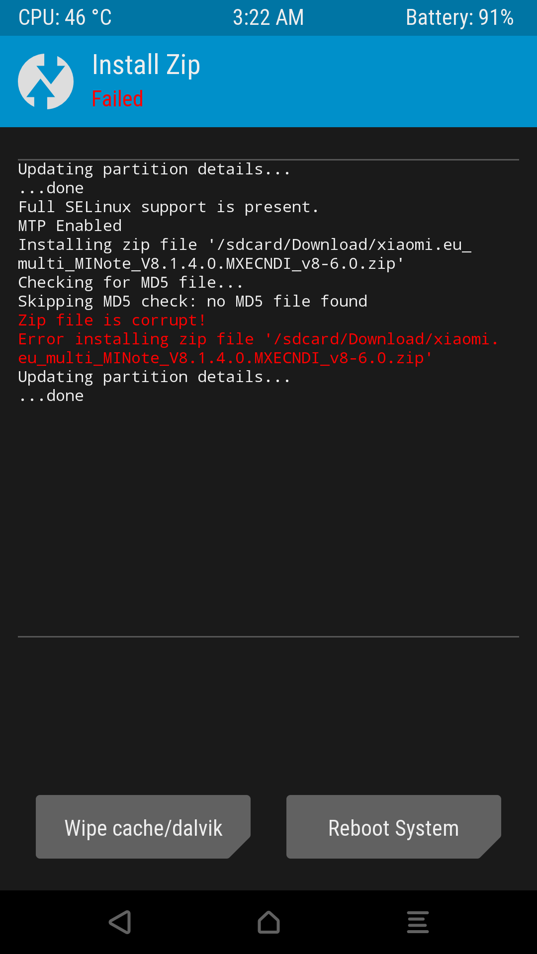

Try to update my mi note to 8.1.4.0 and .....

Try downloading again..check md5
