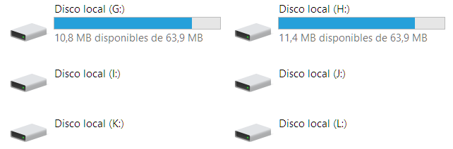

Well, I installed the ROM (cancro) via TWRP 3.0 and now my phone doesn't work.
When I was installing the ROM, the error mount : failed to mount /dev/block/platform/ msm_sdcc . 1/ was given, but after a short time (5 minutes +-) the installation finished and I restarted the phone... but the problem is that the phone didn't start.
I have tried to hold pressed the power button 20s, but it doesn't start (it doesn't even turn the notification led on when charging, so I suppose it's a brick [it doesn't load neither recovery or fastboot]).
If someone knows if I can do something I will be very greatful.
P.S. When I connect the phone to the PC, some devices appear on as file storing devices.

My problem is that I can't do ANYTHING (no recovery, no fastboot, nothing).
