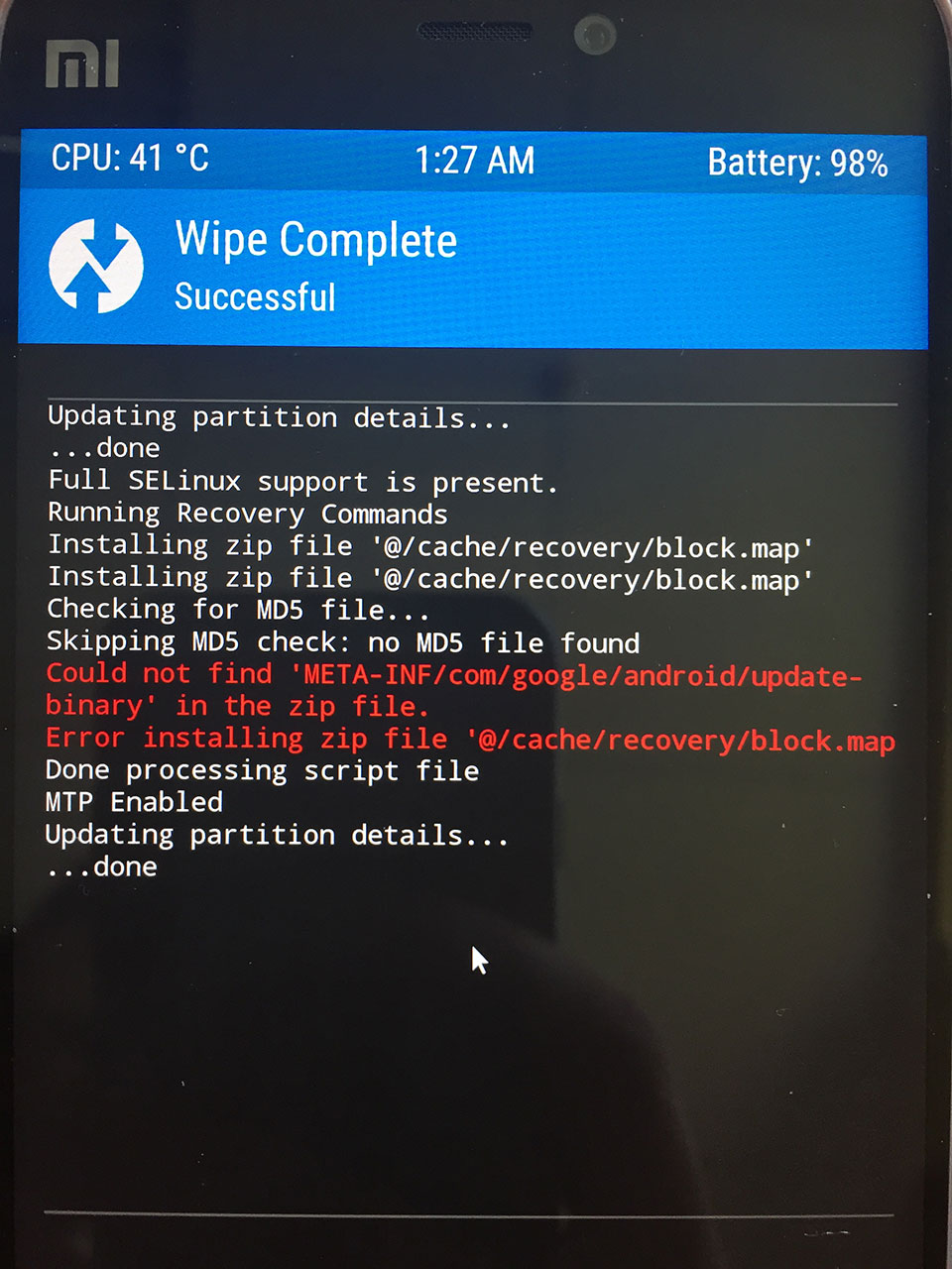

Hi!
I'm trying to update my Mi5 from 6.4.21 to 6.5.7 via the TWRP, but each time there is an error message "Could not find meta-inf/com/google/android ...", but the flashing is finishing and the updated MIUI is launching.
What's going on wrong during the flashing process? What should I do to update the ROM without this error message?
Can anyone let me know the correct updating procedure from Xiaomi.eu 6.4.21 to Xiaomi.eu 6.5.7?
I'm trying to do the steps listed below:
1. Opening TWRP_gemini_6.5.7+.zip unsing the Updated app. After that my Mi5 rebooted to TWRP mode.
2. In TWRP mode I'm choosing Install option, choosing xiaomi.eu_multi_gemini_6.5.7_v7-6.0.zip.
3. During the update there is an error message marked by red color: «Could not find meta-inf/com/google/android ...»
What's wrong with the updating procedure?
Maybe I should wipe cash or something else to avoid this error message?

That means, downloaded zip is wrong.. Download again..

Hmm, I downloaded TWRP_gemini_6.5.7+.zip and xiaomi.eu_multi_gemini_6.5.7_v7-6.0.zip, checked the md5, everything was fine, but then I saw the same error message even during the Wipe process :(

You dont have to install TWRP zip in TWRP..
