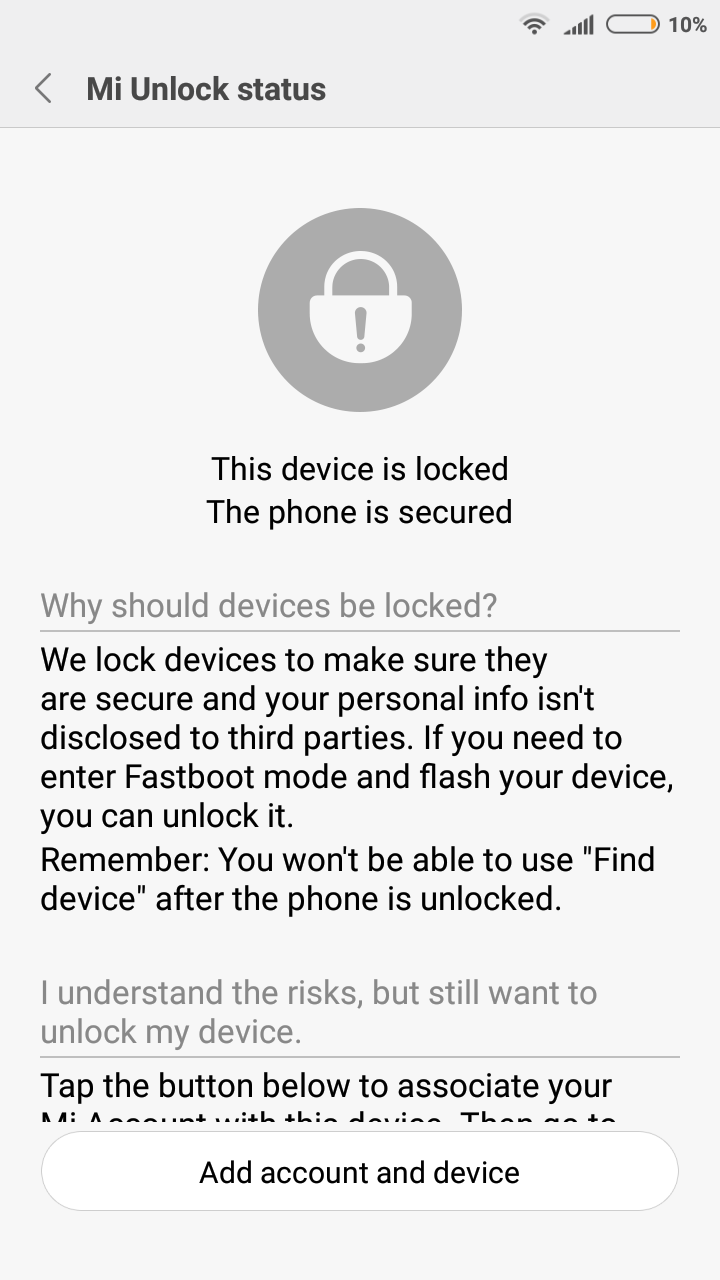

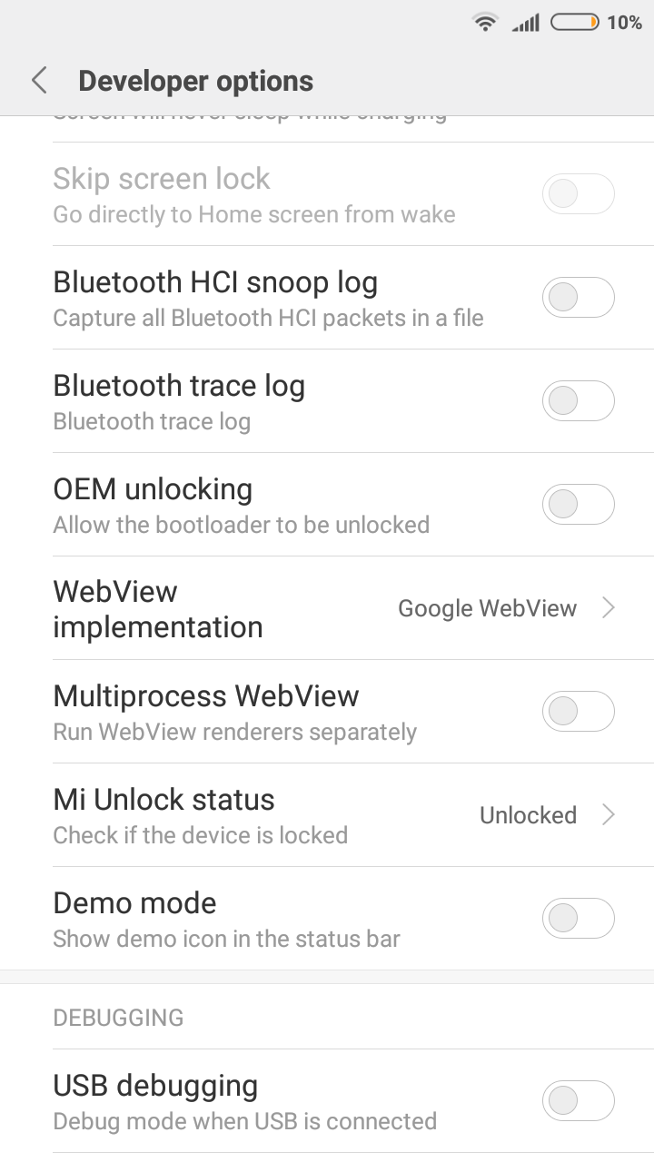

Same here, interestingly, the Mi Unlock Status said 'unlocked' but entering the ststus menu it said 'locked'.
Updated: My Redmi Note 3 Kenzo on 7.10.26 also having the same behavior, Mi Unlock Status said Unlocked, but entering the status menu, it said locked.
Anyone tried boot to fastboot and check?
Update : checked using 'fastboot oem device-info', result Unlocked
Same here. I'm confused. Is it a bug?

I also have bootloader locked despite on the previous menu appears as unlocked
I'm going back to 7.10.26
