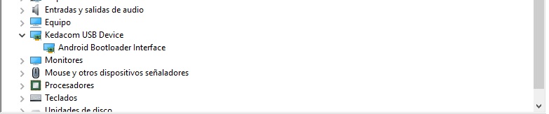

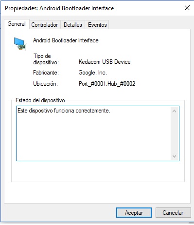

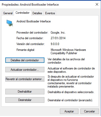

Please help!! I´m still trying to unlock mi4c bootloader but it´s locked now.
I uninstalled the device from the control panel and deactivated the option of automatic drivers to be able to install version 9 of the driver.
The current situation is as follows:
What can i do?. thanks in advance
View attachment 15442 View attachment 15442 View attachment 15443 View attachment 15444
Delete kedakom driver. Install google drivers for Android bootloader interface. Install adb and fastboot driver.

i try to do that but when I delete kedacom driver, windows 10 installed it in on its own. How can I do that?

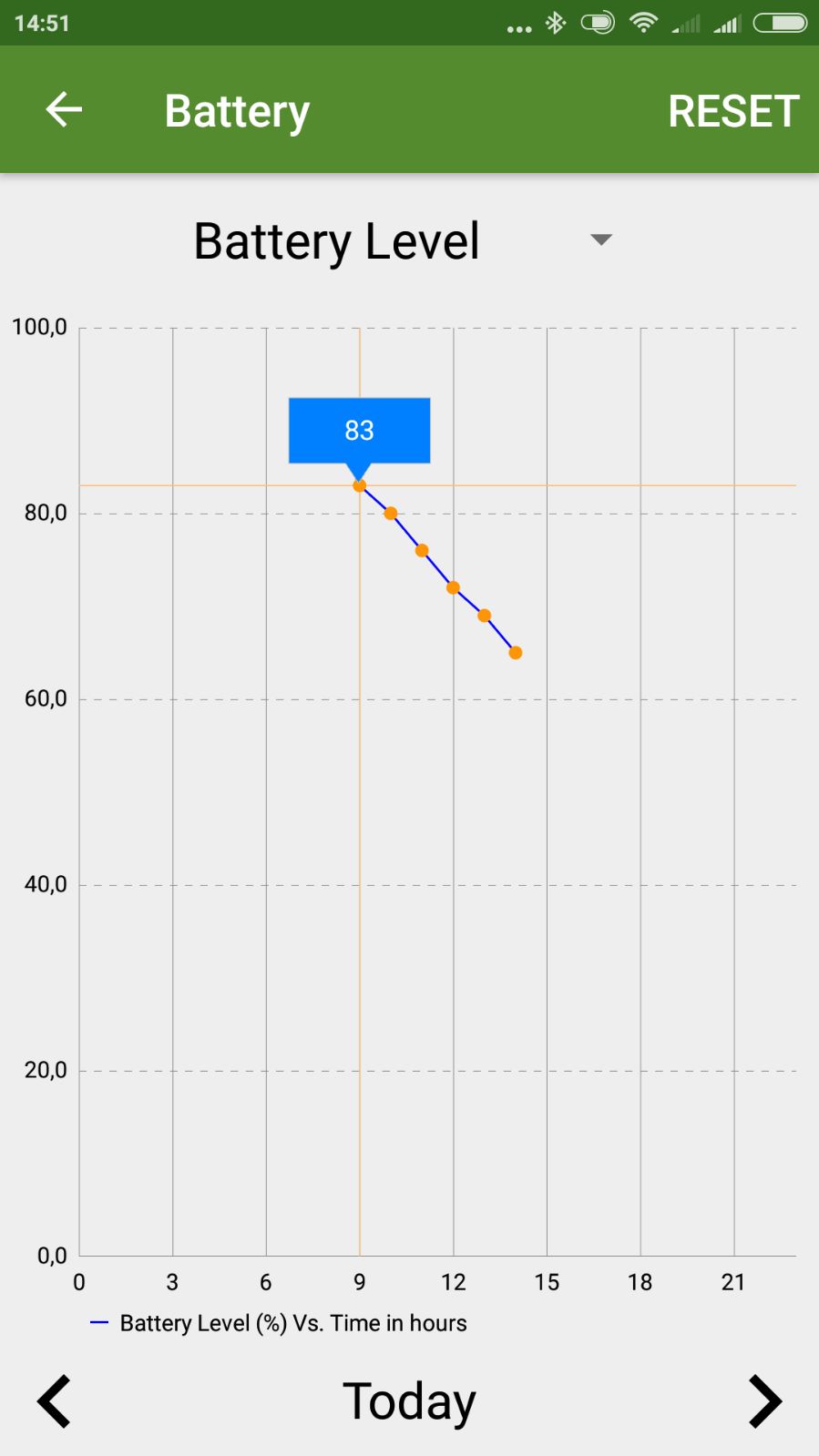

Hi all,
I've installed two weeks ago the 7.2.23 package on my MI4c, right now quite satisfied of this new release in term of battery life.
I do not play games and music, main usage is calls, social network, chat and web. It's seems to me that this new release is in line with the previous, no main issues found till now (crossing the fingers...).
Cesare
