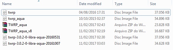

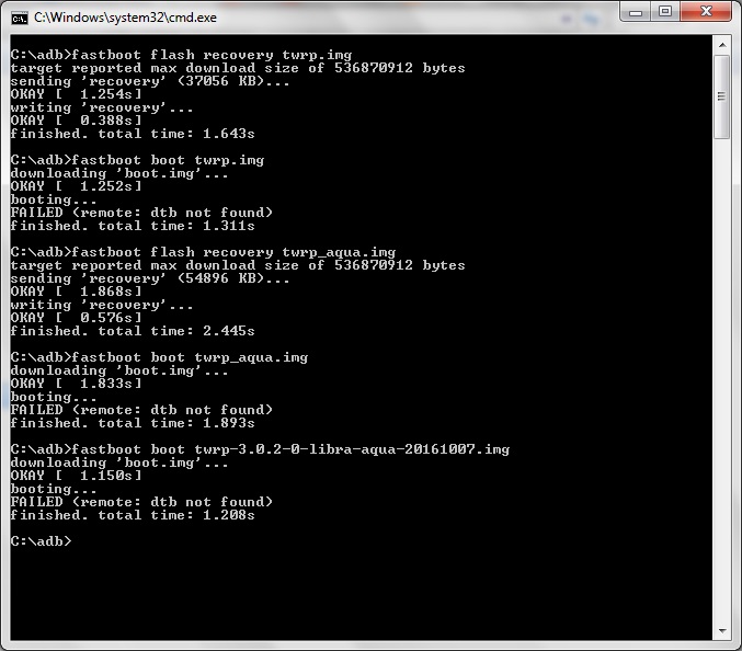

I installed ROM 7.2.9 on my Mi 4S, but my bootloader re-locked and lost my TWRP.
I was able to unlock the bootloader, but after installing twrp, it does not start and it is stuck in the MI logo.
I tried to boot but the dtb error.
Can someone help me?
Exactly the same problem with my Mi-4c
