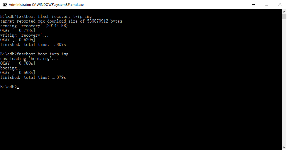

The recovery must be updated after you flashed in new Android 7 ROM.
If you flash it before the upgrade to nougat then it not Work.
You just download the related recovery for your device
Enter to FastBoot mode by pressing Power & Volume DOWN button
Flash the recovery using command fastboot flash recovery {name of recovery.img}
For ex. fastboot flash recovery twrp.img
Then reboot to new recovery using command fastboot boot twrp.img (example)

The recoverie must be updated after you flashed in new Android 7 ROM.
Enter to FastBoot mode by pressing Power & Volume UP button
Flash the recovery using command fastboot flash recovery {name of recoverie.img}
I did exactly as you said and it says "finished" "okay" in adb but when i press volume up+power it just shows "MI" for some time then turn off, any suggestions?
I enabled usb debugging and canceled oem lock.
Sorry for my mistake.
You can enter to fastboot mode by keep pressing at Power & Volume DOWN Button. (Not Volume UP as noted before).
The guide corrected.

I know that my friend, it's after installing in fastboot when i try to enter recovery i have this problem...
Try to enter in Recovery from Miui Updater app (Reboot in Recovery Mode).
When you press the Power & Volume UP button, when the Mi Logo apears you must release to Power Button without release the Volume Up Button.
If you keep pressing for Long Time the Power & Volume UP buttons together, maybe you will force the Device to make Reboot prior entering in recovery.
