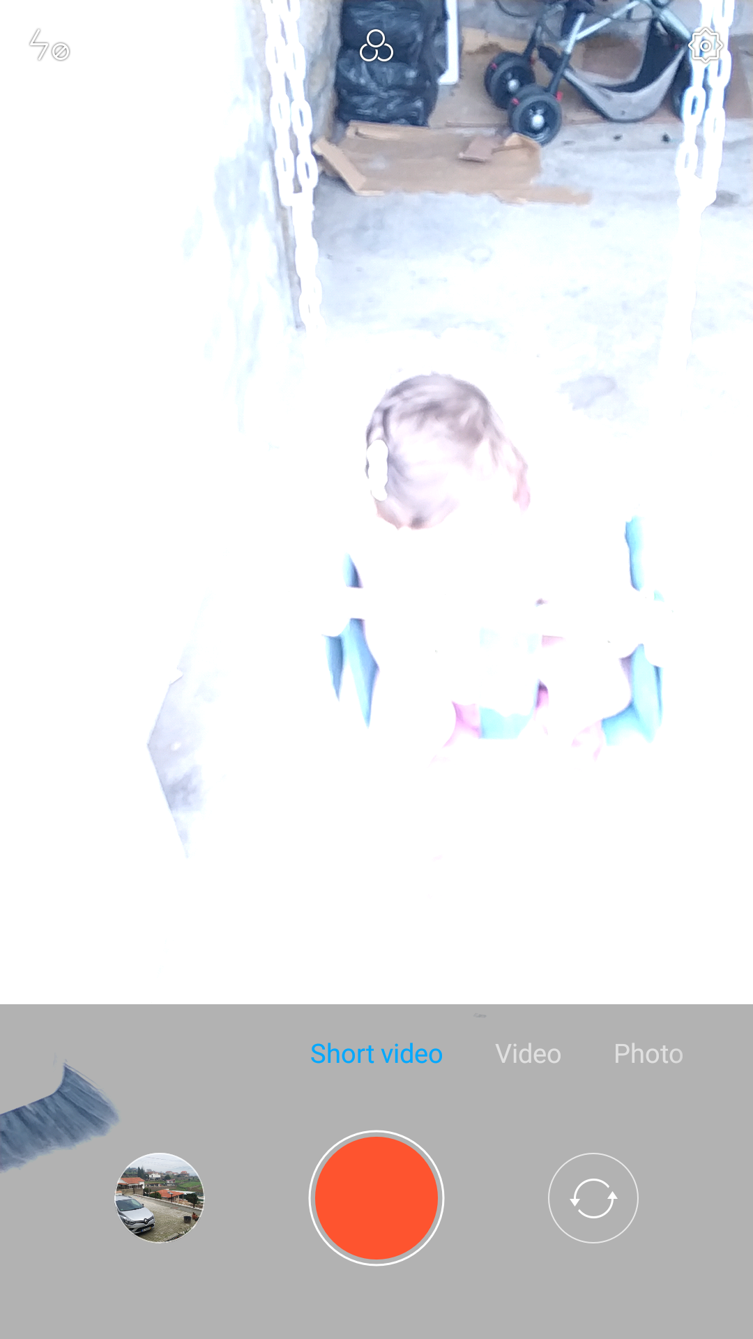

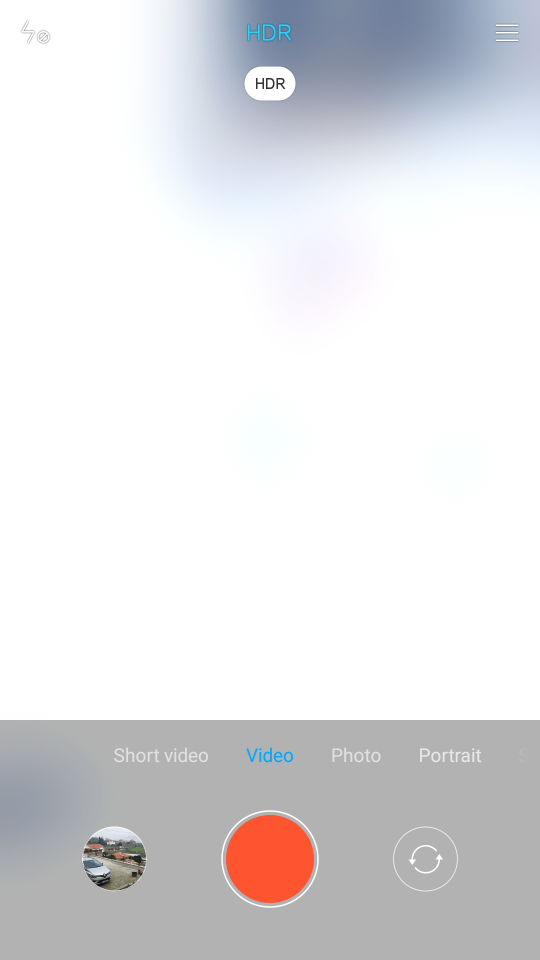

Camera is bugged when select video in my mi6.
It's ok in photo.
