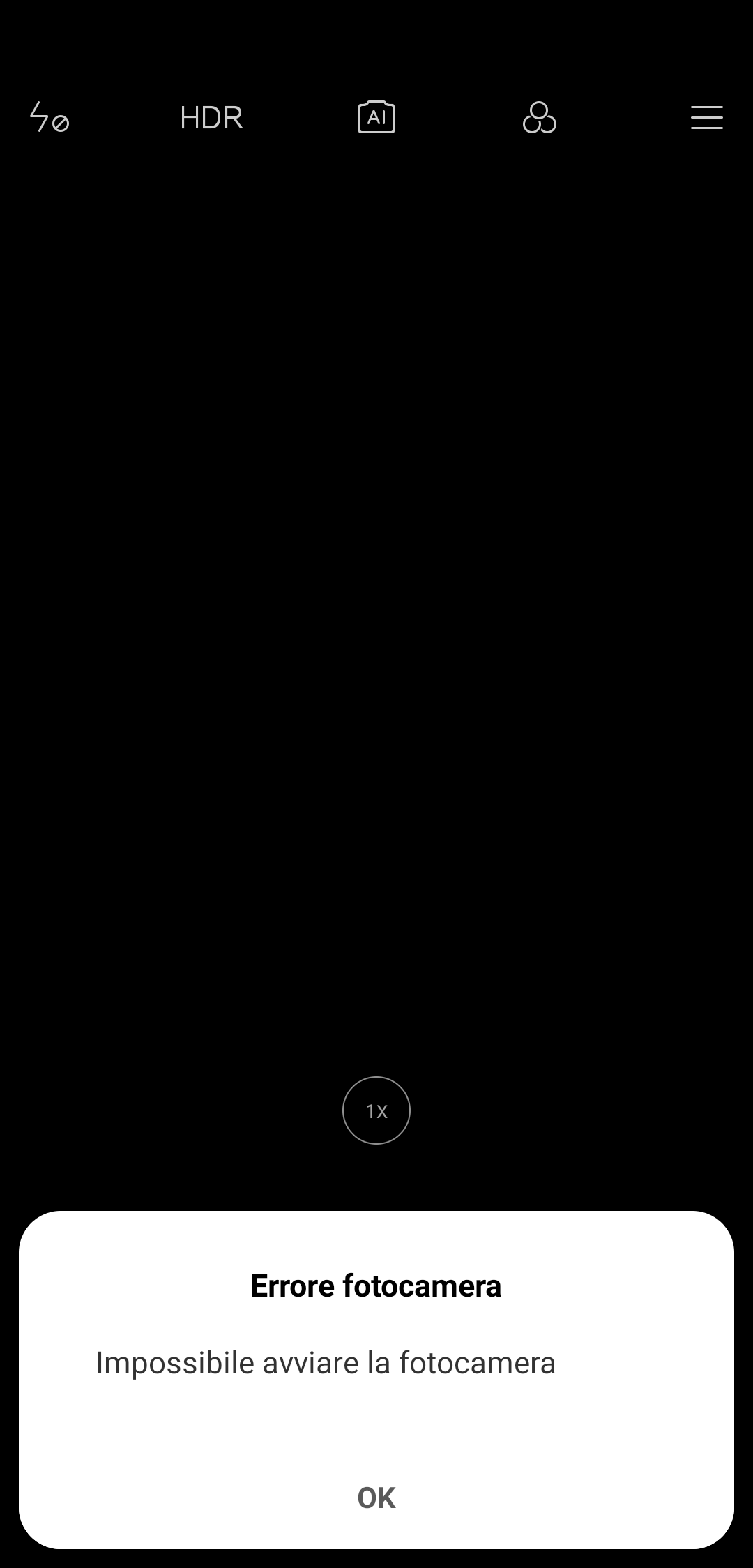

Mi 6X , cannot connect to the camera .
I wiped data, system, internal, everything, still can't get it working
At first, I thought the rom was okay but til I open camera and then... BOOM! I have a same issue, but I'm downgrading to 8.9.20 now.

Camera does not work, why?
I'm waiting for an answer
