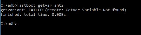

Hello
Can someone with Mi8 run this fastboot getvar anti ???
With this way we can see if the device has Antirollback
Hello
I don't know if is the correct output when the antirollback is disabled
