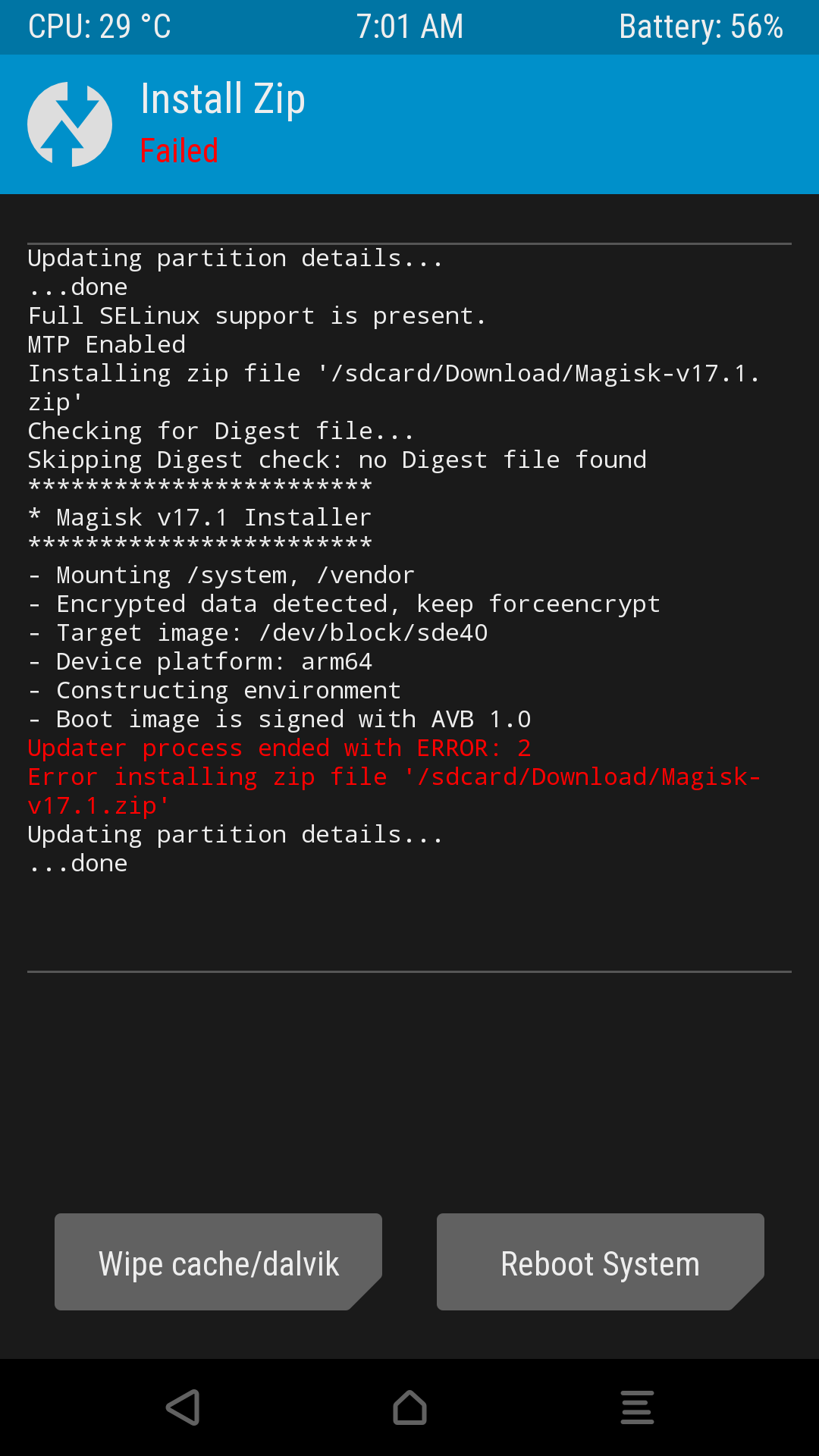

I can't root this ROM for mi6. I'm using latest twrp and I tried full wipe. But always it's the same. How can I fix this?
