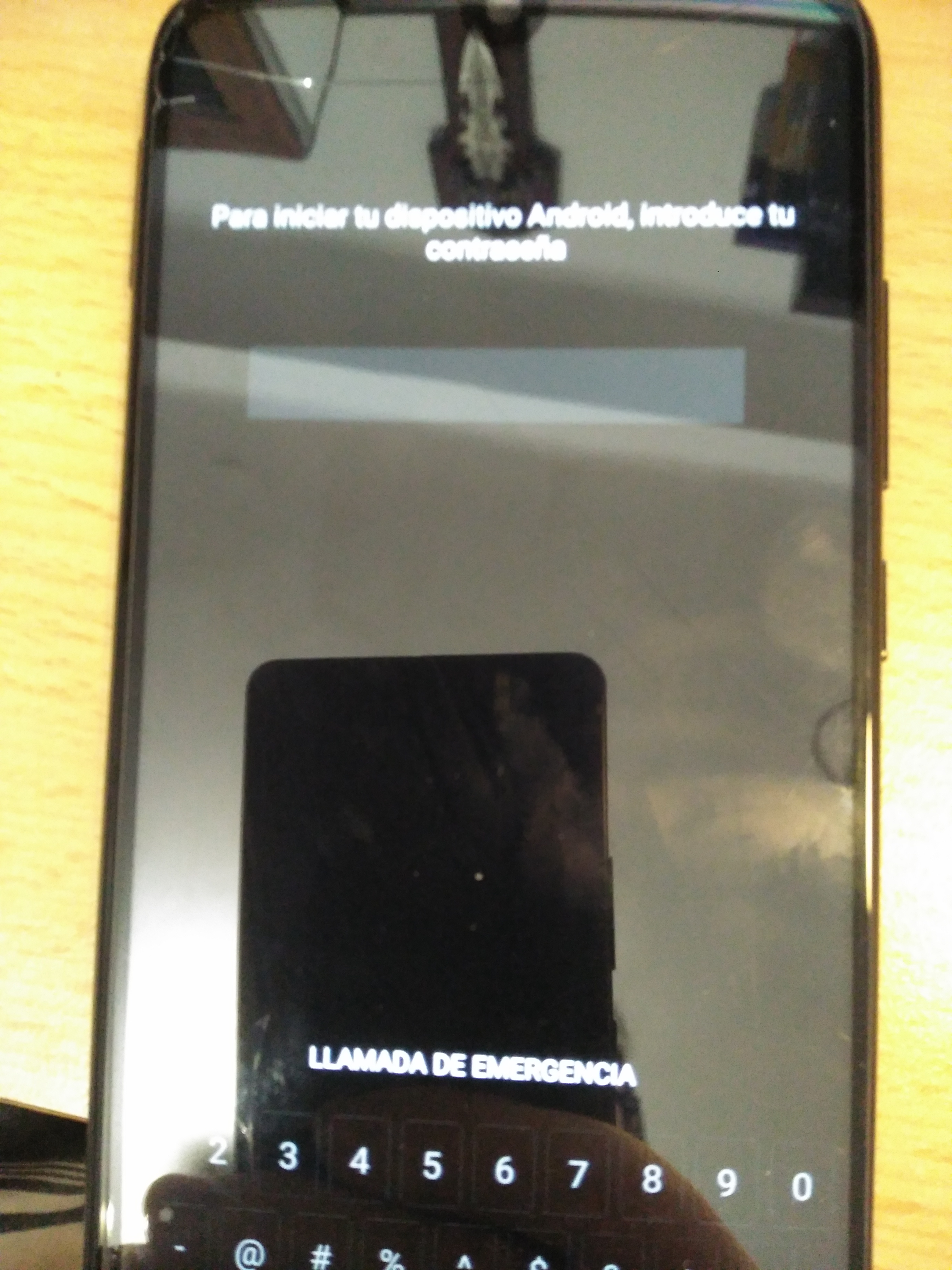

I have a big problem with my Note 7. I have been using this rom for a few months now without problems, but I installed the latest ota 9.12.12 update and it has encrypted the data partition. I only use pattern and fingerprint to unlock the phone. Now I can't get into the phone and I can't recover my files, photos, etc.
Please, can you help me? Can i recover my files?

Yes you can go to twrp if on start page get a message allow enter in twrp and connect to pc

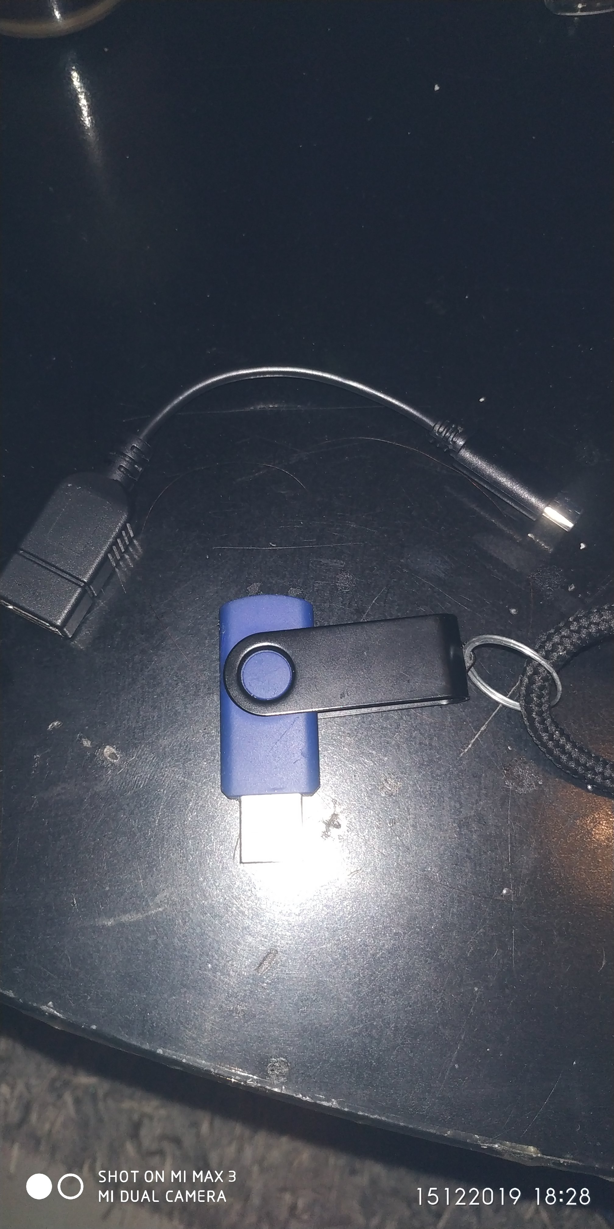

You have a usb and a cable for it?
What twrp you have the normal?
Don't worry
You need this

If you have them download from PC latest orange fox twrp for lavender
Put it in the USB connect the USB when you are in twrp select on storage the USB flash this recovery and will reboot in 5s in fox. Then press allow the modification or something like that then connect to pc or copy your files to usb if it's big enough

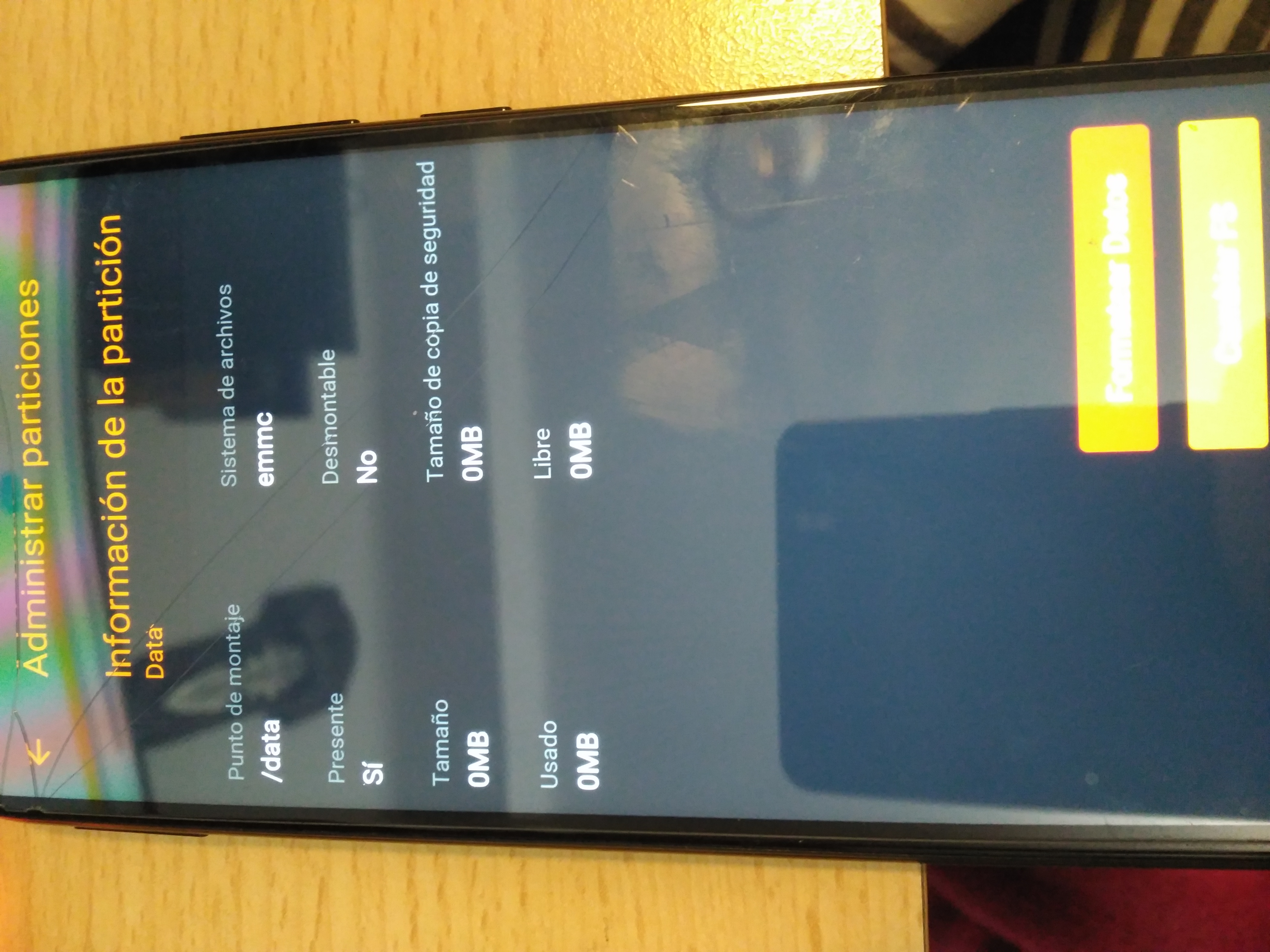

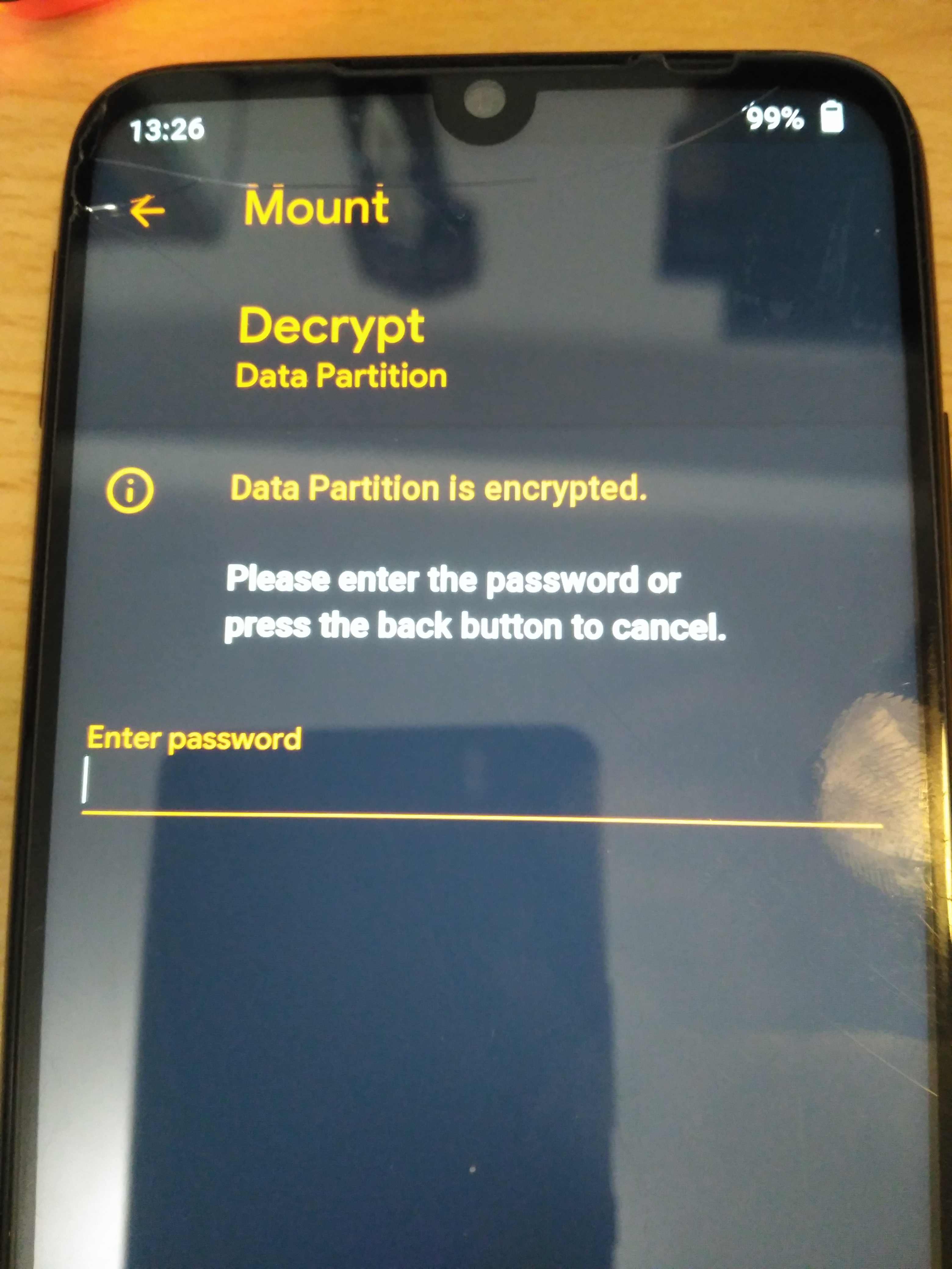

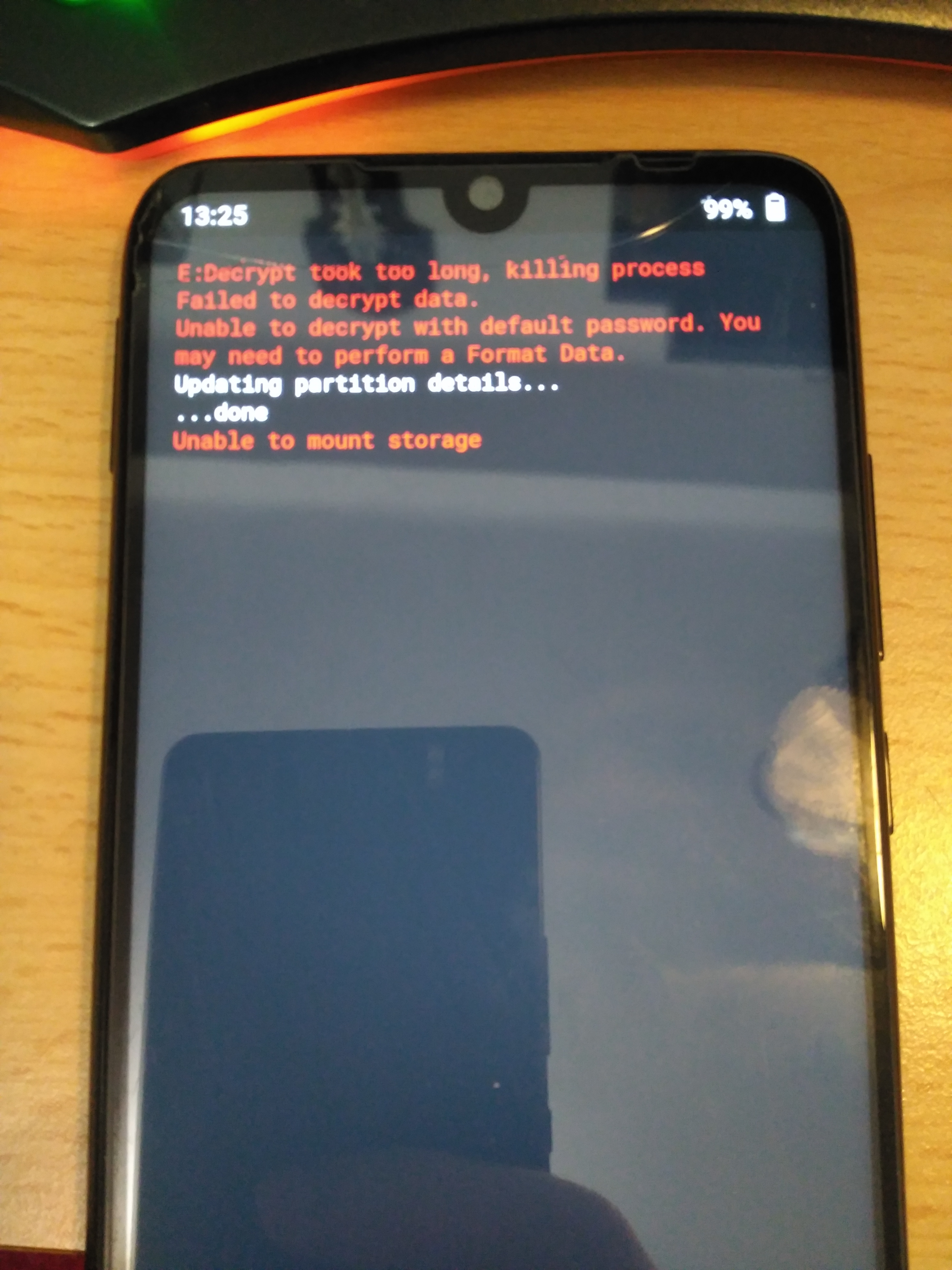

Yes, i have a usb and a cable for testing. I can only mount the sd card. I had the normal twrp, but I have been recommended orangefox. I installed orangefox and I have the same problem. Thank you very much.

When you open first time the fox it didn't say swipe to allow or something like that?
It ask only the password? Wait to search.
